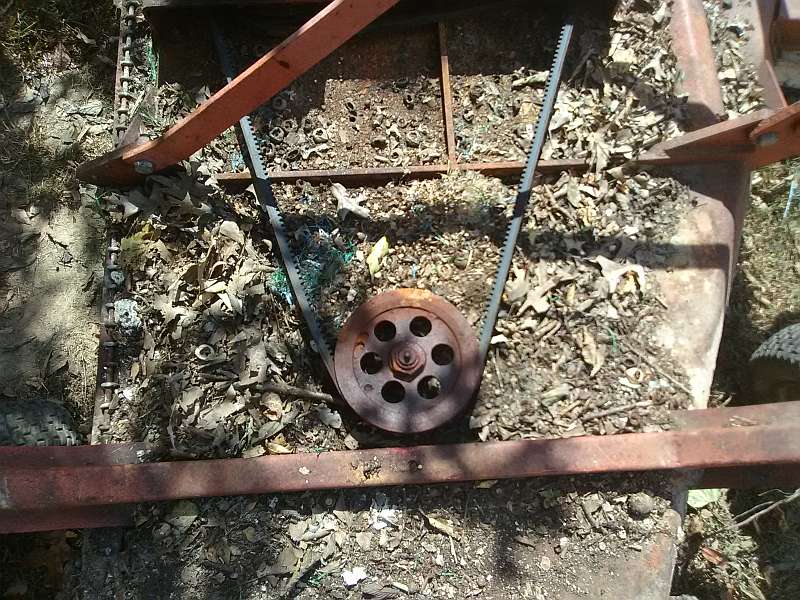

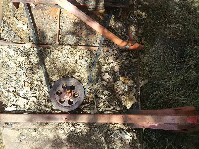

#13
Got hooked up to the red deck sufficiently to move it to my yard for inspection. NO WAY I'll try to run this on my machine though.
Took the belt covers off and it looks like I evicted somebody, or a few somebodies. Packed almost solid with nut shells, shredded cloths, leaves and grass. Belts are rusted to the pulleys, but not chewed or otherwise damaged. Everything is frozen solid, nothing rotates at this point. Once I get the belts freed up I can go to work on the pulleys, spindles and gear box to see where I am.

#14
Red beast is freed up. Took some ooomph, some disassembly and lots of Blaster, but all three spindles and the gearbox now rotate easily. I can hand pull one of the belts and everything rotates as it should including the PTO input stub. It's still a mess and will need to be washed and degreased. Not sure I'm going to get into stripping and painting though. Might spot wire brush and paint the loose rust areas.
