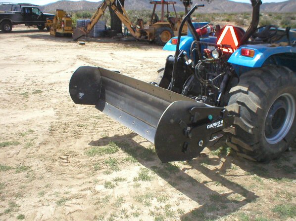

The HD versions are typically used in construction for spreading material.The inside blade is fixed for digging. The back outside blade swings to help smooth out the material being spread. When you back up, the outside blade acts like a fixed blade when it swings in and rests against the inside blade. The digging is accomplished with the inside blade when you are pulling forward. The hinged blade helps with a smoother finish

I have the Gannon construction grade BB listed by Woods. It will meet any expectations but at a higher cost. I think I paid around $3K for mine a few years back. The Gannon blade has been around awhile and you might be able to find a used one. Although it is one of those "until death do we part" kind of attachments...Gary

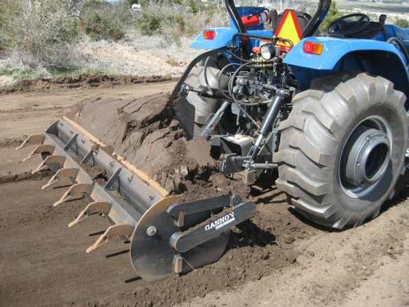

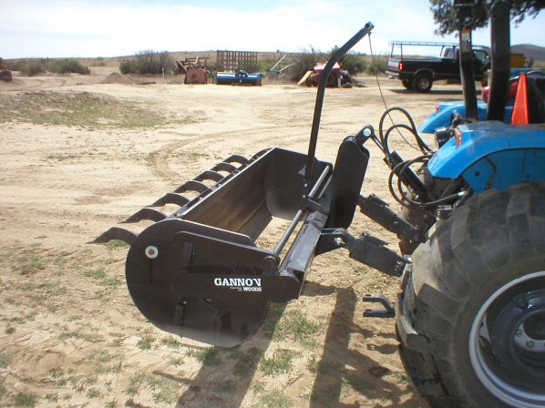

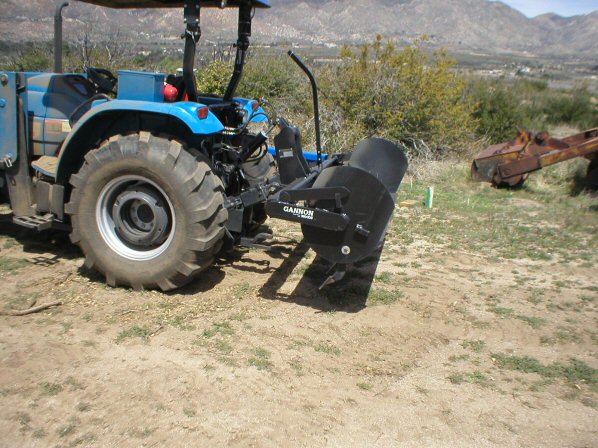

Piston, stick to your thoughts about a 1000lb box blade, you won't be sorry. You can keep an eye out for a roll-over box blade like what I have also.

Second that I got aused 66" 700lb Roll-over for mine little more flexibility than a regular BB
Look at Modern Ag Equipment ( Dividion of Dragon Manufacturing in Beaumont, TX)
I just priced a 7' contractor series with hydraulic scarifier for $2300.
The 7' weighs 1011 lbs.
I'm not sure if they have a distributor that far north

I would stick with a heavy duty model in the 6' to 7' width. I would strongly recommend top and tilt hitch and hydraulic scarifiers too. Since construction is slow you may want to look around at rental yards to see if they have some used ones available at a cost savings. Compare these to new ones before you buy.
I have a Frontier BB1284 which is a rebadged Gannon 7' wide I bought new in 2005 that weighs 1250 lbs, very satisfied with it.
