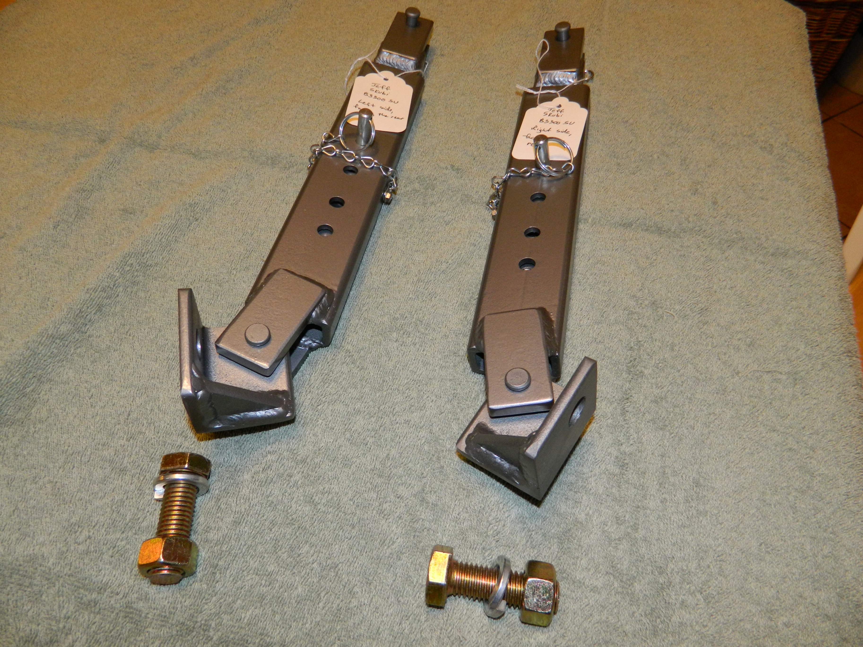

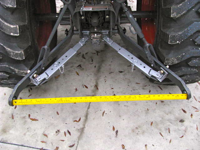

Yes, I'm using sway chains. It did not start out getting in my tires. I found the pins that attach the sway chains to the frame were bent and stretched.
I had the eye bolt attachments for my 4.4 pound Kubota factory check chains bend too. I replaced factory check chains with aftermarket, rigid, pin-adjustable rigid stabilizers from Stabilworks / 14 pounds / <$200. Problem solved.
It is MUCH easier to mount implements on the three-point-hitch with Stabilworks.
Use the T-B-N search function, keyword: Stabilworks for reviews.
Kubota tractor stabilizers Kubota [url]www.stabilworks.com - YouTube[/url]

Don't think those will work for my 750. Not worth some modification.
