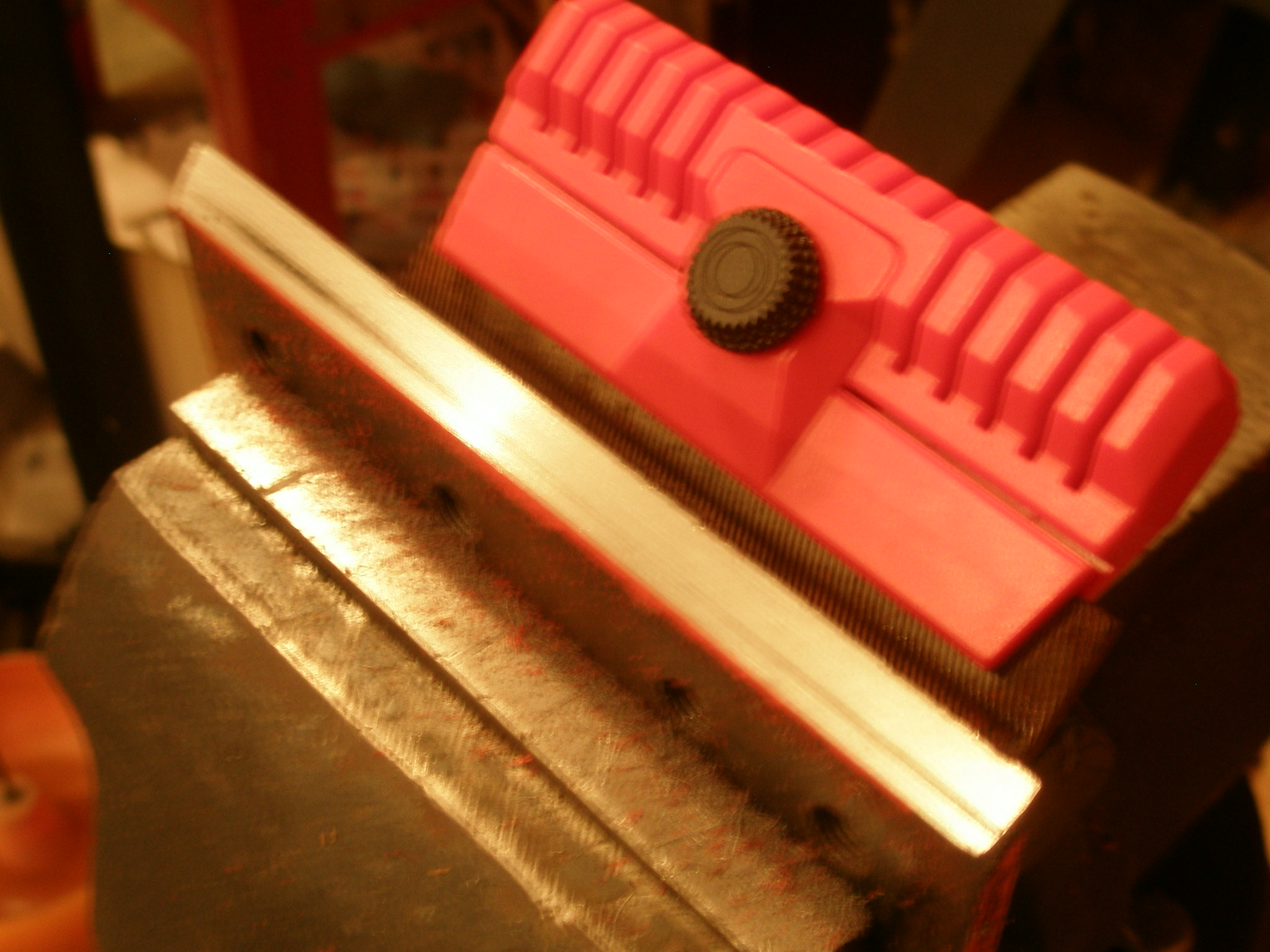

How do you sharpen your Blades?
   / Recommend (or UN-recommend) a specific 3pt wood chipper #33
Oh Boy. sharpening the blades. The first time I got the blades off I was looking at a variety of files, angle grinder and bench grinder. But I found a ski edger (see picture). For sharp 90 degree edges. First I run it along the beveled edge of the chipper blade and I get and keep a nice flat and straight surface. Then I do the flat back edge, just for small burrs. I clamp it in a vise of course and since I am just following the machined angle and keeping that nice and straight I don't worry about finding the right angle to grind at. I sharpen after about 3 or 4 hours of use. If that beveled edge gets rounded over by not doing regular sharpening I can see this method might not work, but so far so good. As you can see the edger plastic runs along the cutting edge so it doesn't grind that away it just files on the beveled surface. Won't work on mower blades. I wouldn't go out and buy a ski edger for this but if you have one laying around give it a try as I am thinking of making a jig to hold the cutter and then I can file level.

I sharpen my blades after about 20-30 hours. I just use my half speed grinder and set the grinder rest to the correct angle. Then I I'll freehand it on the rest. Keep some water nearby so that you don't lose the temper in the blades.
I generally use an impact wrench to loosen the bolts, but I have a completely different chipper.

Here is my sharpening setup. The ski edger works with a pull towards you action. I think the finished edge is like factory sharp and straight. I like how sharp I get the blade and it does not take long to hand sharpen. good luck.
