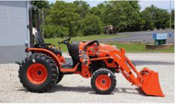

My recommendation would be a 30hp - 40-hp hydrostatic. I would add Kioti to the list. I'd take a look at these models first. The Kubota LX3310 is a small frame CUT with bigger tires. All the rest are mid frame CUTs. If you want to move up to 40hp+ large frame CUTs, you will pay more $$$, but have more capability.
Kubota LX3310
Kubota L3302 or L2902
John Deere 3032e
