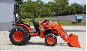

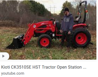

My recommendation would be a 30hp - 40-hp hydrostatic. I would add Kioti to the list. I'd take a look at these models first. The Kubota LX3310 is a small frame CUT with bigger tires. All the rest are mid frame CUTs. If you want to move up to 40hp+ large frame CUTs, you will pay more $$$, but have more capability.
Kubota LX3310

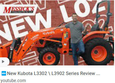

Kubota L3302 or L2902

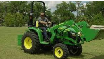

John Deere 3032e

Around here for "homeowner" tractors, Kubota and Deere seem to be big, but I think Yanmar may be making headway. Check out Messicks youtube reviews, and visit as many dealers as possible. If you're going to buy used, buy from a dealer who will back it up. Good luck!

I can still get nearly every part from Kioti for my 21 year old DK 35 also.
I order online and they are at my door in a few days.
Just as easy to get parts for as my previous John Deere 850 while I owned it IMO.
