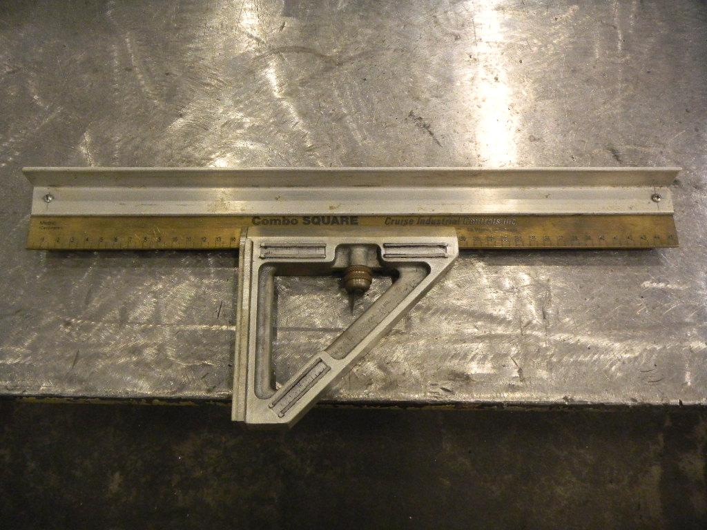

/ recommendation for budget oriented entry level Plasma cutter? #16
This is what I use to cut straight.
