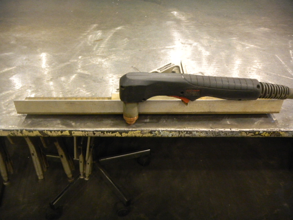

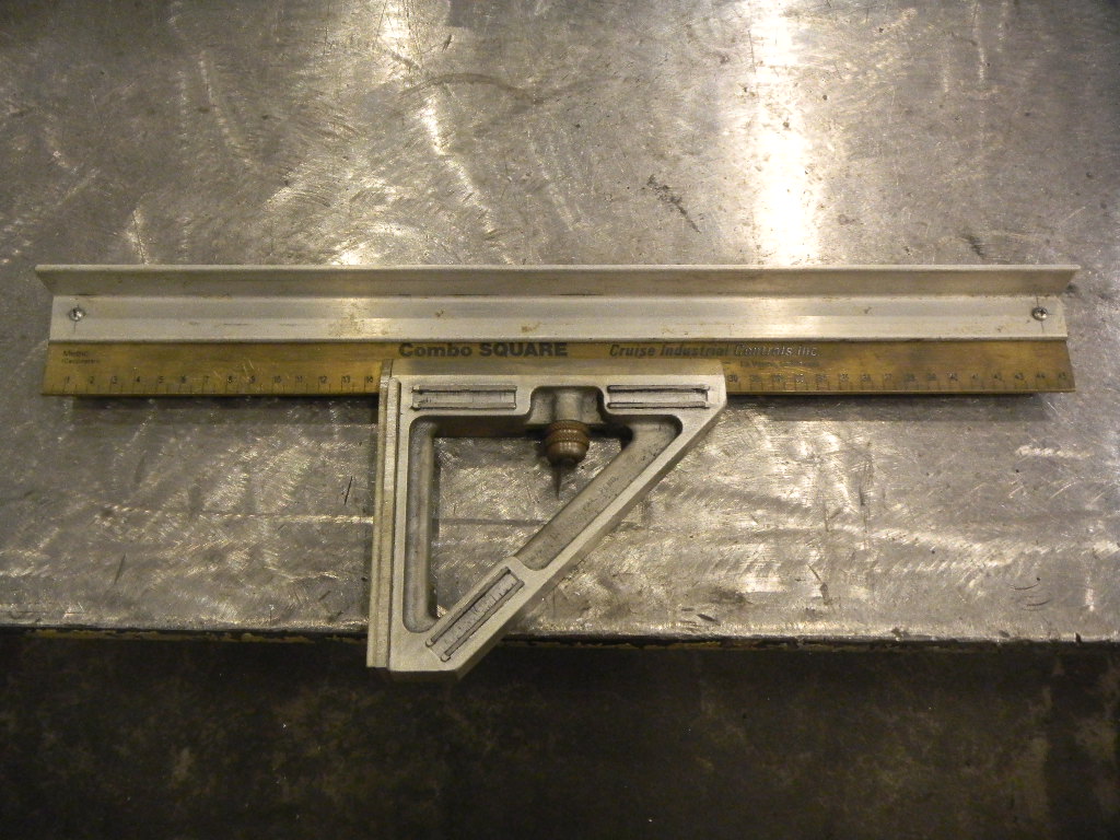

I've been having fun doing some cutting. I did some 1/2" scrap; it was pretty rusty, I had to grind a spot clean for the ground clamp. It cut it but I would expect better results on clean steel.
With advice from here, I tried using a straight edge on some 1/8" angle; those cuts came out nice. Looking online I found roller guides, angle guides, circle guides etc.
