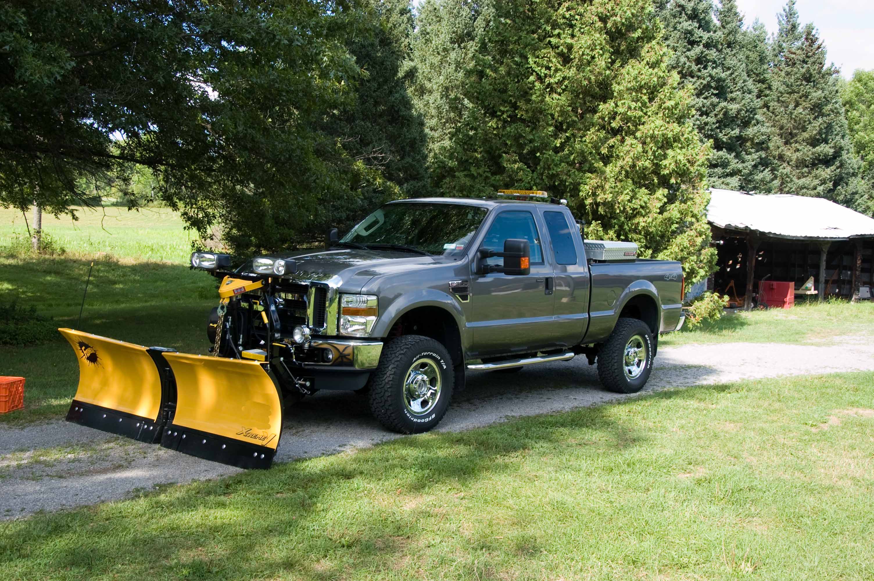

First off there's no doubt that a narrow tire will perform better in snow and there's no question that a dedicated snow tire being of a softer compound will grab the ice better, however when you load the truck up with the plow and a counterbalance in the rear a wider tire won't make that much of a difference I'm running 305-65-18 BFGoodrich T K O stock size was 275-70-18 never experienced a problem with plowing the truck goes through anything just picked up a new extreme V can't wait to use it this winter. As someone mentioned earlier I don't think it's as important with the truck loaded as it is for car the narrow tire issue. Many years with a 9 foot straight blade never an issue mostly commercial lots, plus I leave the tires on year-round no hassle of jacking the truck up to change out tires :) take care

I didn't take your comment wrong I was simply putting out my thoughts on plowing and what I found to be the most cost-effective means of making a living with it. To be honest with you I've never found a diesel that has ever impressed me with gas mileage with the price of diesel fuel my brothers two trucks 7.3 and 6.4 are anything but fuel-efficient ;-) not saying a 5.4 does any better especially during heavy storms, but nearly $.80 difference per gallon it adds up through the winter whether he's plowing or driving the truck back to the shop and don't forget adding in the fuel supplement for the pollution control system which it burns through when plowing heavy I've often thought there's something wrong with his truck to use that much DEF? As far as weight goes you're right the super duties do a great job with their sheer weight not to mention a transfer tank 65 gallons fuel adds to the overall weight of the vehicle on top of the 1200 pounds plow take a guess what that truck weighs that's in the picture I've went through scales you won't believe it when I tell you :) by the way I listen to everybody it's the only way you can learn even at my age take care
