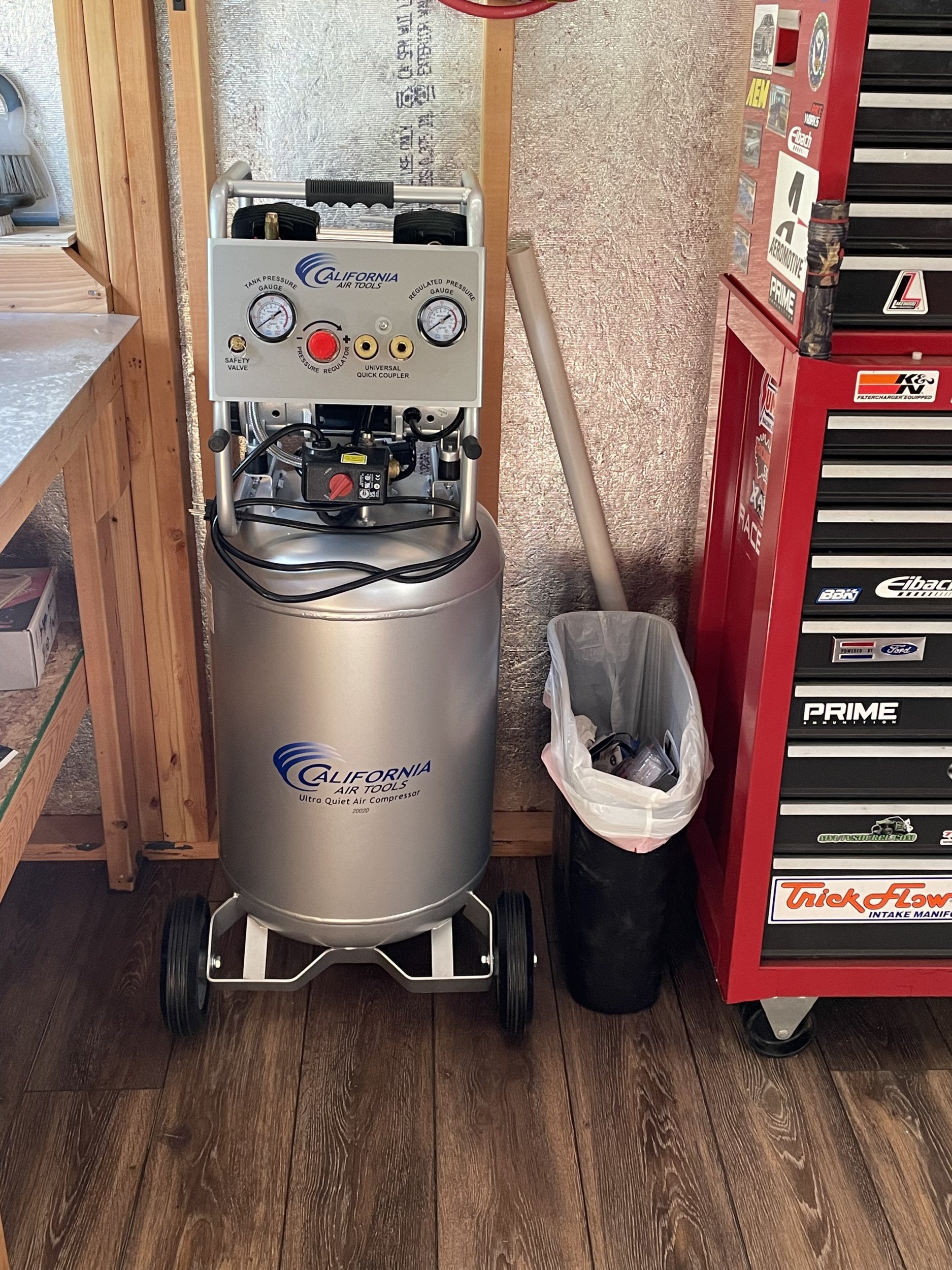

I like California Air. Super quiet and a good value.
Mike
