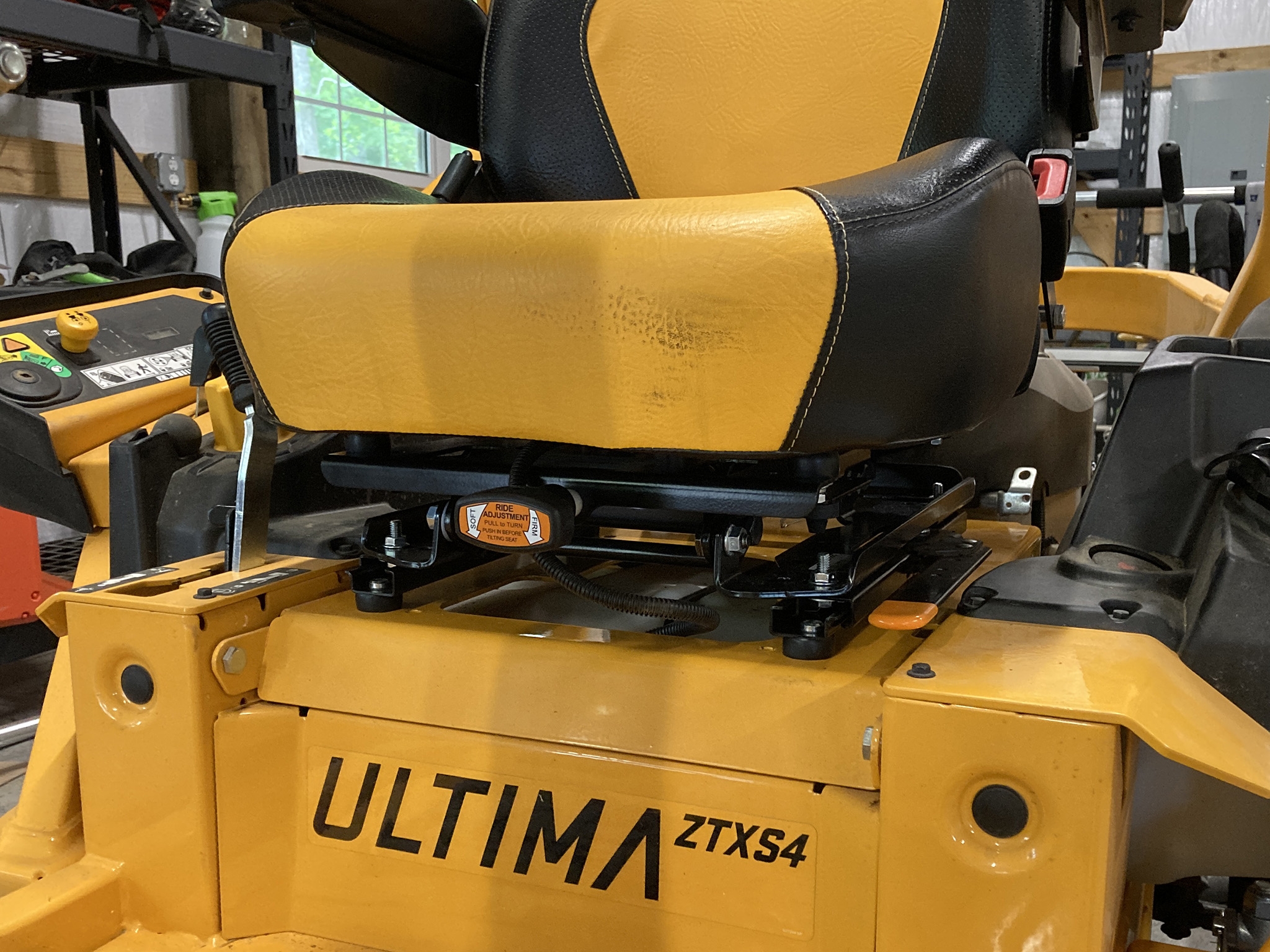

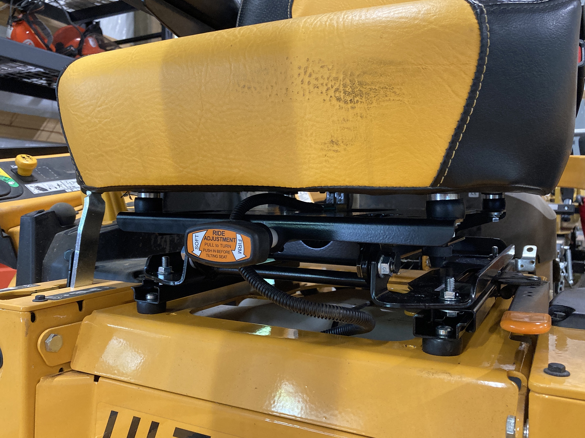

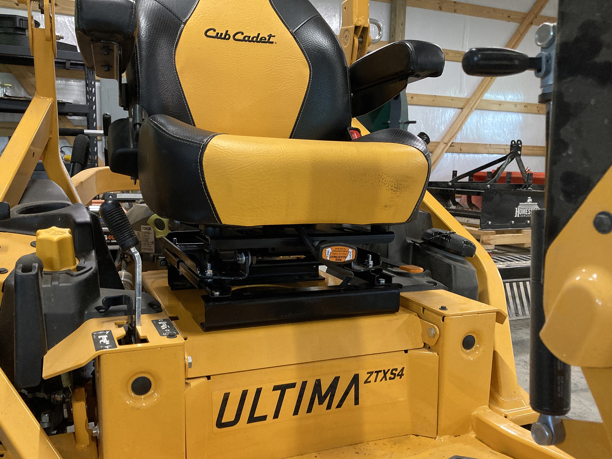

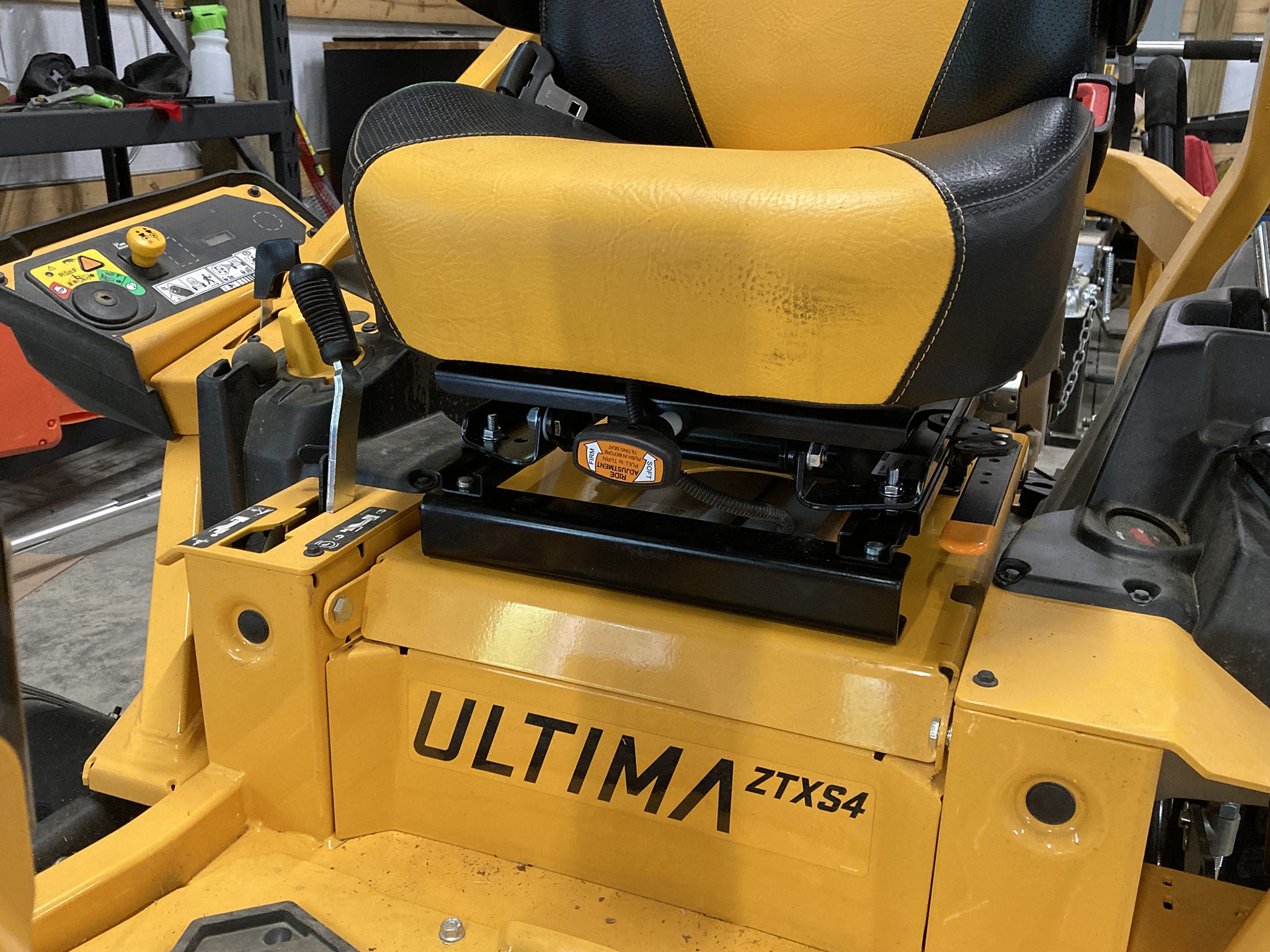

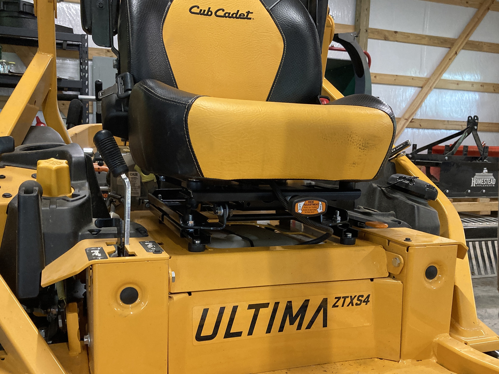

My salesperson wrote me this inside quotation marks, with my comments in parenthesis;
"Buying that suspension seat assembly through parts costs at least half of the price jump to the next size mower (this being from the ZTXS5 to the ZTXS6), so most people who want the suspension seat just buy the 6. The seat upgrade is sold through Cub for $1,100 (you have to buy the seat and suspension assembly as one part). Both the 5 and 6 have the same seat, with the same padding, but the 6 sits on something like this;
https://www.northerntool.com/products/k-m-low-profile-mechanical-seat-suspension-model-6081-23435?cm_mmc=Bing-pla&utm_source=Bing_PLA&utm_medium=Farm + Acreage > Seats > Seat Accessories&utm_campaign=K & M&utm_content=23435&cmpid=53403379&agid=3200075889&tgtid=pla-4576923311672367&prdid=23435&ogmap=SHP|PLA|BING|STND|c|SITEWIDE||Farm Acreage - SC|Farm Acreage - SC||53403379|3200075889&msclkid=4374a32120a81983fbe4c5664e8a8d7b&gclid=4374a32120a81983fbe4c5664e8a8d7b&gclsrc=3p.ds
(If you went to that link you saw a sorta box spring assembly) "You could probably fit the seat on the 5 with something like this and it would get you the same thing for $200 instead."
(For those of us inclined to tinker and take a chance it would work, or who could return the part to Northern Tool if it didn't, the aftermarket mechanical suspension seat would be an economical upgrade.)
That's exactly what I just finished installing, except I got it through Amazon rather than Northern Tool (looks like the same assembly at least).
In retrospect, I should have removed the C-channel part of the seat frame and put the sliding tracks directly on the mower to account for the added height of the suspension assembly. Will have to go back and do that.
Lots of little details to sort out to get it all to fit right -- spacers to make the seat presence sensor fit, swapping the sliding rails so the release lever is out of the way, etc. If anyone else decides to get one of these, reach out and I can save you time/effort/mistakes with some pointers! :)
Edit: yep, looks better without that c-channel. Attached updated images.
