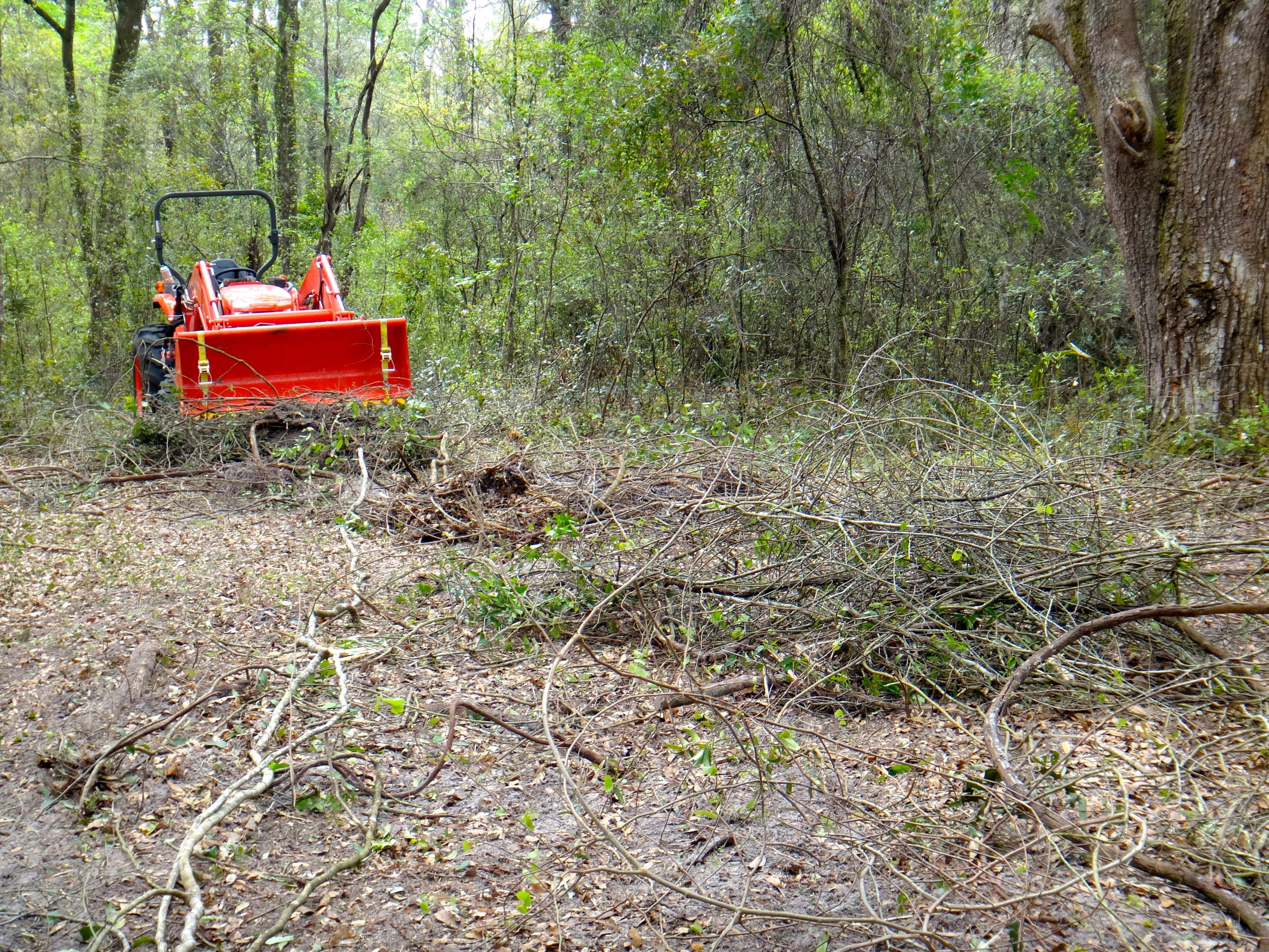

I just did a similar job clearing a food plot in the woods. I used my FEL to push the small trees and brush out of the way, and began to rip up the roots and vines with the scarifiers on my grader scraper and followed up with several passes with the disc. I figure everything left will begin to rot and provide OM to my soil.
   / Recommended attachment for roots #14
For just one acre, I would probably used my box blade's scarifiers to dig up and expose as many of them as possible. And then I'd go buy a battery powered reciprocating saw and just saw them off as low as I could.

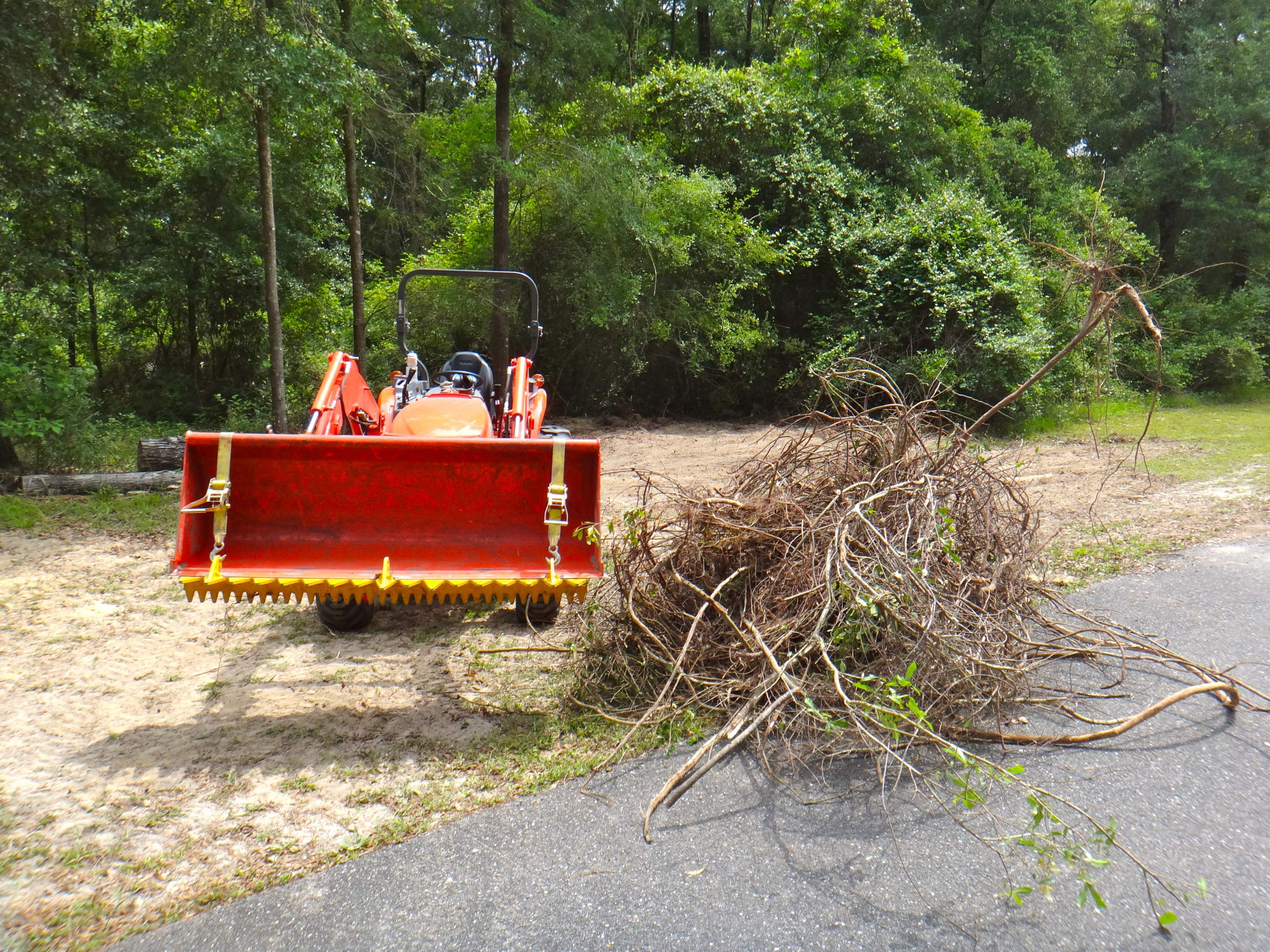

Shucks. my little Mitsu has teeth on the FEL.
I simply tilt the bucket to about 90 deg and back drag and collect just about all the roots you want, OK maybe I need a second pass but sure does the job. A bit of valve feathering from time to time and I only collect roots!
I then scoop the roots and dump where they don't matter. Works for me!
A toothed bucket is a whole new world! Try it. (most valuable add on for me!)
Ratchet rake is good but tooth bar is best, (imho)
