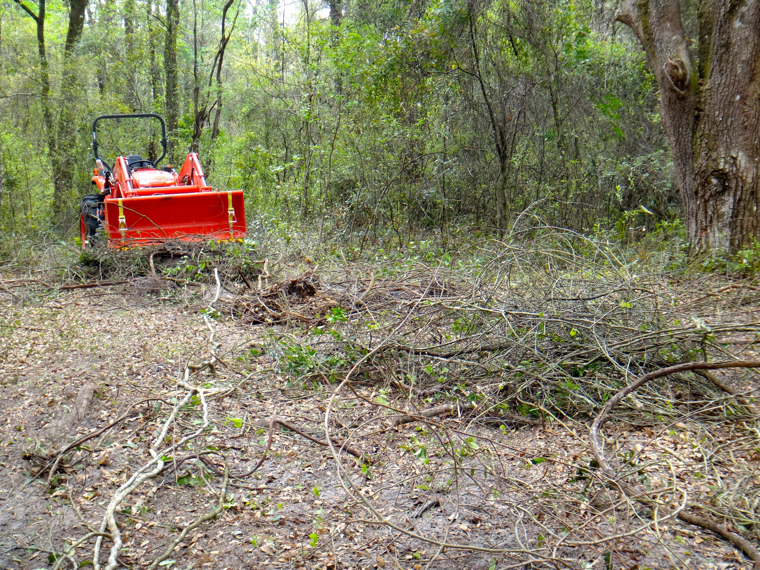

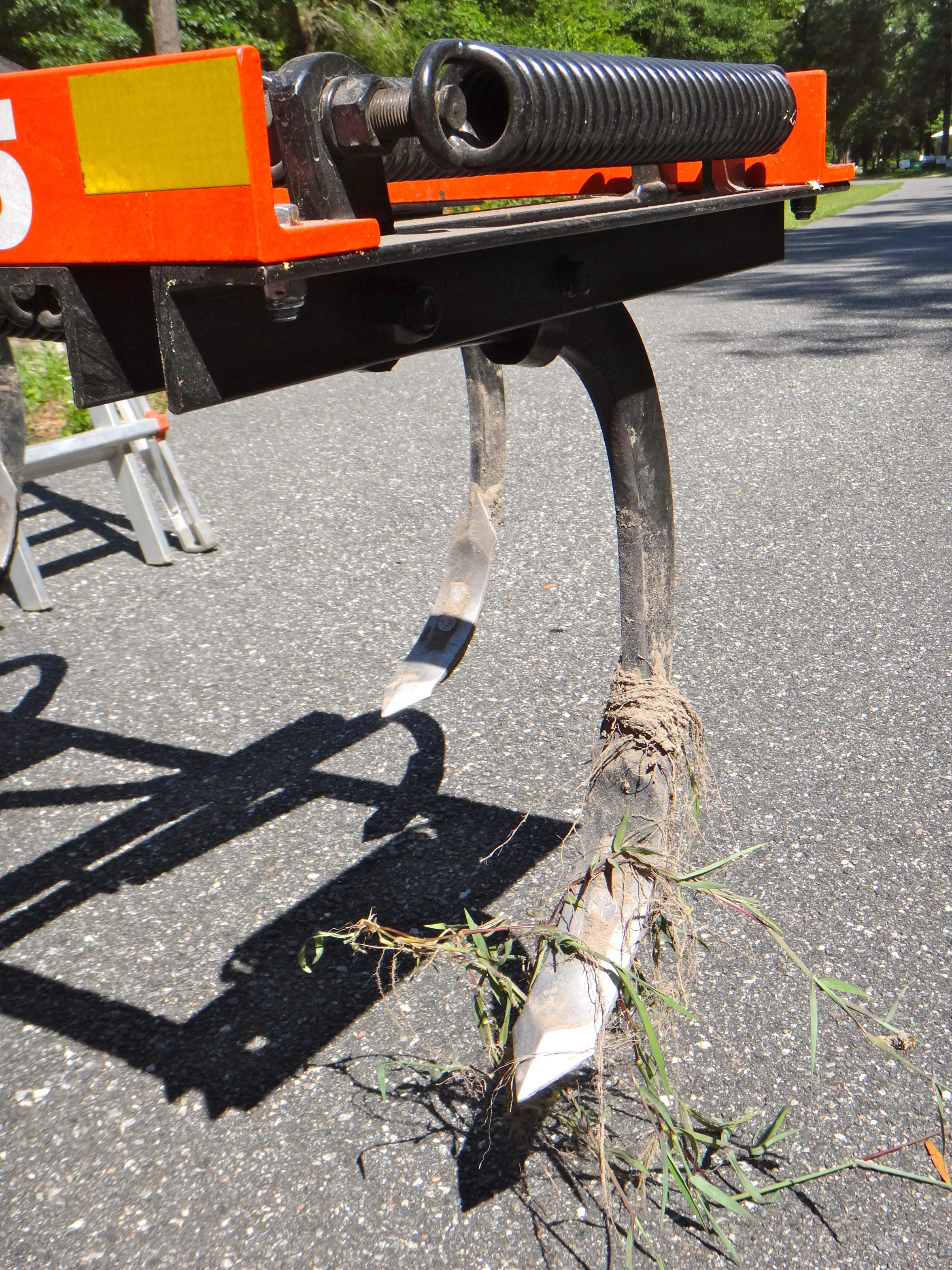

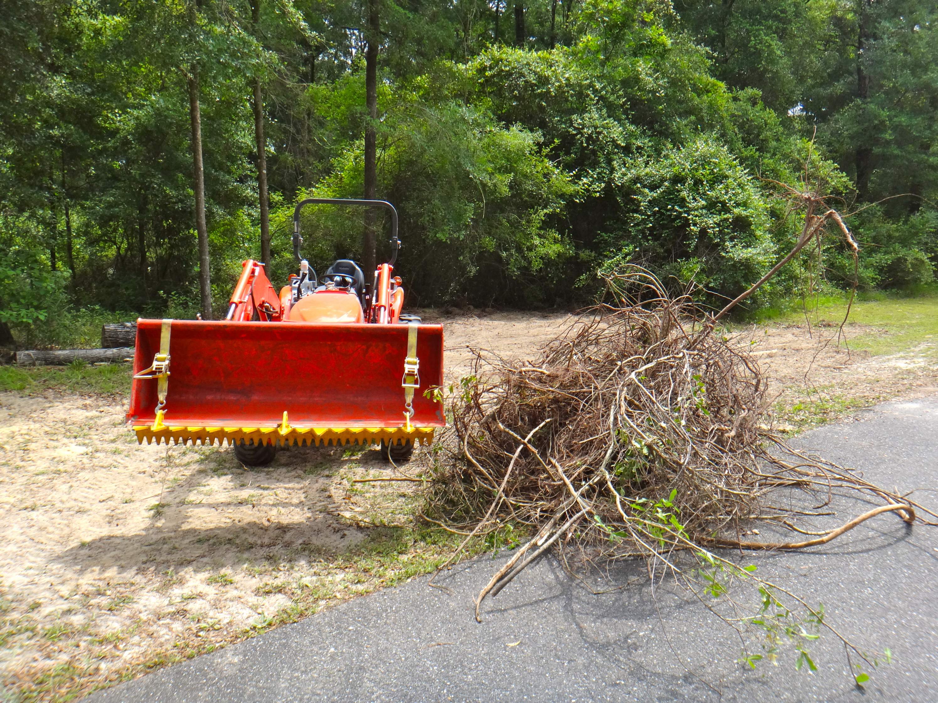

KTHOMPSON is right: Tractors are designed to PULL. Forget the FEL for anything heavy duty. Use the Three Point Hitch. ~~Let those big rear wheels work.
I use a Dirt Dog (brand) Field Cultivator, which has been highly satisfactory pulling roots, vines and corms from woodland Florida sandy-loam soil. I regularly pull up 3" diameter Water Oak roots and wild grapes vines. The corms are mostly wild climbing rose, locally termed sweet potato vines. I have pulled up single corms weighing sixty pounds.
Parabolic tines grip masses of detritus, which can be pulled considerable distances for disposal/burning losing very little. (DO NOT discount this transport function.)
Dirt Dog is located in Commerce, Georgia.
LINK: http://www.tractorbynet.com/forums/...ement-vine-root-removal-woods.html?highlight=
ETA (everytfhingattachments.com), three hundred miles distant, offers Fred Cain (brand) Field Cultivators delivered to your property.
I have used the scarifiers on a Box Blade. Box Blade not satisfactory for this work except, perhaps, in a small area, if you already have a Box Blade. (Photo #6)
A Subsoiler is another option, especially if you want to remove rotted stumps, but you lose Field Cultivater combing and transport attributes.
VIDEO: subsoiler stumps - YouTube
BUY ENOUGH TRACTOR​
