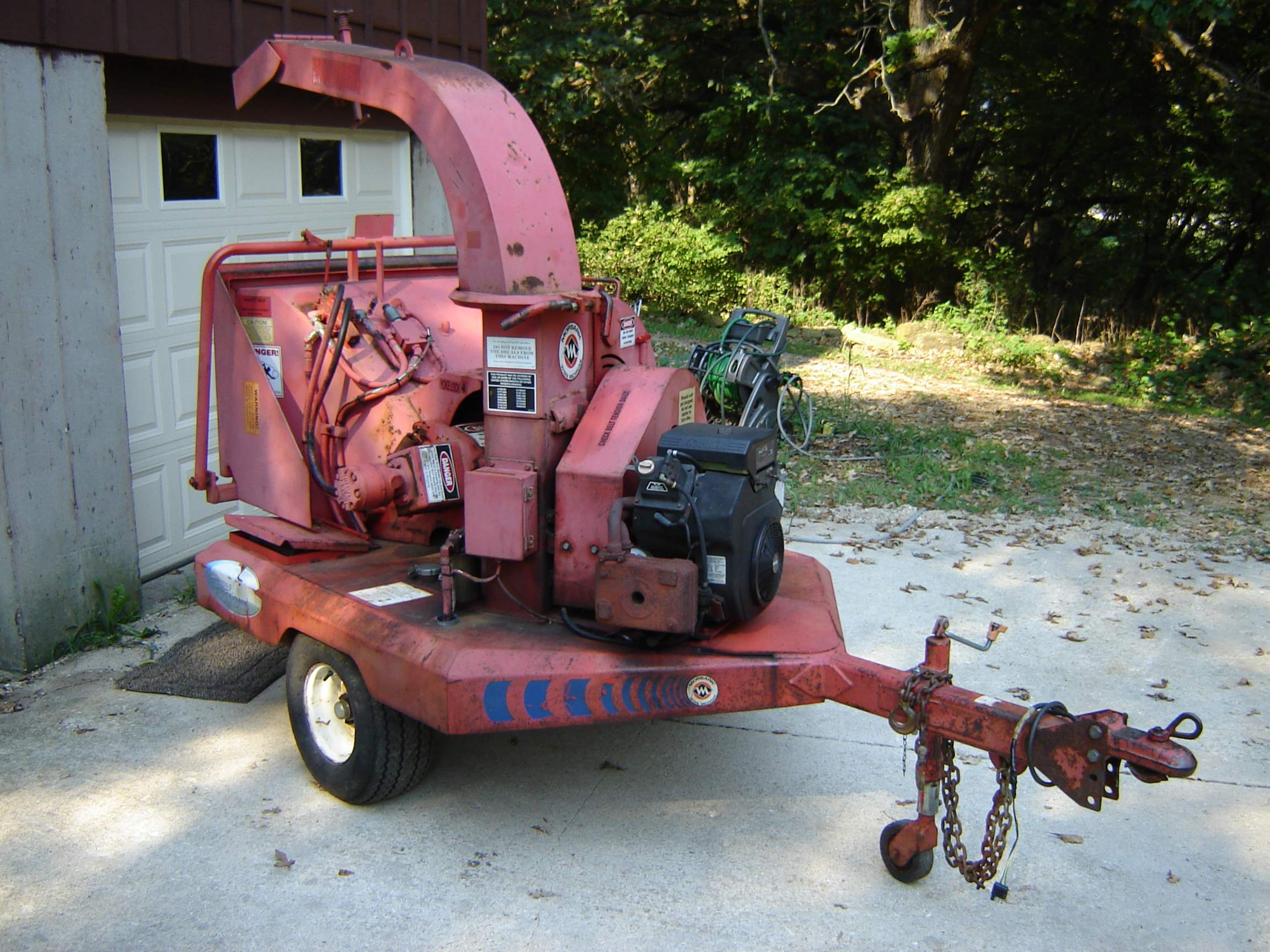

Here is my Morbark 2060 cyclone chipper. I like not having to tie up a tractor for chipping. I can also easily transport this unit.
