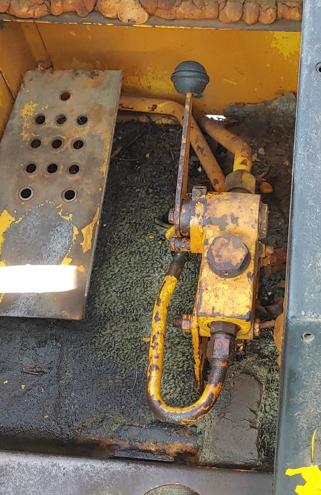

   / Recommended hydraulic oil for Case 580B
I am talking about the Boom Lockout. Its on the floor at the rear of the tractor by the right foot swing peddle.. Its the one were the rubber hose came off and caused my oil bath. You can see in the photo just below the handle that the hose has slipped back.
I attached a photo of what I'm talking about. Sounds like you have done a lot of really useful mods to your 580. One thing I would really like is a Thumb for the backhoe. I live in a very rocky area and sometimes its a real pain casing rocks around to move them. A thumb would make life much easier. They are just crazy expensive :confused:
