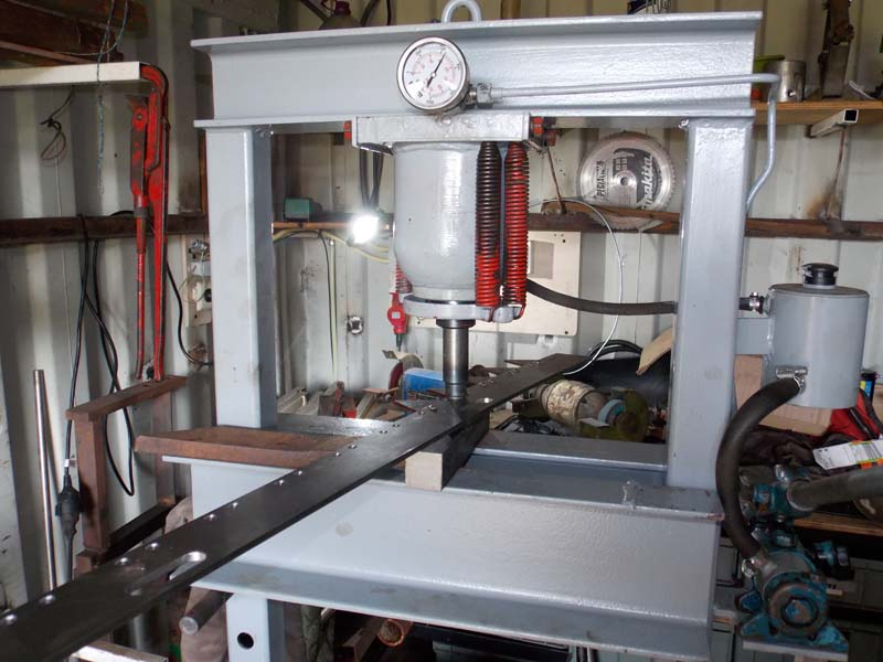

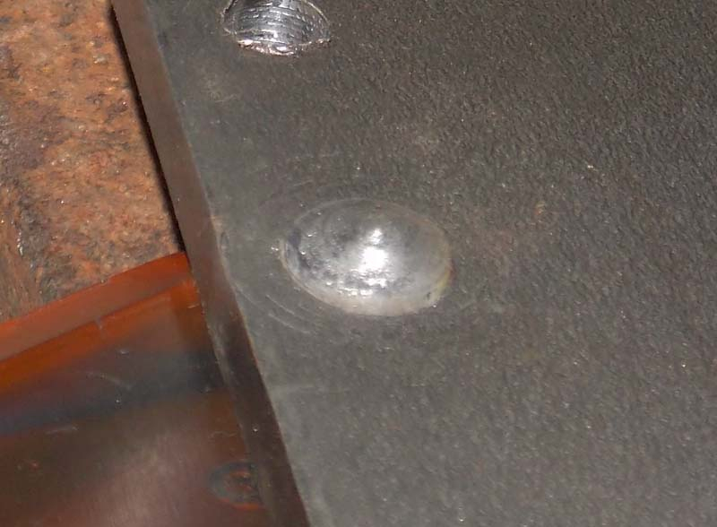

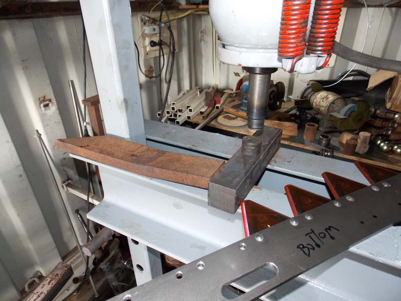

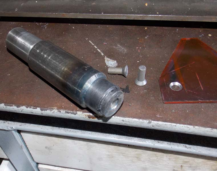

I pressed the rivets.
I made 2 hardened anvils for my press.
It's a 20 ton press but I think 10 would do it.
This is for my home made hedge cutter, it has cutting blades above and below to work with a scissor action.
48 blades, 96 rivets.
I think the press works better than a hammer, but probably not as fast.
It's more peaceful for sure.
