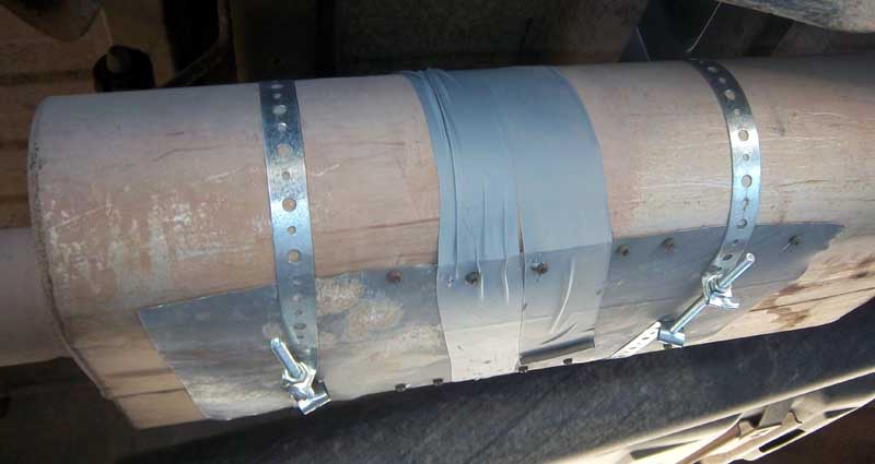

My muffler had a few holes in it. Got tired of the noise, so a repair was in order.:thumbsup: :laughing:
Still needs a few more screws, but you can't rush a big project like this. :laughing::thumbsup:

If that is duct tape in the center, I suggest it be removed after the rest of the screws are installed. Amazes me sometimes how long today's exhaust systems last compared to older models. I had an '85 Ford Crown Vic and it went thru a system in about three or four years, bought a '92 Olds 98 and it still had the OEM exhaust system at 125,000 miles when we sold it in late 2004.

If that is duct tape in the center, I suggest it be removed after the rest of the screws are installed. .
No self respecting Red Neck could do anything without some Duct Tape. :thumbsup:

I just did one myself, nowhere near the advanced repair of yours :laughing: I just got a tube of that high heat steel repair putty and battered it on.
Mine had rust thru at an end seam so there was no way to put a steel patch on it. The material cost 4 bucks, I really had no expectation it would work, but figured it was worth a shot, it was in a hard to reach spot, just enough room to get my hand/fingers in.
Let it set overnight and it worked great :)

I too am guessing the duck tape was just to get the clamps on, im sure you realize it will burn off. That is a flowmaster or a copy, you will be able to weld on them if you have enough solid metal.

Looks like a great job to me. I have done a few muffler patches by welding the patch on. If you use a good patch you can put little spot welds on with 3/32 6011. Like others, I haven't done one in a long time because they last so long now.
/ Red Neck Muffler Repair. #10
i've used a soup can and pop rivits to patch one before.. :)

Darn it! Wish I had thought of that. :laughing: here come the Pop Rivet's to finish up the job. :thumbsup:
I might have gas welded it, but my tanks are empty, :laughing::cool:

i'm not good at gas welding.. braze and solder and arc welder yes.
but the pop rivits and some hight temp red and a can of campbells does the trick..
