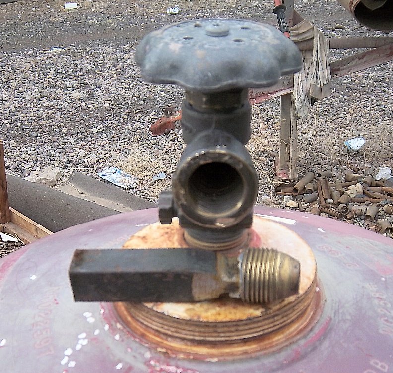

First is and easy out made from a R/R spike. Needed to get a shattered brass fitting out of a propane tank. Few minuets on the grinder & it worked to perfection.
Maybe a 1 time use.

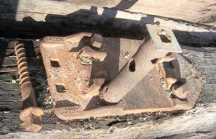

A socket for removing Lag Bolts out of R/R ties. These are lag bolts from He!!. Just a hunk of pipe, split & welded together. Holes are for concrete stake & most of the time a long piece of pipe was needed to get them started. Square hole, some what beat out, was for a cheater bar or impact wrench. I may weld an old socket there if needed. This simple tool has removed over 100 lag bolts.

oh and what in the world do you do with lag bolts like those!

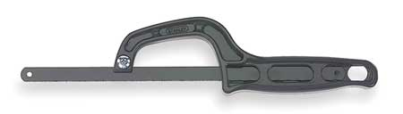

Or you can spend a few bucks and buy the tool....
Super handy! Have had one for 20 years, and just bought my son and son-in-law one for Christmas :)
Well the could be used as BIG lag bolts. But #1 goal was to get the plates ( 3 types that weigh 40 pounds or so) off the RR ties. So far the ties have been used as fence posts. The next use for them is a wall about 4' high around my black smith & welding area
One lag bolt is now used as a cold chisel. Square off the head with a little grinding and it fits a hole in my anvil.

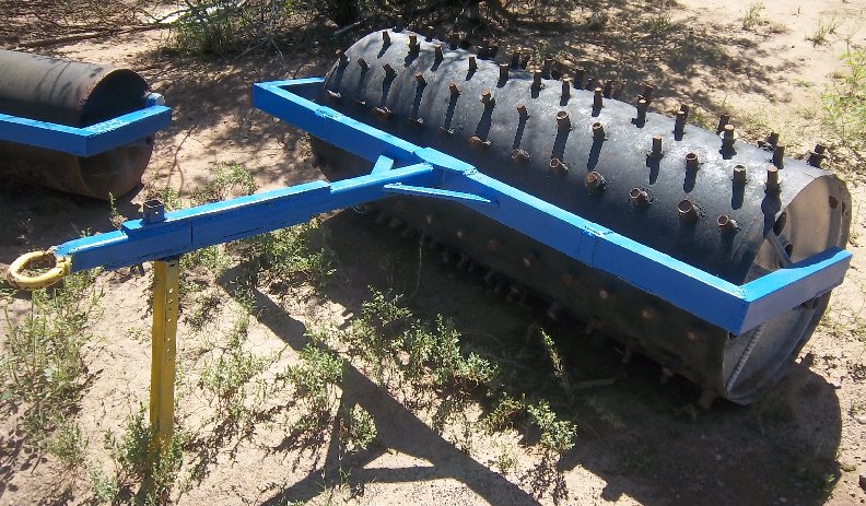

Many others were cut up and used as feet on my compactor (sheep's foot).

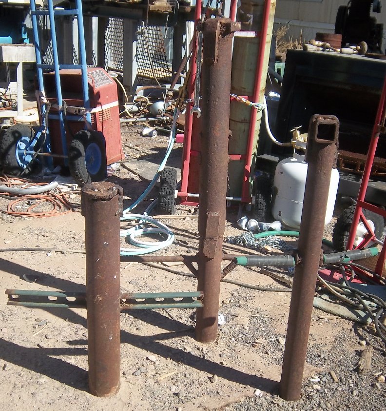

Ever Drive Posts??
Here are 3 post drivers. Tall 1 is for those 8 foot posts and almost to heavy for 1 man. Then is my favorite, easy to use and fine for soft ground. Fat one is for the wide posts similar to those used on road signs. I also welded a 1/2" steel plate on the bottom of my FEL bucket. Real handy for larger pipe & that sort of thing.

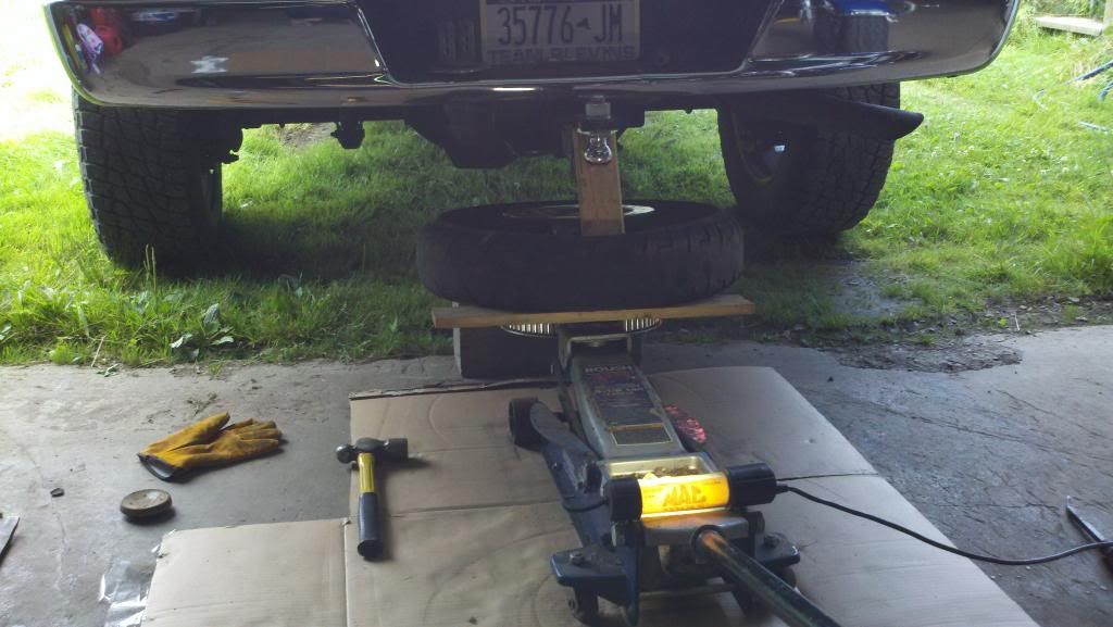

Speaking of hack saws. Falt tire on the 2001 ford Of course the little winch that holds the tire up under the bed is seized? Needed to get up under and cut the cable. The up and under part was going to be interesting. Took a 1/2 inch piece of EMT stuck hack saw blade in open end and proceeded to beat it flat. 6 foot long handle on a hack saw Was able to reach from the bumper. Worked well, tire dropped out like a rock.

Golly guys when it comes to scrap iron, you haven't seen anything yet. I try to have scrap iron for every occasion. :laughing: You just can't have too much.
the junk under the tongue is just odds & ends left over from building the compacter. It had been tumbled in the cement mixer to clean it up a little.
