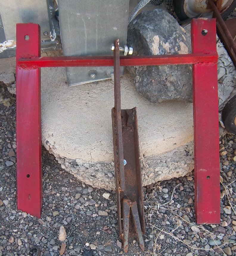

Here are a couple of useful items.
In the center is what I call a "Pickle Fork Digger". Diggs a trench about 4" wide by 12" deep. Fine for water lines in my area as long as they don't pass under an area that is driven on. Not deep enough for you folks up north. But would work on lines that get drained, such as irrigation line. Have a shovel cut down to 4" wide to clean out the ditch.
The red guy is a quirky set of forks, helps with loading brush and digging small rocks out. Don't use it much anymore since building my 4 foot, easy on / off forks.
2 bolts and either one of them is on.

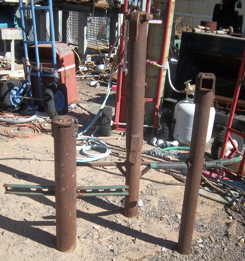

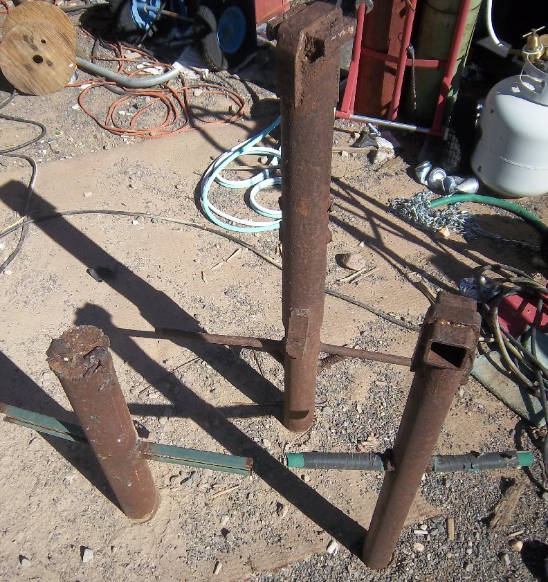

Ever Drive Posts??
Here are 3 post drivers. Tall 1 is for those 8 foot posts and almost to heavy for 1 man. Then is my favorite, easy to use and fine for soft ground. Fat one is for the wide posts similar to those used on road signs. I also welded a 1/2" steel plate on the bottom of my FEL bucket. Real handy for larger pipe & that sort of thing.

Jim, I don't know which is more interesting, your tools or the collection of scrap pieces under the hitch in the background of this photo. I think we are often defined by our scrap piles.:D

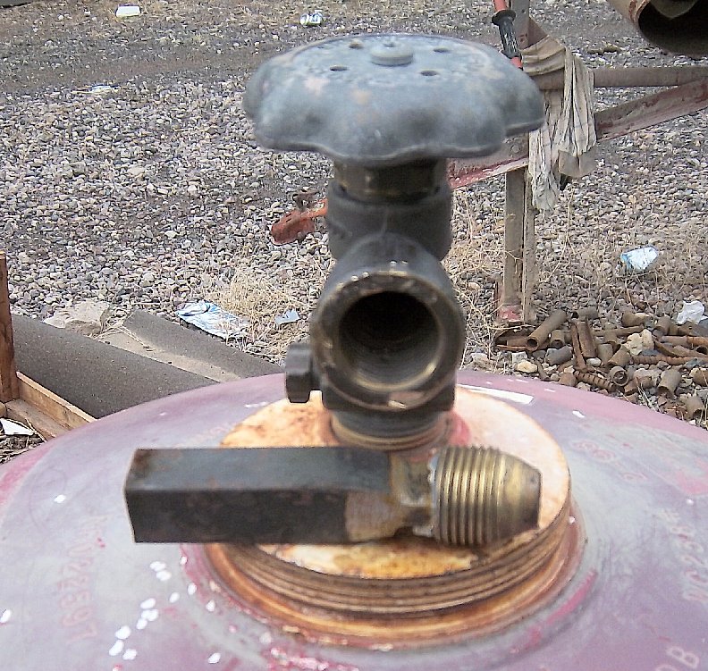

My favorite tools are round toothpicks and golf tees for a gazillion uses. Where would the world be without those?:thumbsup:

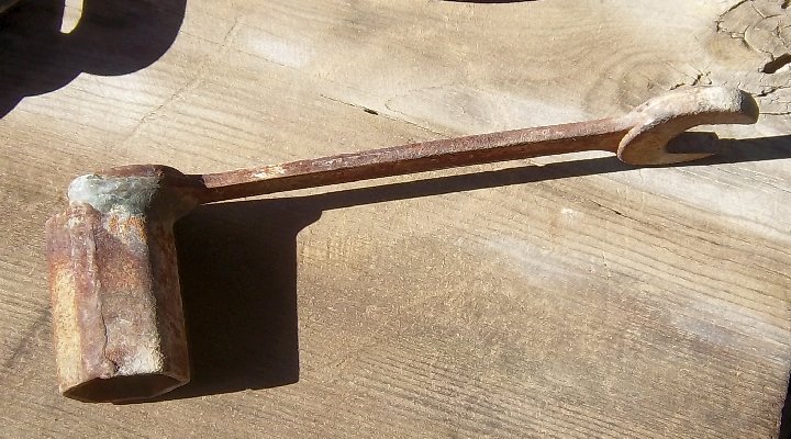

Here is a specialty "spark plug" wrench.
