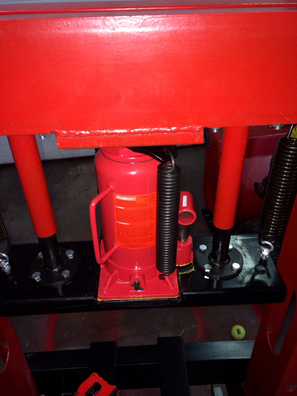

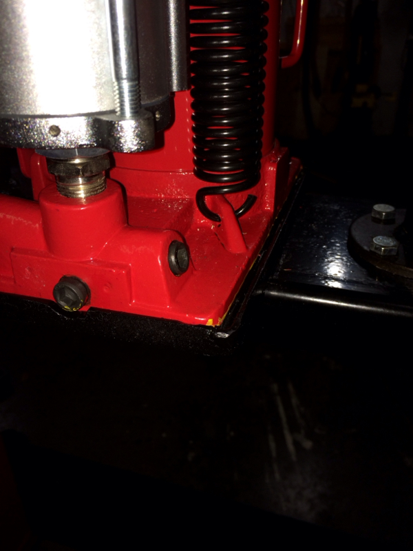

Well got the plate done and primed.
Gotta admit I should not have welded the inside edge (I knew this and did it anyway) as the jack did not sit on the plate as the weld caused interference.
Nothing a little grinding couldn't fix...
Will paint black tomorrow after the primer cures.
Will post pics of the completed product.

Here is the finished jack/u-channel plate.
My next step is to make some type of platform to raise the press up 8-12" and have it mobile on casters.
Wood or steel for this platform?

   / Red Torin 20 ton shop press mod #16
Either will work beautifully. Any material in stock? I always tend to lean that way... Someone made a good point earlier though, that the wood deck is a much better dampener if it comes to an "oopsy"...
#17
Have some angle and 1-1/2" square tubing that I can use so I may use a combo of steel frame and plywood deck.
