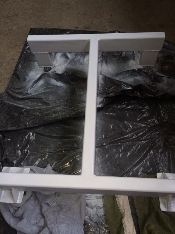

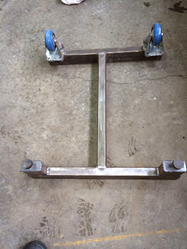

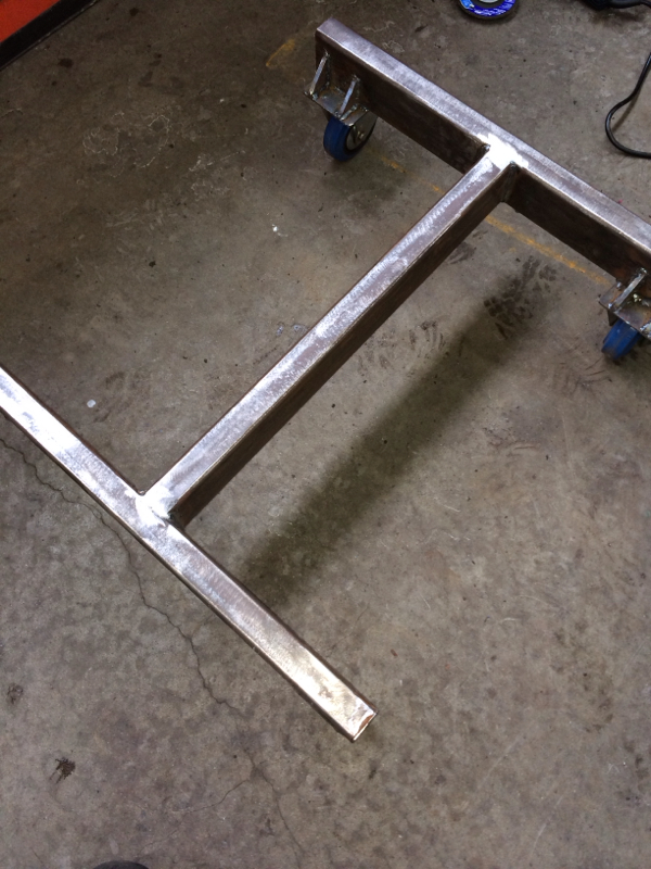

#33
Got a bit more work done on the shop press. Built a stand out of 1-1/2x3"x3/16 rectangular tubing. Used 2 4" casters fixed/no brake and tapped the 1/4" plate on the legs to accept 5/16-18 thread rubber feet. This will allow me to easily move the air/hydraulic press while adjusting for any uneven surfaces.
I am not a professional welder and am still figuring out my MM252; should have probably cleaned the rusty steel before welding-not after.
Next step paint black
Thanks for looking

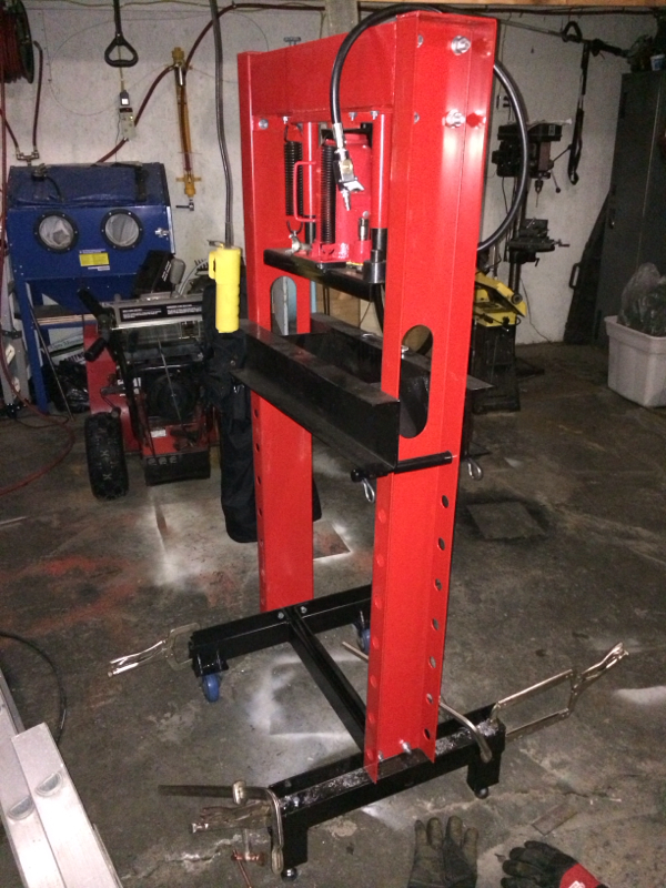

   / Red Torin 20 ton shop press mod
#34
Mounting the press to the stand.
   / Red Torin 20 ton shop press mod #35
Loookin gooder! :D
It sure is handy to move it away from the wall, for clearance when straightening bent long items. :thumbsup:
   / Red Torin 20 ton shop press mod #36
Where did you get those screw on rubber feets? Looks good. Im going to need to make something like that for my press.
#37
Loookin gooder! :D It sure is handy to move it away from the wall, for clearance when straightening bent long items. :thumbsup:
Yup I was thinking more along the lines of getting it out of the way when not needed.
EBay seller; repairparts
$8.50 US funds free shipping for 4 5/16-16 threaded rubber isolator feet.
Could not buy them anywhere locally.
