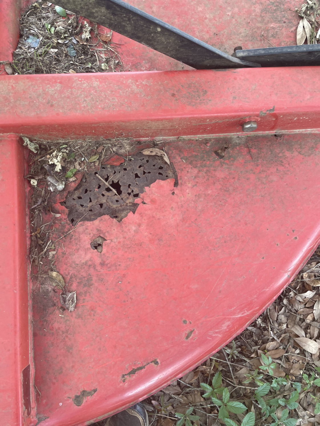

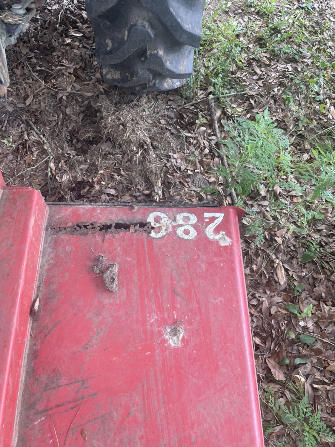

Maybe some pictures of it and we could better advise.....Is the whole deck rusted and getting thin? To the point that there are just a few holes now but alot more in the near future? Or are there just a couple troubled areas where paint got chipped off and it laid with debris on top and rotted a localized area?
Here are some pics. The debris is not typical. I blow it off after use.

I would cut out damaged/rusted areas, and patch it with like sized material, if a 120V "mig" welder can't do it, it's a problem with the weldor and not the welder....

Yup....I'd just patch the bad areas

Just rebuilt a Brush Hog 'Squealer' for a customer. Gearbox and pto was fine, blades were shot and had many rust holes and a bent side sheet. Got a new set of blades from ASC and pivot bolts, cut the old ones off, patched the rust holes with sheet steel and gave it the '5 gallon finish'. Good as new.

Why worry about those holes?? put some Fluid Film on the holes,, and run it another 5 years.
I saw that type damage on my brother-in-laws mower,, that prompted me to wash my mower after each use.

If you REALLY can not stand the holes,, BOLT some patches in place.
The bolted in patches will outlast the gearbox,, if you keep the machine washed in the future.

I would give your little welder a workout (and/or grinder if you weld like me!). You could make some really simple rectangular patches, cut, and weld them in. All nice flat surfaces. The cutter looks to be in great shape otherwise. Definitely worth repairing.
I would even say its worth taking to a welding shop to repair. Not sure what the cost would be but can imagine it would take a couple of hours and few bucks in steel. Maybe $200? I'd spend that.
