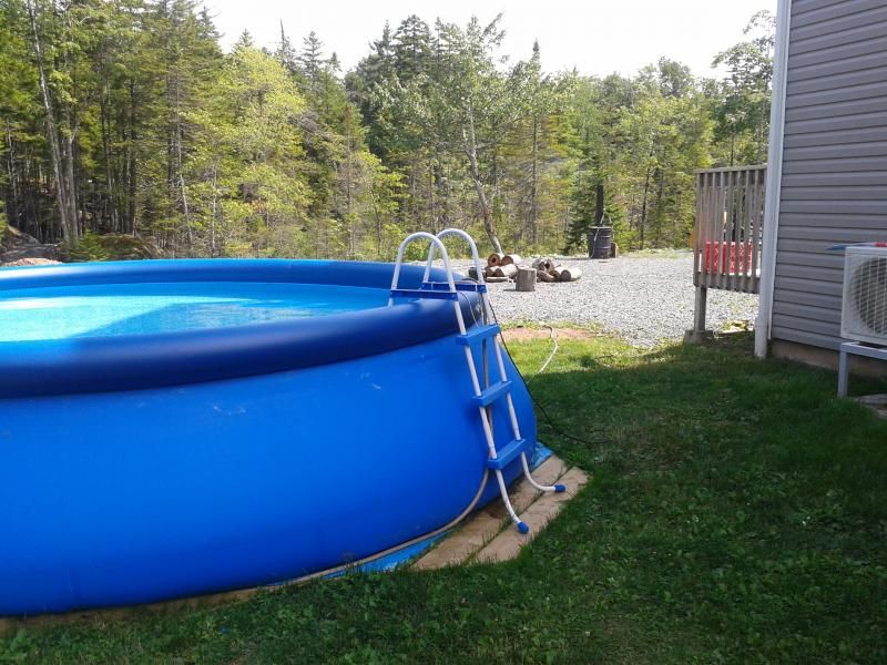

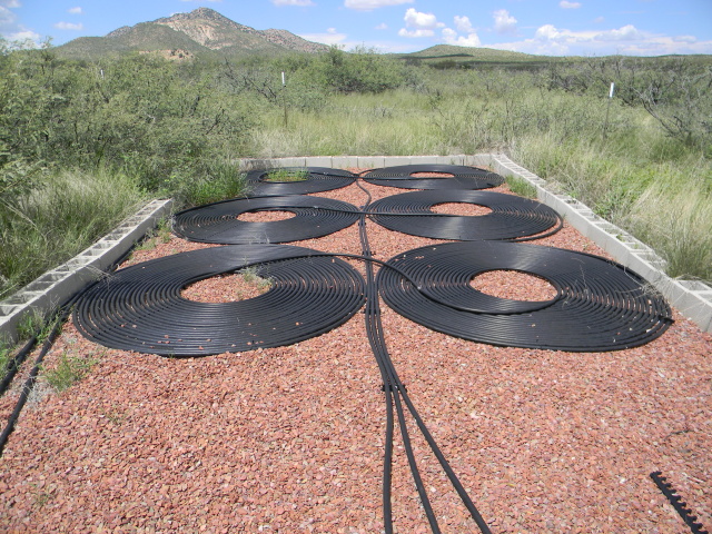

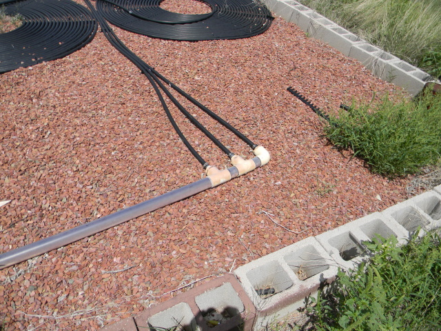

Here is mine. It will heat the in ground pool to over 90 if I put the cover on at night. Without cover it will get to about 80 or 85. It needs some weed control.
Don't want to hijack the thread, but maybe some details on this? How did you get it coiled so nicely? I'm fixing to make some sort of solar heater using poly hooking into my DC pool pump once I get it hooked to own solar supply so basically it will pump whenever the sun is shining. Once I get it going, I'll be posting as well.

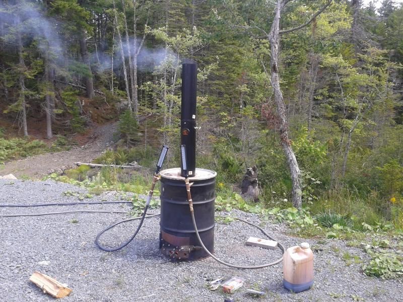

Got it up to 29 last night... but lost 2 down to 27 overnight. I decided it was better to let the fire die off before bed and stop the water flowing, then have the fire die overnight and keep pumping water through 160'+ of garden hose in 14 deg air, effectively cooling the water.
Supposed to be nice today... and may very well be the last day for the pool. We're chewing through wood pretty good... unless we get a warm spell, or I get the oil system working better.
   / Redneck pool heater 3.0
#44
31deg BABY!!! :) There is no hesitation... you just walk in. Not cold, not hot. Just right. I couldn't be happier with it.

Got up to 32 yesterday, but down to 28 this am. Still pretty good. Supposed to be a nice couple days.

We did end up getting a solar blanket, and I think it's making a big difference. We seem to have leveled off to 28deg without me putting any more heat into it since the weekend. This is with mid-teen temps overnight, but nice sunny days in the mid to high 20s.
I don't think insulating the pool would be practical. I don't think I'd loose much in the ground, the solar blanket helps, and the sides... well it is what it is. It seems with so much water it takes a long time to heat, but also for it to cool off. I think it's safe to say that with this heater I've doubled the pool season.

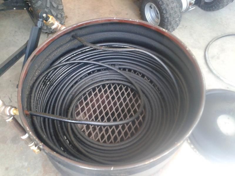

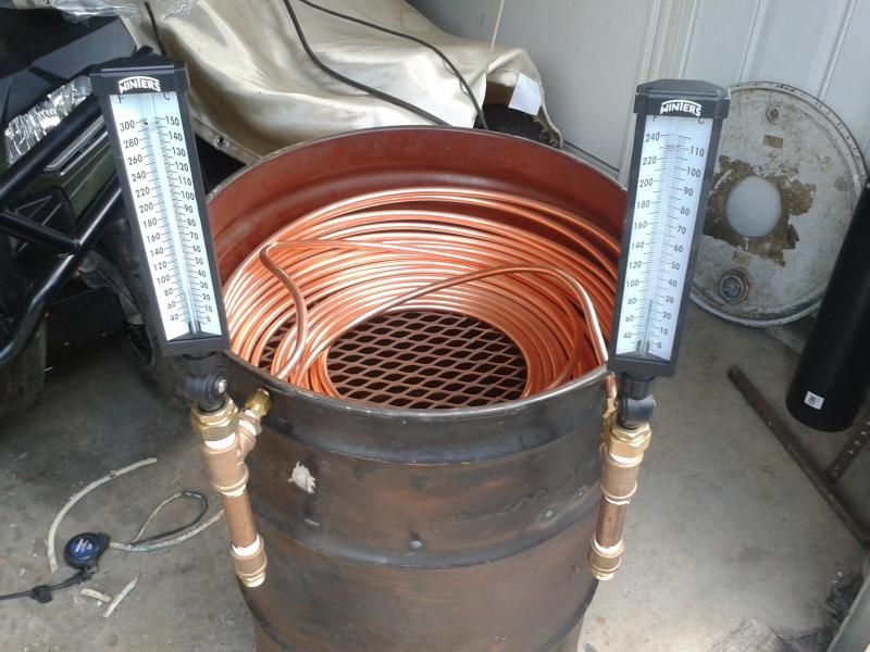

I'm thinking the copper coil could go inside the upper part of the chimney. Perhaps not as efficient as my wood burner, but I can get free oil, and I like that it would work with much less nursing, therefore run more often and longer. I'd build mine out of another 45gal drum, cut down and re-welded. Maybe remove 1/3 height. Some chimney lengths, 2" exhaust pipe, and a damper/ filler. I could make that in an afternoon. Copper's cost is the only sticking point....and gauges... but I could tear the wood burner apart.

Not pretty, but got a start on mine. This will be a solar loop. Also started a new thread.

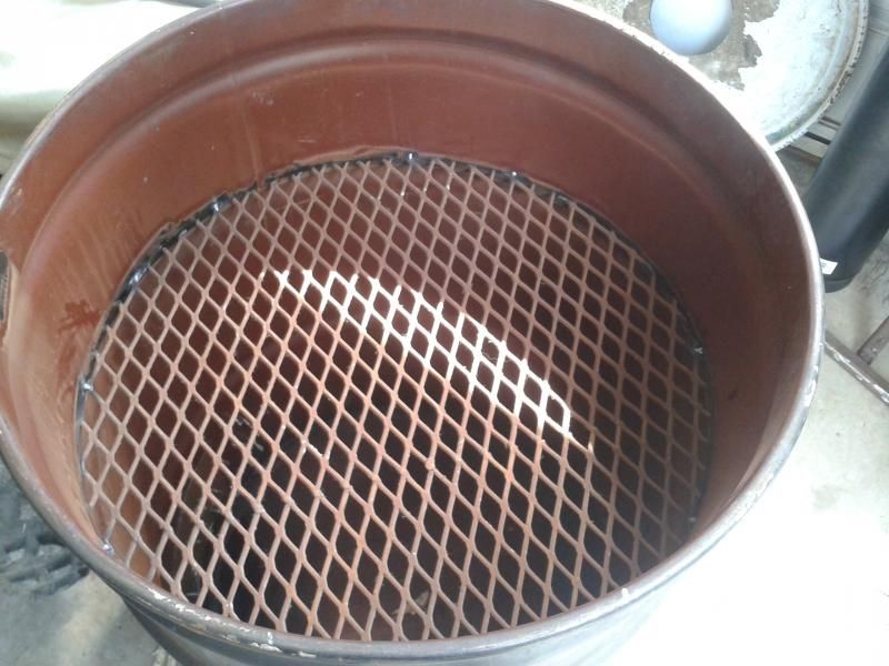

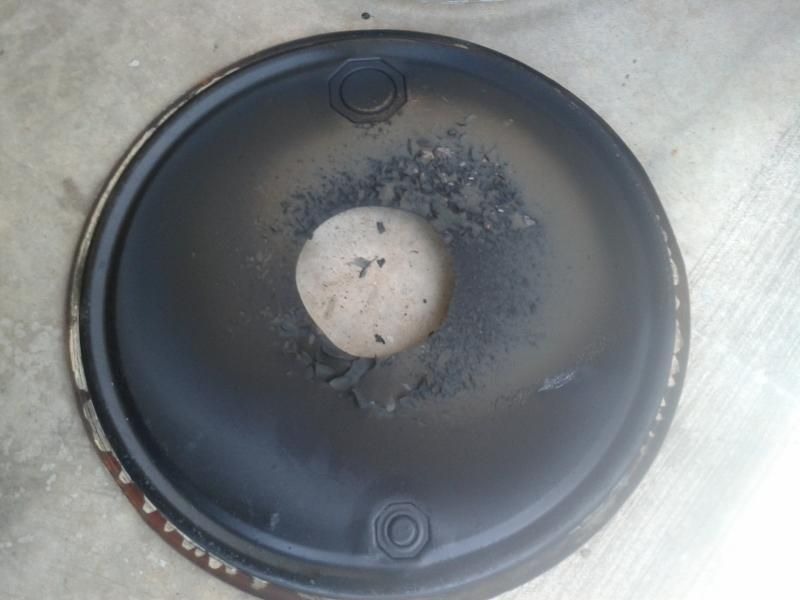

Before
after
Screwed up the hinges... door don't open. LOL
Start of the draft
...and this is when my last jig saw blade broke. That decided I was done for the day. LOL

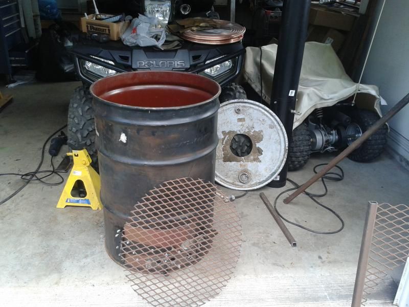

Man, the heat sure warped the door!
Perhaps some light angle iron top and bottom... I hate to do it... that new front section sure added a lot of weight!

I did a similar pool heater for a similar pool. Instead of coiled copper pipe (for the exchanger) I used a cast iron steam radiator that I bought at a local recycled building materials store for $25.
I chose one that fits within the size of a 55gal drum, but haven't built that part of the project. I set it over a campfire for a first test and it worked great. Had to stoke the fire all day, packing the wood UNDER the radiator which was laid across the fire like a cooking grille. It was a lot of work, but it proved the concept. I'm certain it will work better in a drum but doubt its as efficient as copper pipe. I filled the pool with gravity-fed creek water, running all the fill water thru the heater.
