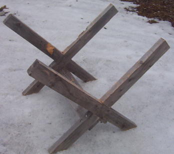

we use a sawbuck where we stack a lot of the little branches in it and cut them all at once. It prevents us from bending over all the time and puts the wood at waist height.

Problem with using a chainsaw to cut small stuff is the branches catch in the chain and bounce around too much. A set of crossed into "X" shaped
2x4,s to make a v shape to hold your small stuff in. You can even stack some small branches in that V. Use a Sawzall with a long woodcutting blade. They have battery sawzalls that are light enough you could use without wearing yourself out. A good set of pruning loppers would work as well. Using a small sharp hatchet on a log is another method but fingers are about the same consistency to an axe. :mad:
