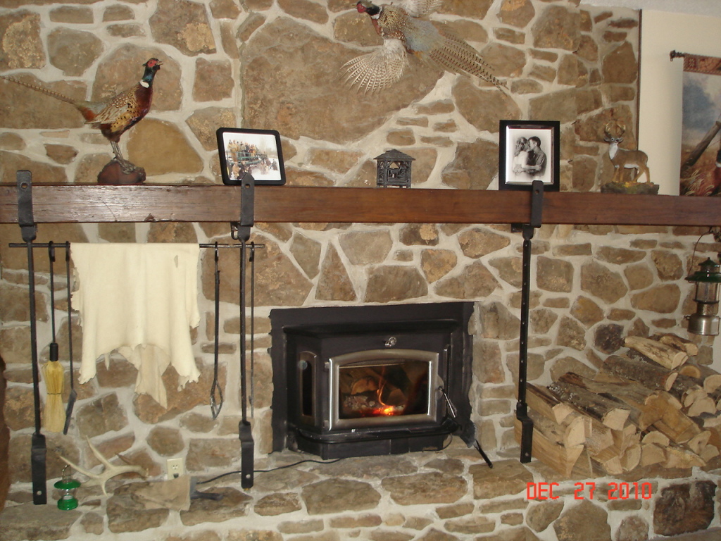

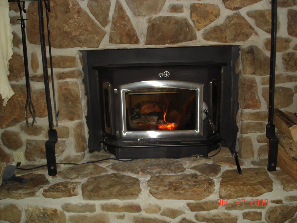

We had a Buck Stove model 91 Catalytic insert installed. Here's a link Model 91 Catalytic Wood Stove . I believe all Buck stoves can be freestanding or inserts. Our home is 1800 sqft with a full finished basement. This stove is our primary heat source, heat pump back-up. It came with a thermostatic controlled blower. Installed with a stainless steel liner was about 3500.00. We figure on a 4.5 year payback (with current kWh rates). It's a front loader, wood goes in with the ends looking at you through an oversized glass door. It does a great job. Low, slow overnight burns of 8-10 hours on a loading. The catalytic aspect of it gets the most heat out of your wood. It's also EPA compliant. I've never used the ash drawer, it's easier to remove from the front. Like others have said, nothing like wood heat to warm your tookus up, or the tookus of your cat/dog/parakeet/ferrett. :laughing: Can't do that with a heat pump. There is a concern with the messiness, you soon learn how to do it all in the least messy way possible. Our home is in SW Missouri, we cut the wood we use from deadfalls on our property. Winters here might not be like in the northern states, we've already had single digits temps. It is a job to get wood cut, split, and stacked for the winter. Last winter we burned 3 stacks of wood, each stack 20' long about 5' high. I cut our wood about 18-20". The stove will take a 21" stick. I'm working on next years supply now, it's a labor of love. Mark
