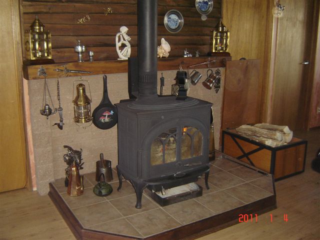

I got a woodstove in both my 2200' house and the 1500' shop and go trough 16 cords a year to heat the both of them.I have nat gas backup as well but burn mostly wood.
My wood is free as i own the land it's on and felling,bucking and hauling takes only a couple days of my time.
I got the tractor and other equipment allready for the farm,so no extra investment is needed for the firewood part.
I only use deadfall or dead standing trees,mostly pinebeetle killed pine.Is dry allready so i don't need to cure or split it right away.I hate splitting large quantities at once,so i split daily as needed with a maul(gives me some exercise).I don't have a woodsplitter or need one.
For the house the wood is stacked in the garage and it's nice and dry and warm there so i don't have to go out in the cold to get it.
If i had to buy the wood or had to travel to get it or had to buy equipment for it i would not do it.(can't see the savings).
I live in a area with a long cold winter.
In my house i got the biggest Yotul avalable,it has no stones in it either so there is nothing to break or replace.It is the best stove i ever bought.
I start the stove up when it gets colder in the fall and it'll burn continuesly till spring.There is enough coals left in the morning to get it going again in a minute just by opening the ash door a crack.I load trough a side door.
I made an extra ash pan so spill of ashes has never been a problem cause what ever falls out when pulling the full pan out ends up in the one underneath which then in return gets placed in the stove.
I'e had other (plate steel) stoves,some had these itty bitty ash pans and basicly they are a joke as the ashes had to go trough a offset hole in the stove bottom and it always resulted in ash and coals spilling over the sides.(engineering at his worst)
I have not had to sweep the chimney in the 3 years i've had this stove,its always clean.
I also made a wood box which keeps everything nice an tidy.
A good looking stove not only provides exellent heat but can also be a great focus point in a living room + it'll keep the house warm even when the power goes out,in which case one can cook food and brew coffee on it as well. :thumbsup:
My 2.. ehh, couple more ..c
