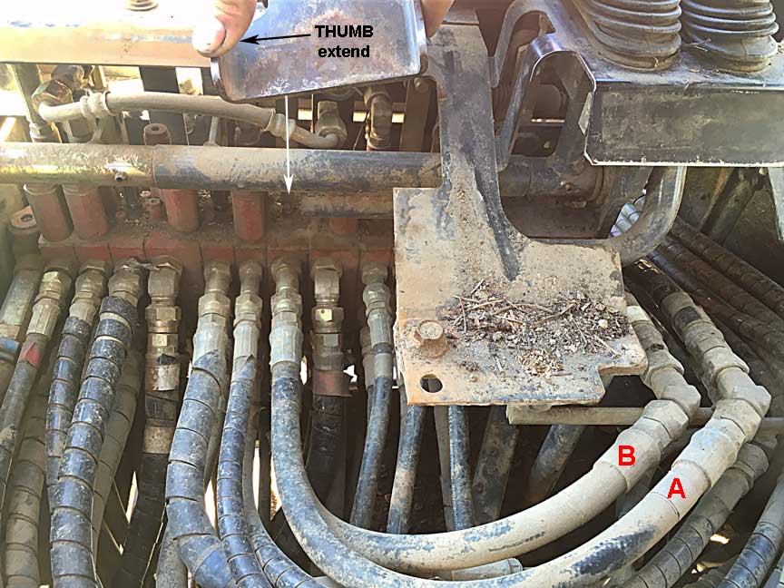

Thats a really good idea. Basically same as the other valves in the stack except $500 less. And no funny business up on the boom where its visible (and can get tangled in trees etc.) Just have to see if there's room for it (tiny machine!) and how to plumb into the rtn.
   / Reduce pressure to thumb (bends pivot pin)
#18
OK Ron I looked under the floormat with that in mind. It's going to work GREAT, as you'll see in the pics below. Now that I'm back in the house I realized I don't know which hose (A or B) is "extend" but pretty sure I can figure it out when it's time to install the valve.
463171d1459531528-reduce-pressure-thumb-bends-pivot-relief_ab_return1-jpg
Will be a short, clean run to Tee into the return. Theres a lot more space for a Tee in it at the junctions shown in the first pic. I know the relief valve is plumbed backwards in this pic.
