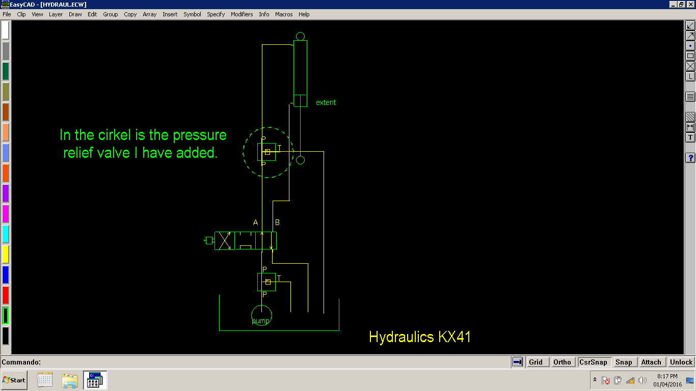

The left image shows how I plumbed the pressure relief valve. It works when the thumb cylinder is extended, and it works when the bucket pushes the thumb cylinder back, protecting bushings and pins. The valve is adjustable.
P=pressure
P=pressure
T=return to tank

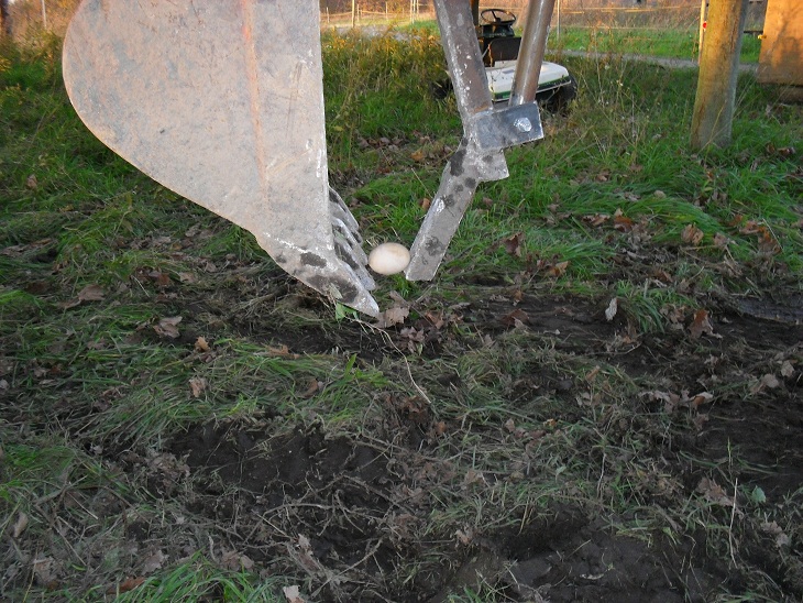

The second picture shows how good the valve works. :laughing: :laughing::laughing:
   / Reduce pressure to thumb (bends pivot pin) #24
Pressure ( P ) to pressure ( P ) is always open. The return to tank ( T ) is the pressure relief valve, and opens only when the pressure exceeds the pre-set maximum pressure.

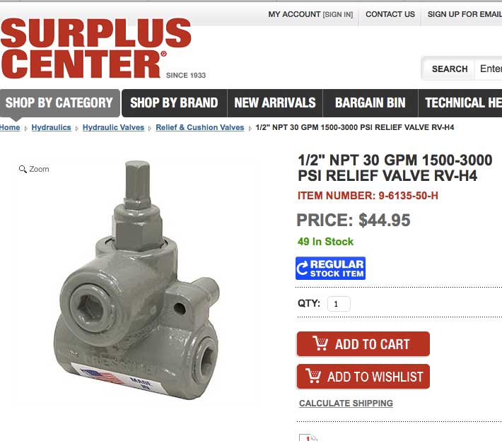

OK back to the task at hand. I think I will use the SurplusCenter 3-holer. I found what the difference is betw. 2-holer and 3-holer relief valves - the 3-holer includes the "Tee".
Here's the RV.

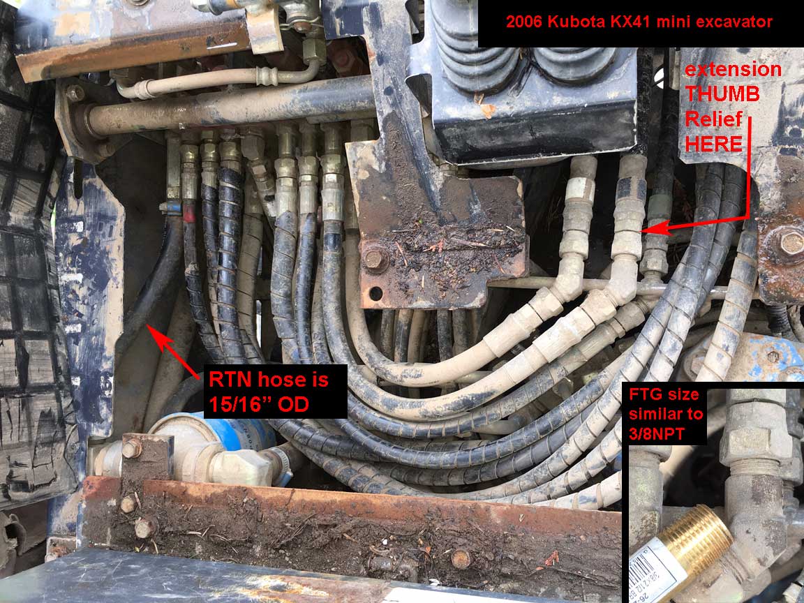

I'm going to put it betw the fittings on the right "on the extension line".
463539d1459810782-reduce-pressure-thumb-bends-pivot-surpluscenter_assistance_pic-jpg
I called SurplusCenter and they could not help me with the fittings. I need to get a list together, of the fittings to Tee the RV into the extension line. And then the push-on size to Tee into the return (probably 3/4" barbed). Does anybody know the name of the "fitting style" that is used by Kubota? The fitting size is appx same as 3/8NPT.

Im missing something here, it looks like all your lines are tee'd together.
It's an optical illusion. There is 90deg fitting superimposed on top of the other line so it looks like is plummed in a circle. Look at the picture again and you can just make out the lower line on the right.
My photo does not show the connections well. Look at BERT's first diagram with the dashed circle; that shows the
3 ports for a cylinder RV application.

Sodo, from looking at the inset in your hose pic you might be looking at japanese JIS fittings - if you don't already have DHH's pdf on fitting dimensions, dnl it here
http://www.discounthydraulichose.com/v/vspfiles/downloadables/thread_guide.pdf
page down to the Japanese JIS 30ï½° flare fittings and check the actual thread diameter on YOUR fittings to compare - from the outside, the japanese versions look a LOT like JIC, and from my experience you have either one or the other. Getting EXACT measurements across the threads will likely tell you yours are either 06 JIC or o6 JIS - while the mating faces might actually seal with either type, the threads are off by 1 tpi and thread diameters are off too, best you could hope for if you get it wrong is some destroyed fittings.
Sooo, look at the drawings of both, measure yours with digital calipers, and you should have your answer... Steve
Downside - if yours ARE JIS, you may have a harder time finding a solution; DHH doesn't have much of a selection of the Japanese version :confused:
