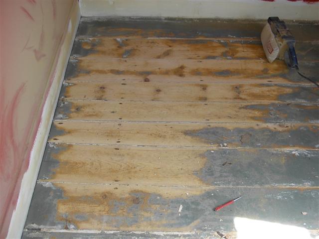

Scotty.... i appreciate the advise ! I played with the sander on a small section yesterday with 36 grit. It did OK, but i do think i may try a small section with the next grit down (somewhere around 28 grit or so?) , as some of the floor boards have a fair curl to them. I did opt for the orbital sander as i read many times during my research that inexperience with a drum sander will destroy pine floors in the blink of an eye.
I have no desire to make the floors look new, but i DO want my old floors to look nice ! Just wanted whatever i fill the cracks with to look close to what is still there. In fact.... when i did the small room last fall.... i intentionally left a little of the grey paint (that the floor had been painted with many years ago) in the dents because i felt it gave the floor a more rustic look.

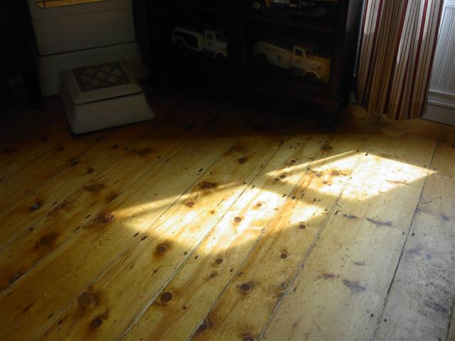

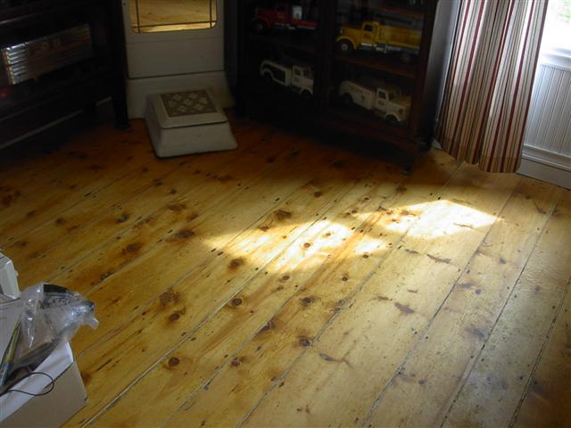

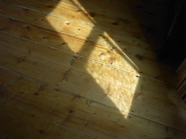

Very nice !! I learned a lesson by doing the last floor on my hands and knees, "Use a Floor Sander". But ..... it was an inexpensive,albiet labor intensive, way to see if i was going to be happy with the results. Not sure how well my pics will show, but here is the floor i did last fall. Compared to "before".... i thought it looked like a million bucks !

I looked at all your pictures and the floor you finished looks great. You must have a lot of self-satisfaction in doing the project. That looks like a lot of hard work. One thing to keep in mind on filling the cracks is that it doesn't have to match perfectly. IMO, some miss-match may appear "natural"?
