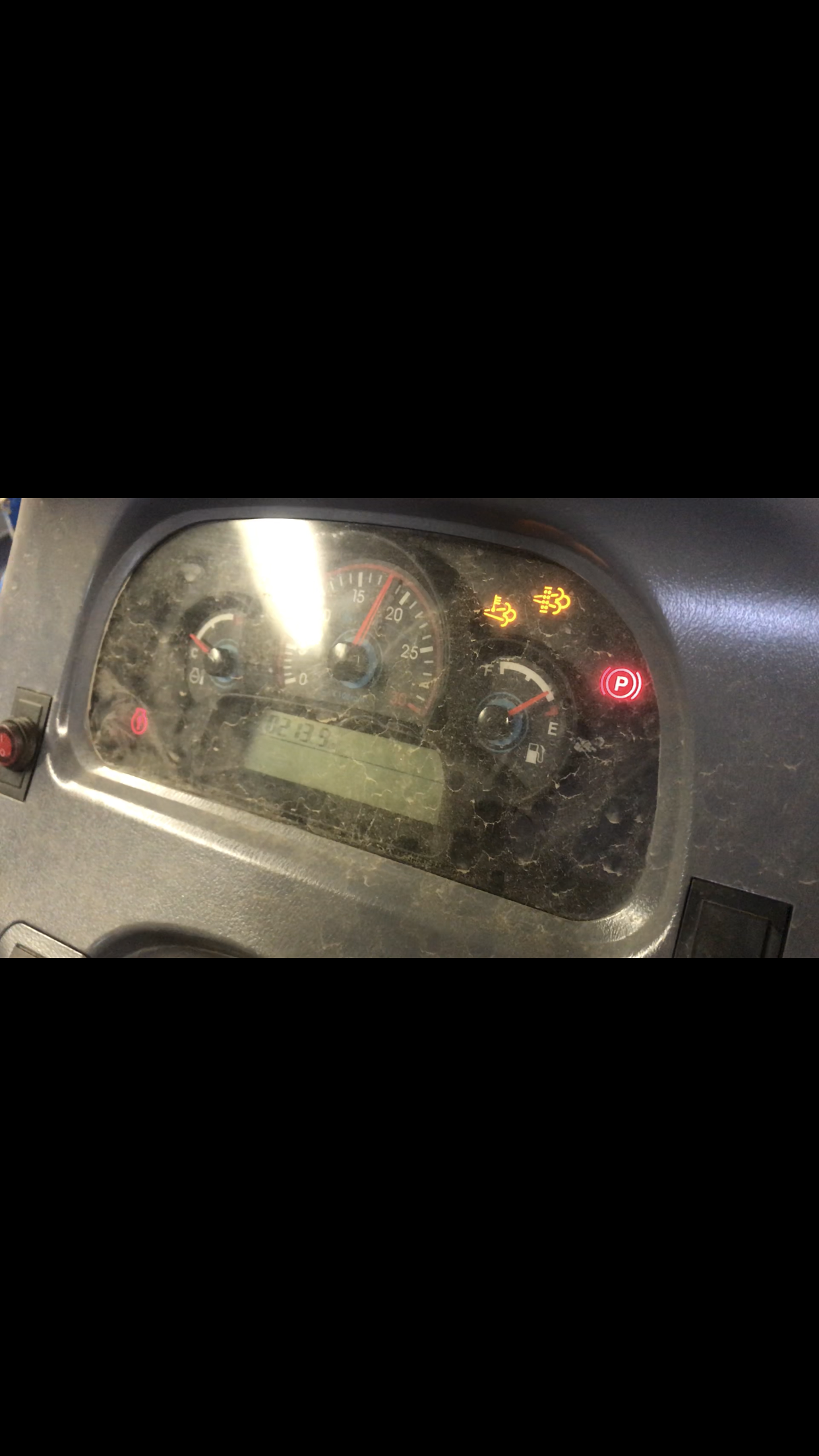

Hey guys looking for input I have a ls xg3037h and having problems with the regen anyone have similar issues or know why these lights are on? Thanks 0652055C-927C-4B99-BBEC-83FA56F7FF90.png

The one light shows its doin a burn and the other light with thurnomature (spelled wrong) is warning of hot exhaust.let it do its burn then first light will go out followed by hot exhaust light when it cools down

Yes, the 2 amber lights indicate the regen cycle is running. The red light (bottom left) along with the regen lights indicates you are running in limp mode. RPM will be limited to about 1800 until regen cycle is complete. Of course you know the red P light means the parking brake is on.
All I can suggest is what has worked for me.
1) Always use quality ULSD fuel from a reputable supplier.
2) I always operate the tractor at 2000 RPM or greater, even when just driving around. Higher RPM operation seems to produce less soot build up which reduces regen time and helps prevent it from going into limp mode.
3) Keep your air filter clean.
4) If a regen cycle starts, let it complete before shutting tractor off.
5) I got into a habit of looking at the gauges when I'm getting close to putting the tractor away for the day. If the regen lights are not lit I hold down the regen inhibit button for 3-4 seconds to prevent it from going into regen. This inhibit function will automatically reset to normal once the key is turned off. Prior to doing this it quite often seemed to start a regen cycle just as I wanted to put the tractor away and I would have to let it run at high RPM for30 minutes or so until the regen was complete. To me that is a waste of fuel and I would rather have the regen cycle do its job while I am working the tractor.

Thanks guys. Iv had it regen many times just never with the red indicator in the bottom left while the reducing power mode on. I let it regen for about 45 min and the lights all stayed the same so I got a little nervous haha

As long as the soot level is under 100% the regen cycle can proceed without going into limp mode so you may not notice the regen lights on the dash and can continue working the tractor. When the soot level gets between 100-140% is when the tractor will go into limp mode which limits the RPM to1800 until the cycle is complete. If the soot level gets above 140% the tractor may shut down completely and require a trip to the dealer to clean the DPF and get it restarted.
