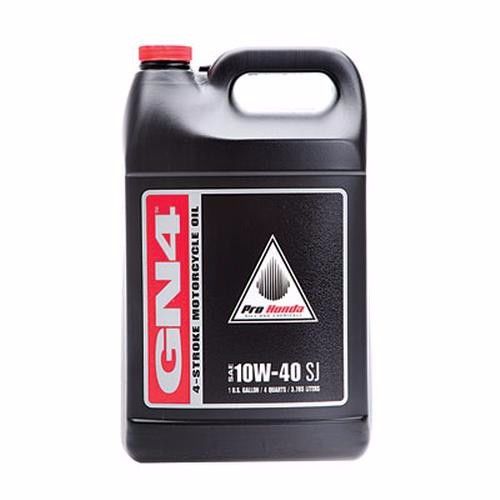

Run Honda oil in my Rancher ATV. Reason being that the Honda oil is API spec'ed SG. I believe this is the last spec before friction fighters were introduced to passenger vehicles. In this case it is the lack of additives for the wet clutch instead of extra additives.

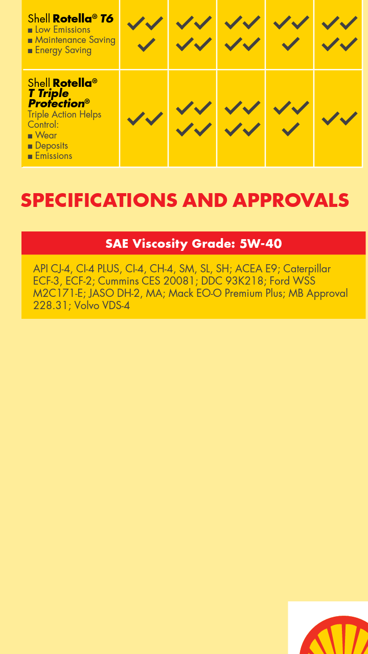

Rotella T6 5W40 is JASO spec oil, makes it wet clutch friendly.
JASO is all you need to look for on the bottle.
