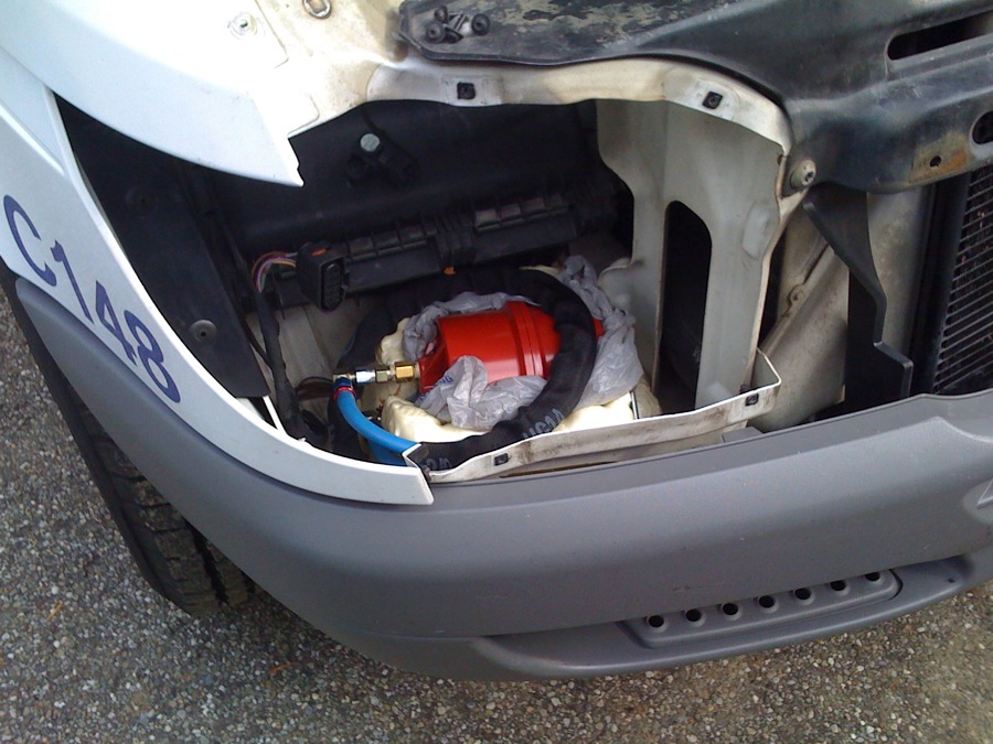

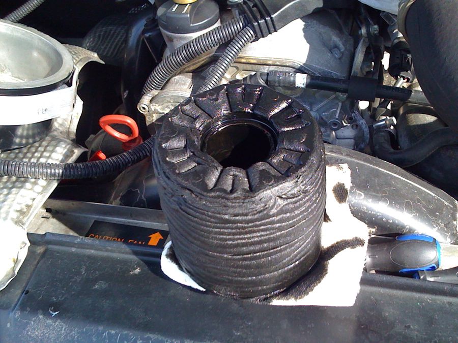

A bypass filter basically takes a small portion of the overall oil stream and constantly filters to a very, very fine degree ...... as opposed to a full-flow primary filter, which filters the entire oil stream, but not to as nearly a fine a degree. Here's a short article from Blackstone that describes bypass filtration:
Bypass Oil Filtration
There are a number of companies that offer and market bypass filtration systems commercially - here are a few:
Amsoil Bypass Filtration
Filtration Solutions Worldwide
Gulf Coast Filters
ECO Micro Filters
and of course, Frantz:
We Filter It
Or one can roll their own using any variety of filter housings and elements (McMaster-Carr has a wide variety of elements and housings)
Personally, I initially choose to go with a specially modified MotorGuard filter housing (either an M30 or M45 ... don't recall offhand):
MotorGuard M30/M60
.... done by a guy out of the DFW area named Ralph Woods.
MotorGuard used to make/market filters for oil filtration back in the day, then the new management took over and didn't want anything to with oil filtration and refocused their efforts (using the same filter technology) on air filtration (I have an M45 on my plasma cutter filtering air as well :thumbsup:) - hence the need for modification, so all internal components are suitable for immersion in hot motor oil.
The MotorGuard units will filter out particles down to 1/10th of a micron ... and you can't beat the fact that the filtration media is readily available almost anywhere ... and is dirt cheap (less than a buck :laughing:)
Here's a picture of the MotorGuard unit on my Sprinter, opened for element change and a picture of the "element" itself :laughing::

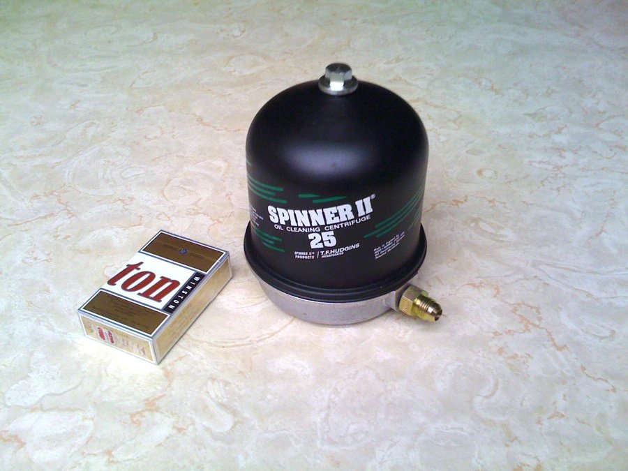

Currently both units are off the vehicle, until I can reconfigure things. The MotorGuard unit filtering the engine oil will be replaced with one of these (see attached image) - to reduce servicing.
It's a centrifuge which is driven by pressurized oil.
The MotorGuard will probably be repurposed to the B2910 Kubota ... or the Cummins in my pickup (although it really doesn't get driven enough to even bother with it :D)
