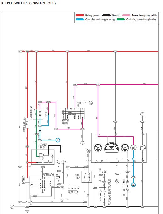

Here is some more diagram.

If the starter relay is not energized the most likely culprit is the key switch itself, as they are notorious for failure, especially if they get any water in them. But it still could be other things..as you can see yourself on the schematic. Yes it could be the relay still, but in 40+ years of doing this, I have learned about a fella named Murphey. and if it aint one thing it is two. Sure it could be the simple solution, but sometimes life hands you a raw deal, and it is multiple things. I guess I am a "glass half empty" kind of guy. But lets do the simple stuff first..test that relay.

One small part that is often overlooked when dealing with multiple relay failures is the Flyback diode.
When the coil inside a starter solenoid is activated or deactivated it generates a high voltage pulse of electricity called, in technical terms, ``back EMF or electromotive force.``
Manufacturers in recent years have provided a diode to bleed off this voltage so that nothing else is damaged. Usually the damage is done to a small relay used to activate the starter solenoid.
The biggest challenge is finding the diode in the wiring harness. Youtube will have lots of examples on testing diodes.
The first image is a small portion of the Kioti wiring diagram showing the diode.
The second image if from a Kohler powered zero turn mower also showing the diode.
Hope this may give you one more thing to check out.

Yeah, I know what those diodes are, but I sure as heck don't know Where they are. Logically it would be on the coil of the relay, but I am not sure if thats where they are or they are in the harness somewhere.
