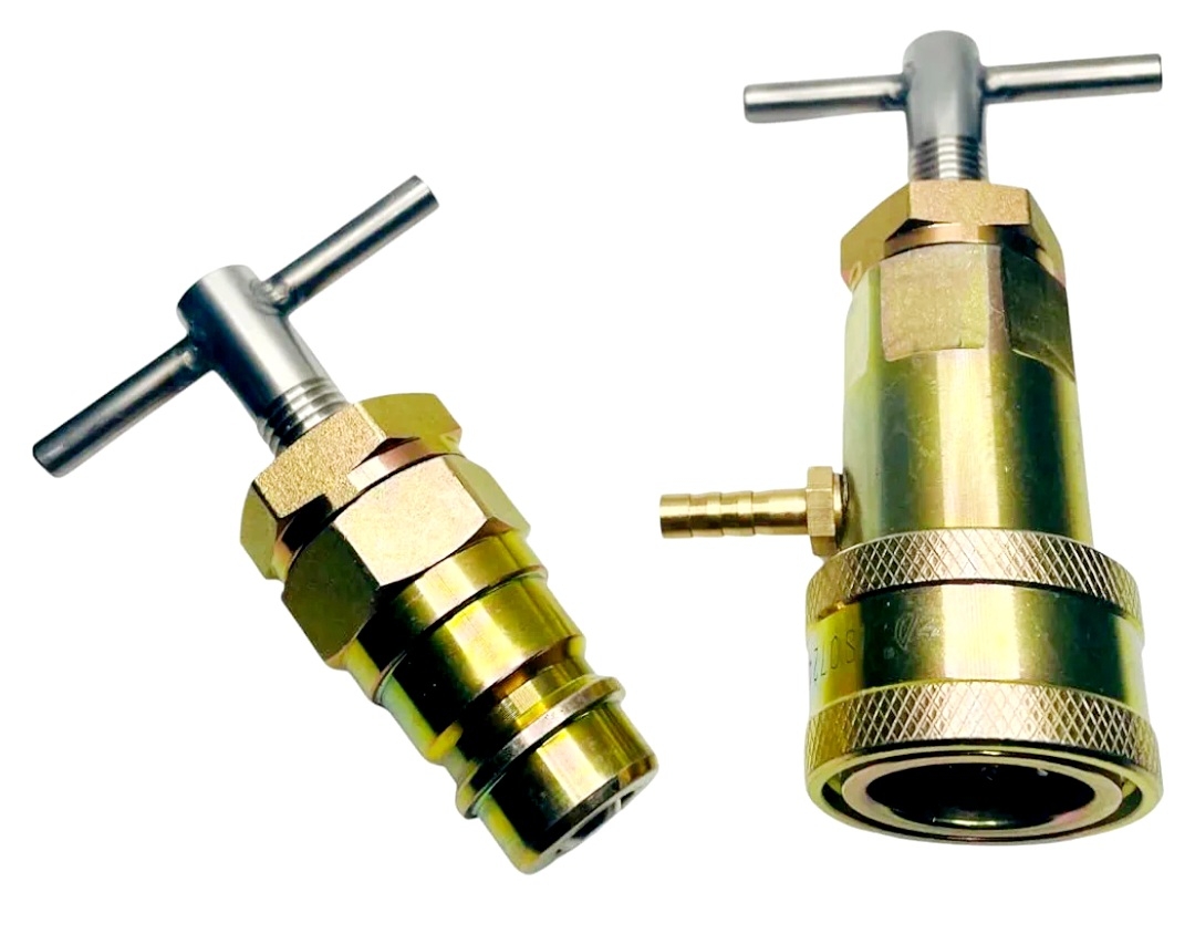

What are your method for this? I took my grapple off one cold snowy night. Today it's about 20 degrees warmer and the sun is beating down: the fluid had expanded enough so that I had to crack the lines (loosen the QA) to let fluid bleed out.
Has anybody found a better way to relieve excess pressure when putting on an implement?
I had similar issues last year when taking the grapple and FEL cutter off in cool temps and trying to reconnect then in the afternoon when it was 90°+
I tried most of the above mentioned tricks, but most of the time I was either having to crack open fittings a bit or use the hammer method to relieve pressure.
I finally broke down and bought these pressure relief tools, no issues since (not for everyone and I know this is a love/hate topic, but I'm lazy) 😎

^ Yep that's the one I saw, though it was well after I had made my own.
Got a set of those, myself. I would recommend them.
