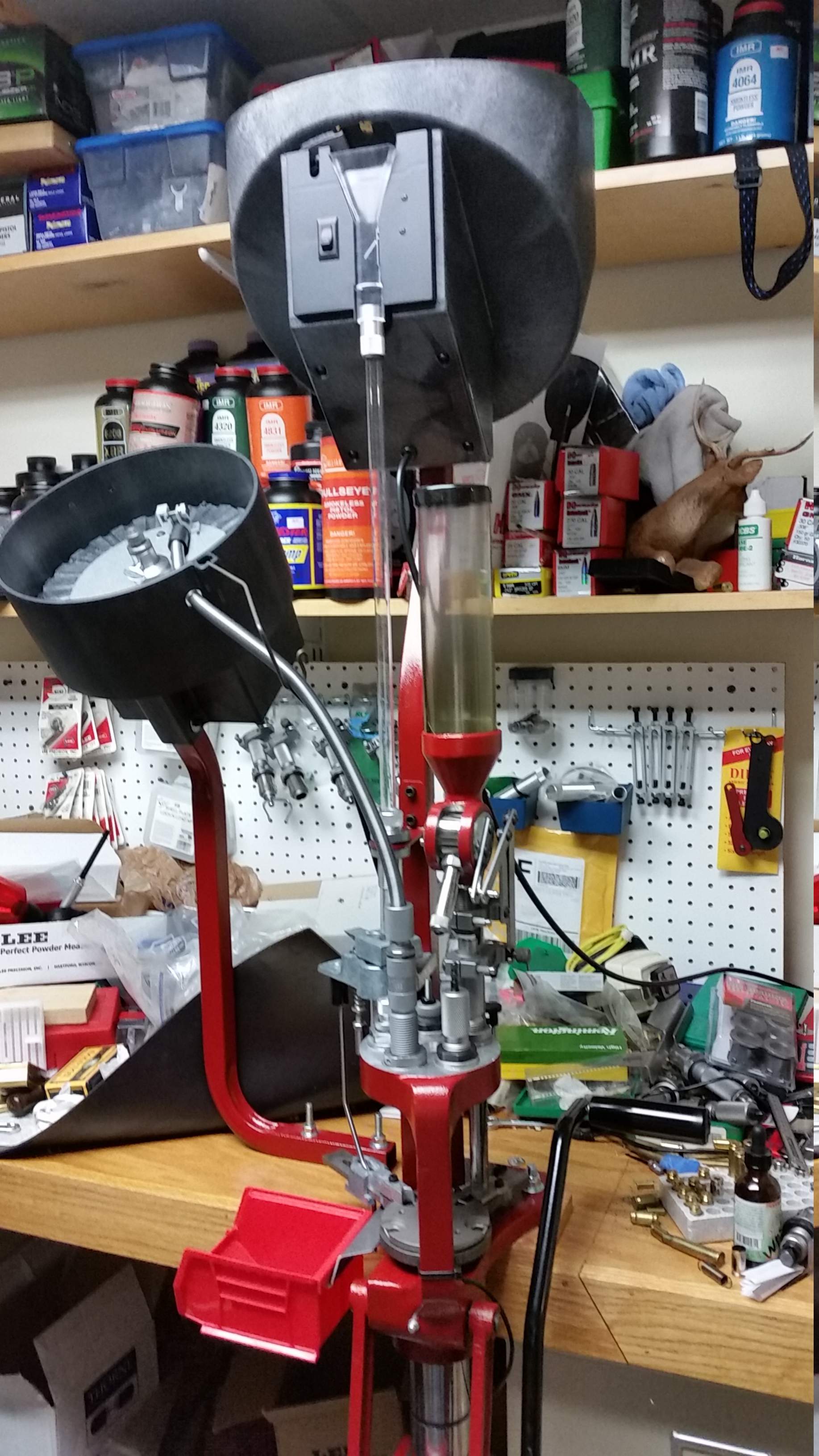

I then upgraded to a Hornady LNL progressive that I slowly added things to over the years ... it now has the case & bullet feeder. Our gun club holds a bunch of NRA Action pistol matches and most guys have the Dillon 650 or the 1050 (handy if you shoot military brass as it has a built in primer pocket swager). One friend has the 650 with the Mr. Bullet bullet feeder and it is a very nice setup.
Since I'm into hunting and reload for a lot of rifles too, I did the math of tool head changes on the 650 and for me the Hornady LNL setup was cheaper. If you are only going to do a few calibers, a 650 with toolheads setup for each caliber and a case feeder (which I think comes standard with the 650) would be a good setup.
I use the RCBS lockout die on the progressive to keep out of trouble with squib's, over/under charging etc. If something is wrong, it will lock the handle of the press and get your attention quick. Very handy when you are reloading 9mm but a .380 case got in there without you knowing it!
Be safe!
   / Reloading ammo #14
... I know how you guys like pics so here she is:
... my reloading bench is pretty messy and needs cleaned up.
