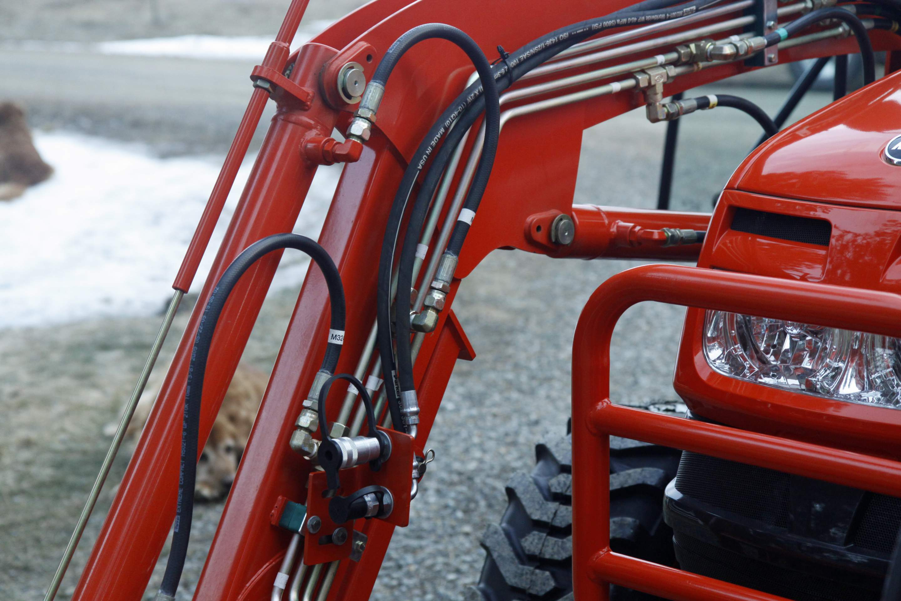

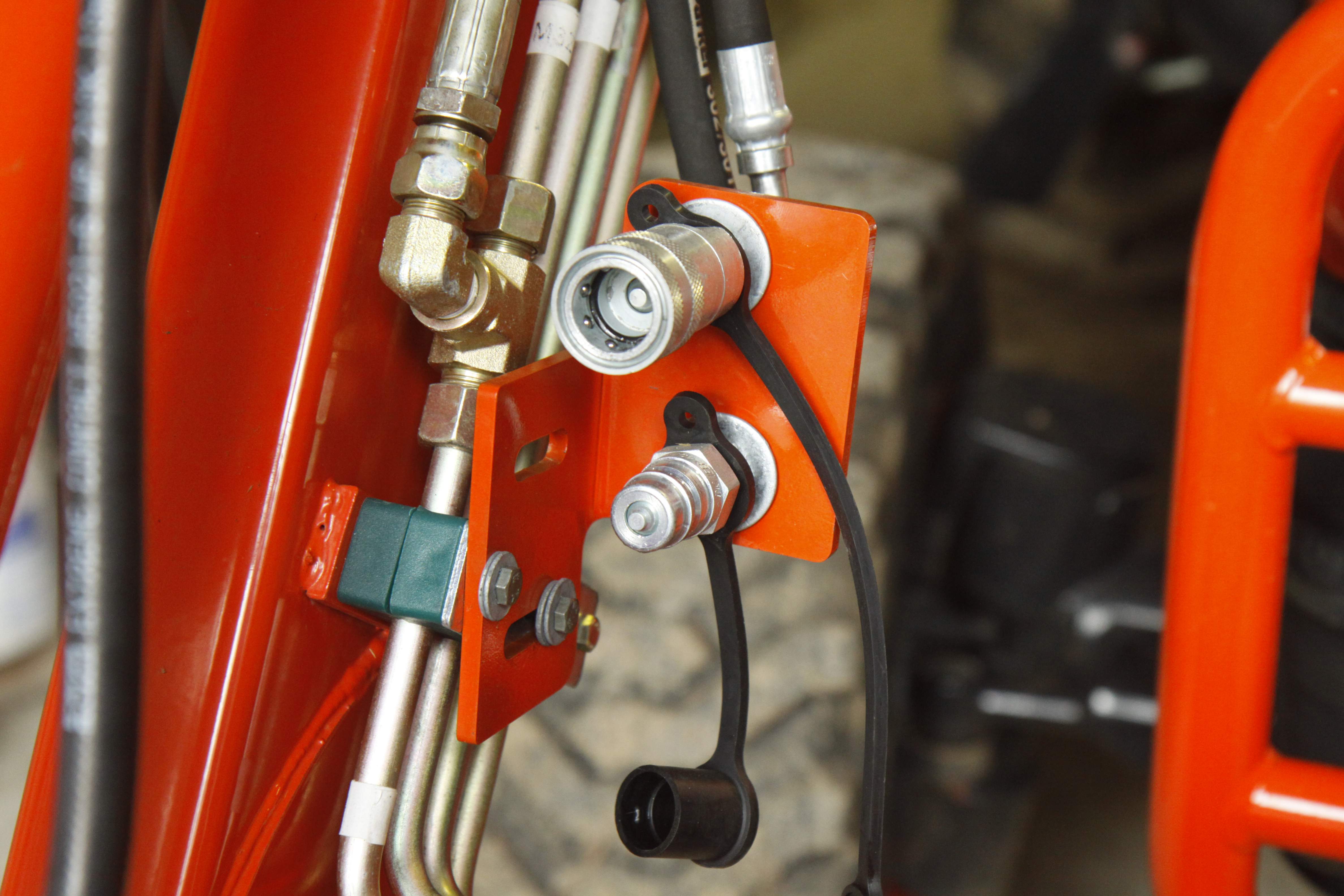

add a set of disconnects about 1/2 way under the loader also, so you can remove the loader without having to totally remove all attachment points of the hose kit. i didnt do this originally, and when i needed to remove loader to mow field it was a real PITA. _MG_4950.jpg plow hose.jpg IMG_20150318_141633366.jpg
/ Remote Hydraulic Hoses
Hmm - in looking at your pic I see you have your lines terminating to some sort of a plate with the quick connects mounted to that. My layman's idea was just to run the hoses to the front and connect them directly to the grapple hoses - is that wrong?
