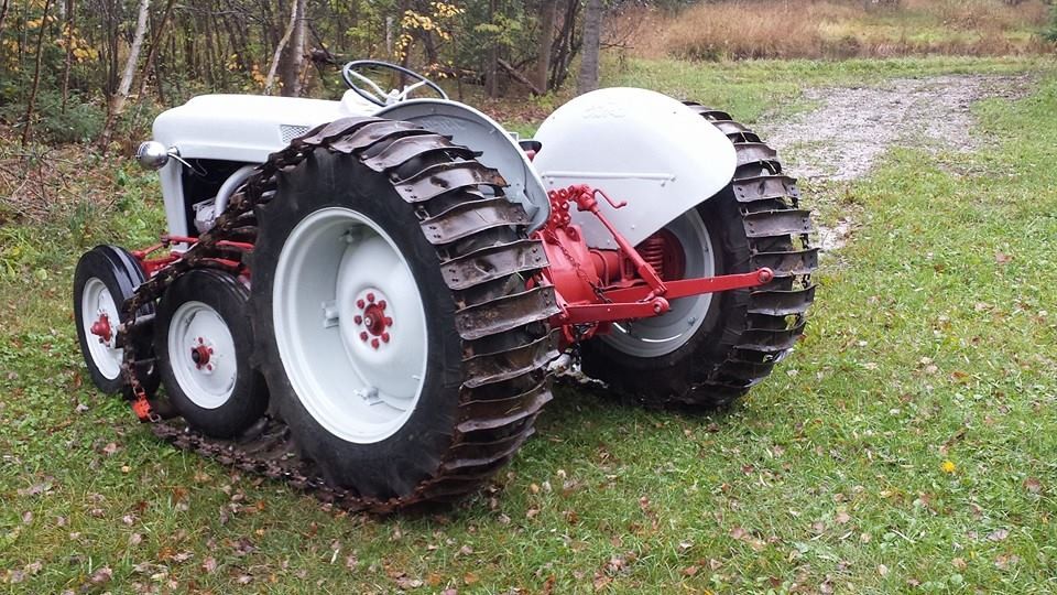

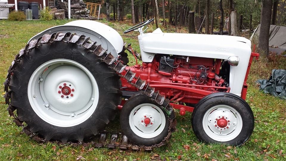

Are the tracks ARPS or bombardier?
Kirk

I am not sure who made the tracks. They may be ARPS. I know they are not Bombardier. They are all steel. I did track down the original maker of them about 10 years ago and bought out what little inventory they had. I think I got 3 new pads and about 70 - 100 links. I believe they were a Wisconsin company and when I bought those parts 10 years ago I believe they had been recently bought out by a company in Texas.
   / Remote Hydraulics on Ford NAA #15
They are ARPS. They look good on your NAA. You might want to consider straightening the radius rods out and replacing the axle pin and bushing before the axle gets all waddled out.
Kirk
