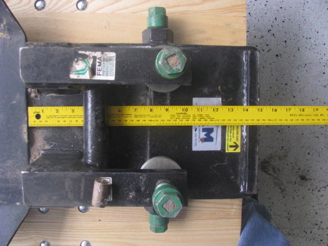

I have never had a problem with the part of the Spade which fits over the bucket. It is snug by design, independently of the clamps.
The design is near identical to that of Payne's Debris Forks, where it works equally well.
The screws take an 1-1/8" wrench and are fine thread, so you can crank the screws/pads down tight in a controlled manner.
The pads are 3"; they disburse screw force.
The only "problem" I encounter is with the small, allen head keeper screw, which runs through the pad and secures pad to the screw. It loosens occasionally and I have to tighten it or the pad will fall off when bolts are unscrewed. (Same "problem" with my clamp-on Payne's Debris Forks.)
I have used med-force "blue" Loctite on the keeper, but it has not held, probably because the female threads are dusty. I am going to try two-part metal epoxy next.
A minor but irritating assembly shortcoming. Keeper should have Loctitie applied at the factory to clean surfaces.

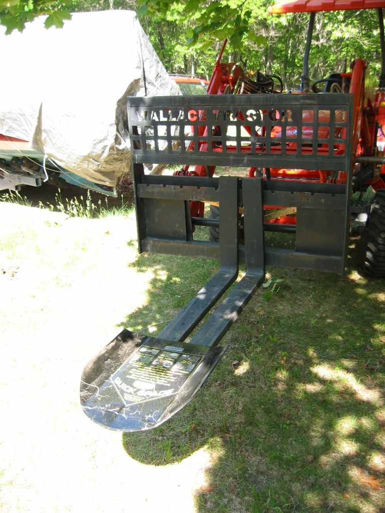

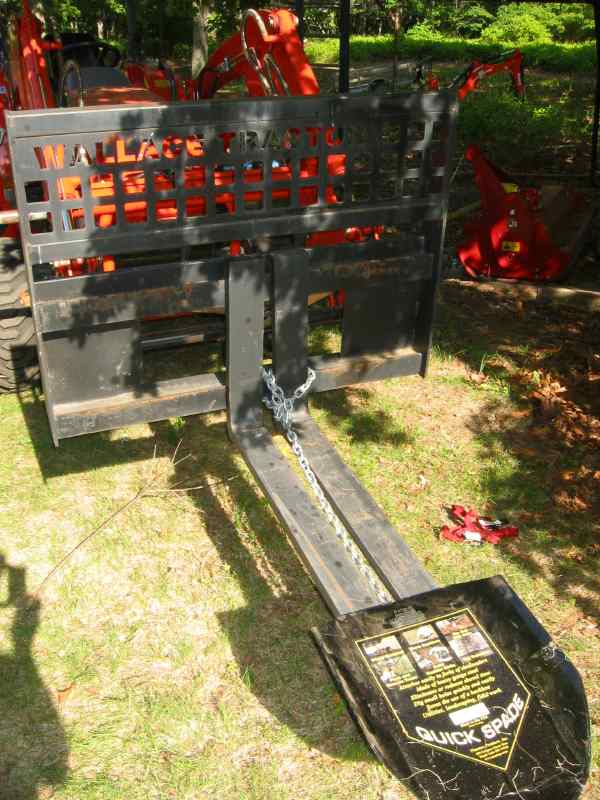

I have a similar product that is designed to fit on the end of forks. Works well. The same device is available in a version that works either directly on the bucket or mounted on forks like mine. With the fork mounted version I can dig about four feet down.
It is certainly not a replacement for a backhoe on a big job but given the two major limitations are digging depth and the need to pivot the tractor constantly to dump the spoils, it is still a very useful tool/implement for doing smallish to medium sized jobs that would end up being done by hand and shovel otherwise. I'd guesstimate it is about five times as fast as digging by hand and for some things like getting through roots or rocks much faster. Bottom line for me is that the spade digs more easily than I can with my foot and back and each spade full is about half a dozen human spadefuls of dirt. That plus the fact that I get to supervise the digging from my perch on the tractor seat!:thumbsup:
