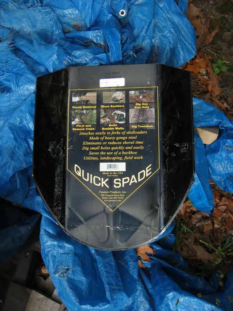

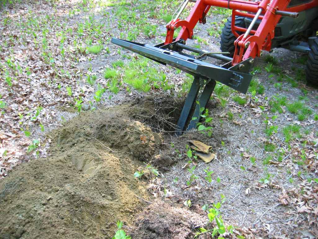

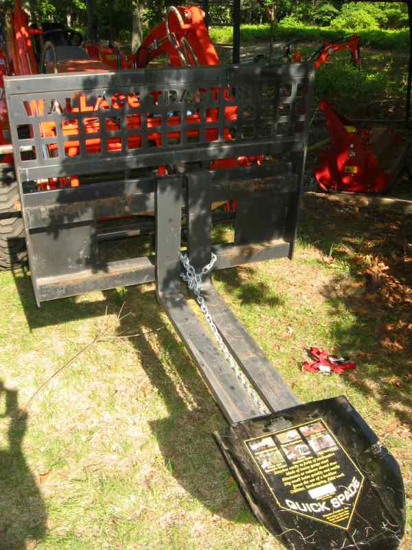

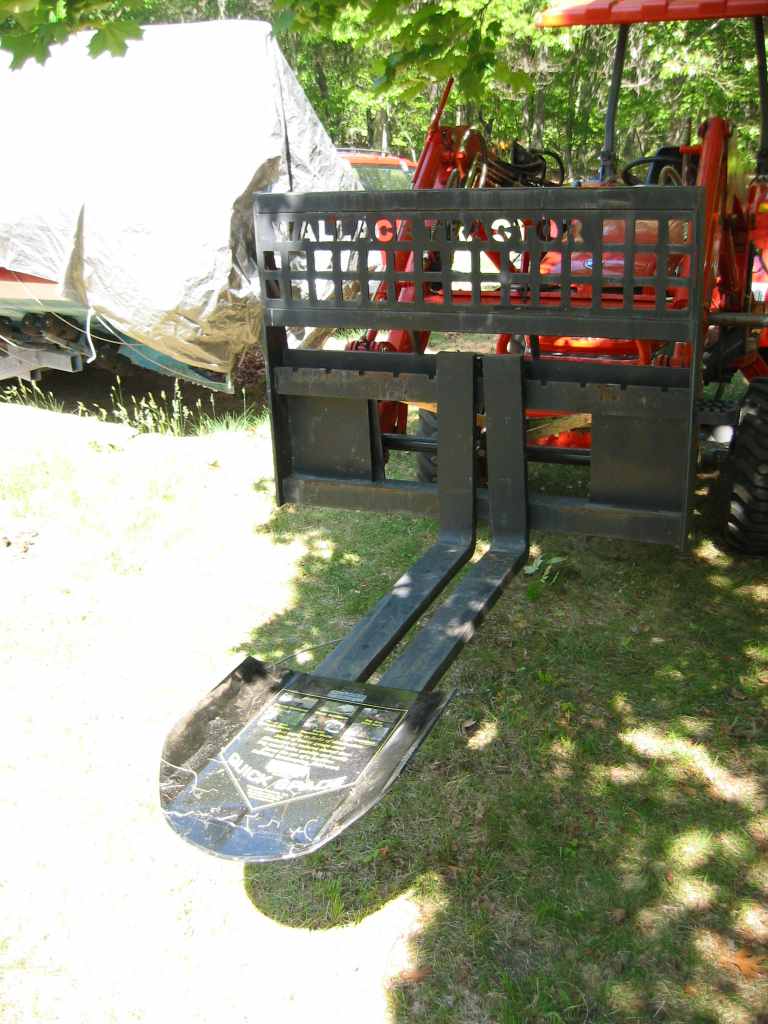

You're much better off having a spade attached directly to the lift arms rather than the bucket. 1. you can see what you're doing. 2 you don't risk twisting your bucket. 3. you don't lose lifting power and have as much stress on the tilt cylinders. Spades are used on skid steers all the time. There is another type of spade as well that is basically a big "U shaped cutting edge with a totally open back. Then you don't have to carry as much dirt. If you scoop out a tree or a stump, etc., you use the spade like a cradle to carry it where you want. You can either tilt forward or tilt backward to dump it.
I wouldn't twist my bucket. Can't go removing the bucket either, I plan to dig ahead a little then remove the spade. Use the bucket a little, then put the spade back on. Has to be quick-attach. THis way I move across the hillside. Unit may weigh 50-100 lbs, sounds reasonable, even on a BX:cool:.
