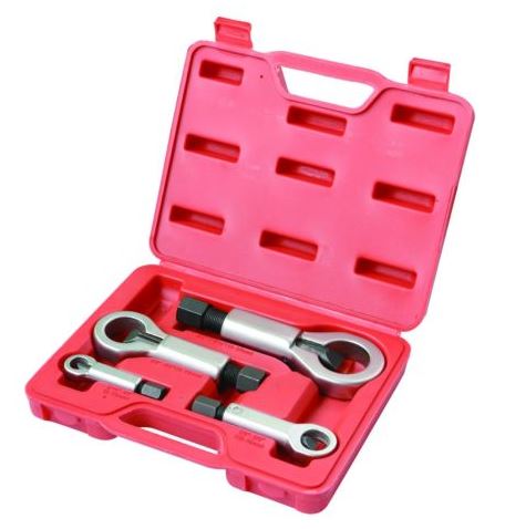

HF didn't have the 1/2" in stock. They had a spot on the shelf but no product. Sounds like a new order is on the boat... And, of course, my 1/2 impact didn't faze the stupid nuts! Tried heating them (one of them anyway) up and still nothing. I'd been soaking them for days.

Forget the impact wrench. Get a nut splitter kit. They are fantastic things and much cheaper than a rattle gun. You dont have to split the nut. Just apply pressure to a couple of facets of the nut and it will break the bond so the the nut will come off easily with an ordinary spanner. You can usually re-use the nut afterwards. I have used these on 'salt penetrated' nuts that were so rusted that no amount of heat or soaking or rattling would remove.

Not sure if I could get one of these in there, working above the stump-jumper plate. Might be time to start thinking about dropping the plate and the blades and just taking it somewhere. Right now this is just a low priority item on my huge list/
Fair enough. You do need good access to use a nut splutter.
Another cheap option is to weld a socket to a piece of pipe, then use a pipe wrench (with an extension pipe if necessary) to turn the nut. Its a lot stronger than your average 1/2" socket bar.

Got the castle nut off for the stump-jumper but then wasn't able to get that off: I didn't spend a lot of time. I purchased a 1/2" NitroCat from NorthernTool and it was able to break those blade nuts/bolts loose! At first I was having doubts whether it was going to work, but, thankfully, it did it. At 1,200 ft-lbs I would think that this impact gun is likely to be able to handle just about any such nuts/bolts.
