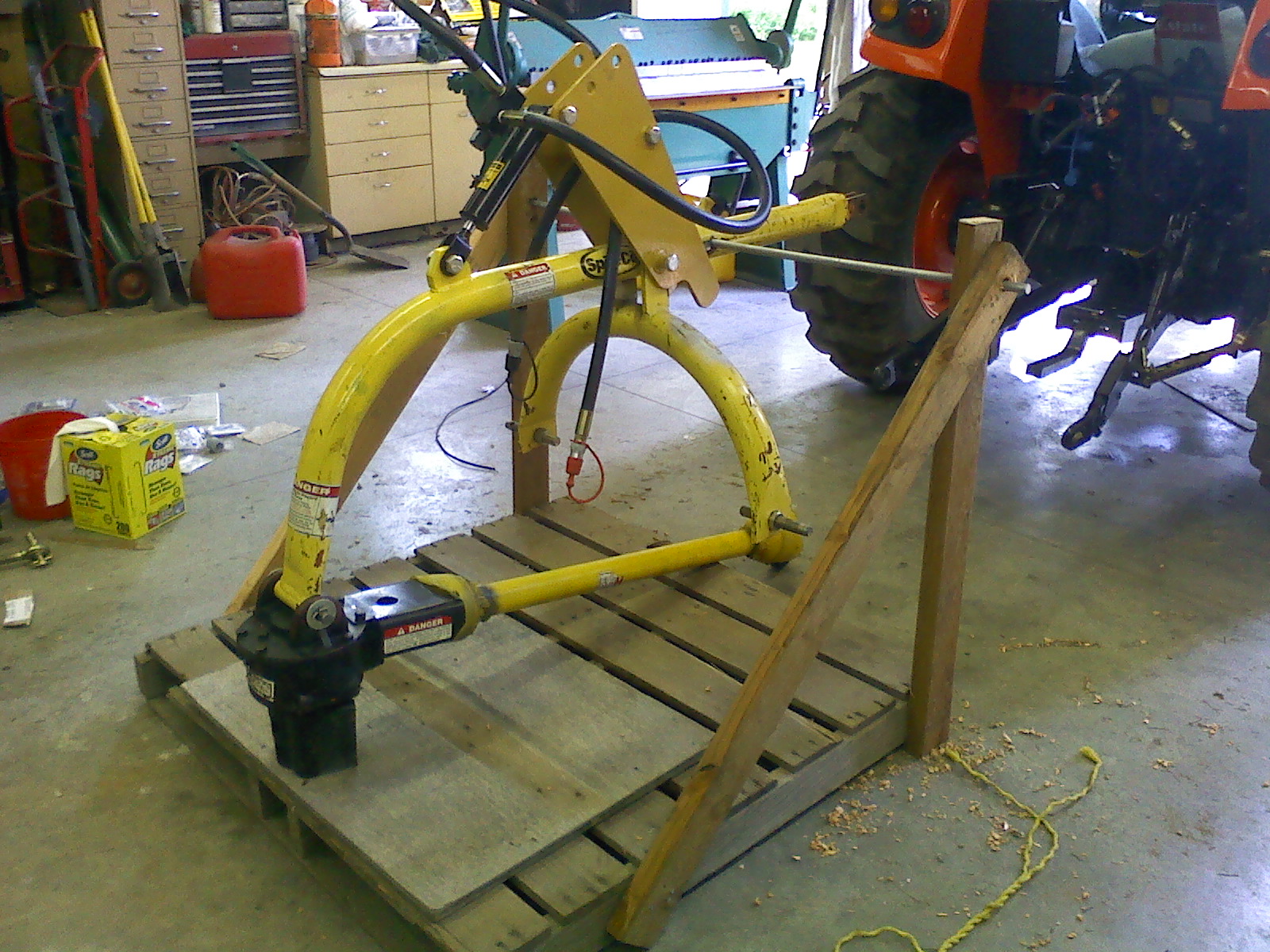

All you have to do is run slow and continually raise and lower the auger to keep the hole clear and you wont get it stuck. You may also need to move the tractor foreword or reverse a bit to keep the auger level as it goes down into the ground. These are things that get easier as you use it. I have had the misfortune to have to drill 100's of holes so its pretty easy to do nowdays...but in the beginning i also buried some augers.
My 3 point system has power assist hydraulic down pressure to help drill in my decomposed granite ground...love it.
