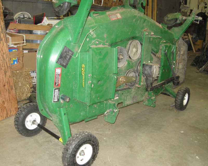

I find the mower cumbersome after I remove it, that is if I decide to move it or do routine blade sharpening.
I would like to build some kind of dolly. Maybe somebody has some Ideas about this.

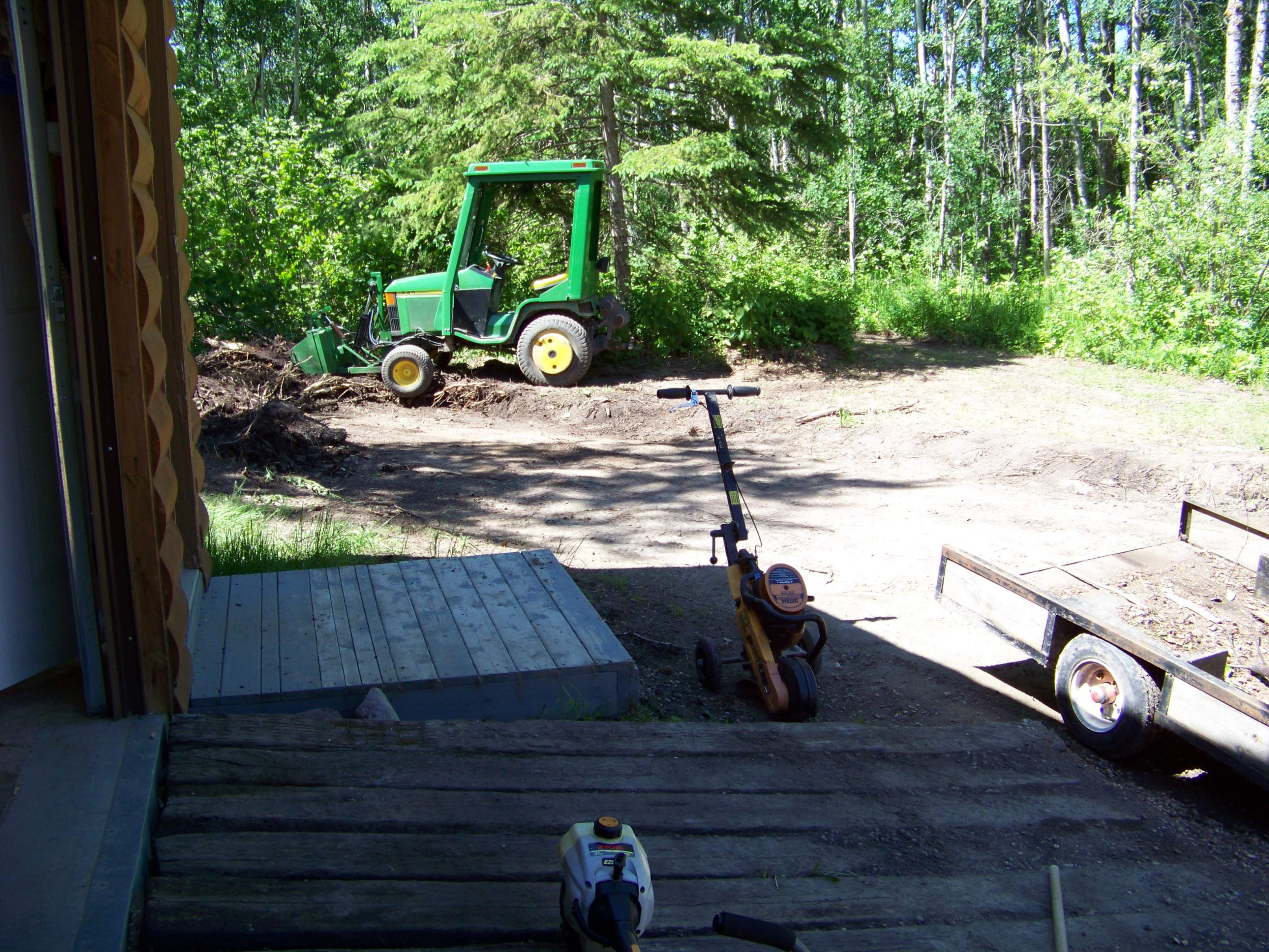

I use my mower as a bush hog. I will post a picture later. Like I said in my last post I need the clearance for stumps etc. Some people would never do what I do with a mower. But if you are careful you can cut brush. I live on 4 acres of bush. For cutting grass I use a push mower takes about 20 min. to cut the grass. For looking after my bush example keeping out dead fall etc I build trails. I also harvest some of the bigger trees. At the present time I am building a pad for my motor home. Again like I said a lot of people would not do what I do but i have done it very successfully for the last few years or at least since the tractor was new. A set of blades are quite cheap compared to a bush hog. ( Have never replaced blades yet)
I use it as a mower to keep the ditch in front of my acreage looking sharp for the neighbors as everybody in the subdivision does this. In winter I run the blade and snow blower. House and buildings are not visible from the road,the ditch just gives the place curb appeal and keeps the neighbors happy ,as the front of the acreage is lined with evergreens.

This is what I mean about rough terrain.
The tractor was referred to as a riding lawnmower??? I guess it depends how you look at it. All my landscaping has been done with this tractor.Far less damage and cleanup than with a real tractor. I guess. Thought of something bigger but it would be a waste.

Are you turning the front wheels sharp to the right when pushing the deck out? When I had that size mowers I had a hydraulic jack nearby, so I jacked the front up a few inches. If the air pressure is low in the tires that makes it almost necessary to use a jack. A smooth concrete floor helps too.
For a dolly, how about doing what this guy did?
/ Removing and Installing Mid mount mower #8
I had saved that picture, but couldn't find it. There's his solution for storing and moving the deck around if he's got a good concrete floor to work on.

I guess my biggest issue seems to be the ground conditions I do my mower installs on. I hate putting it in the garage as it takes up so much space.
I do like the dolly. Might look into building one. Thanks for the picture.

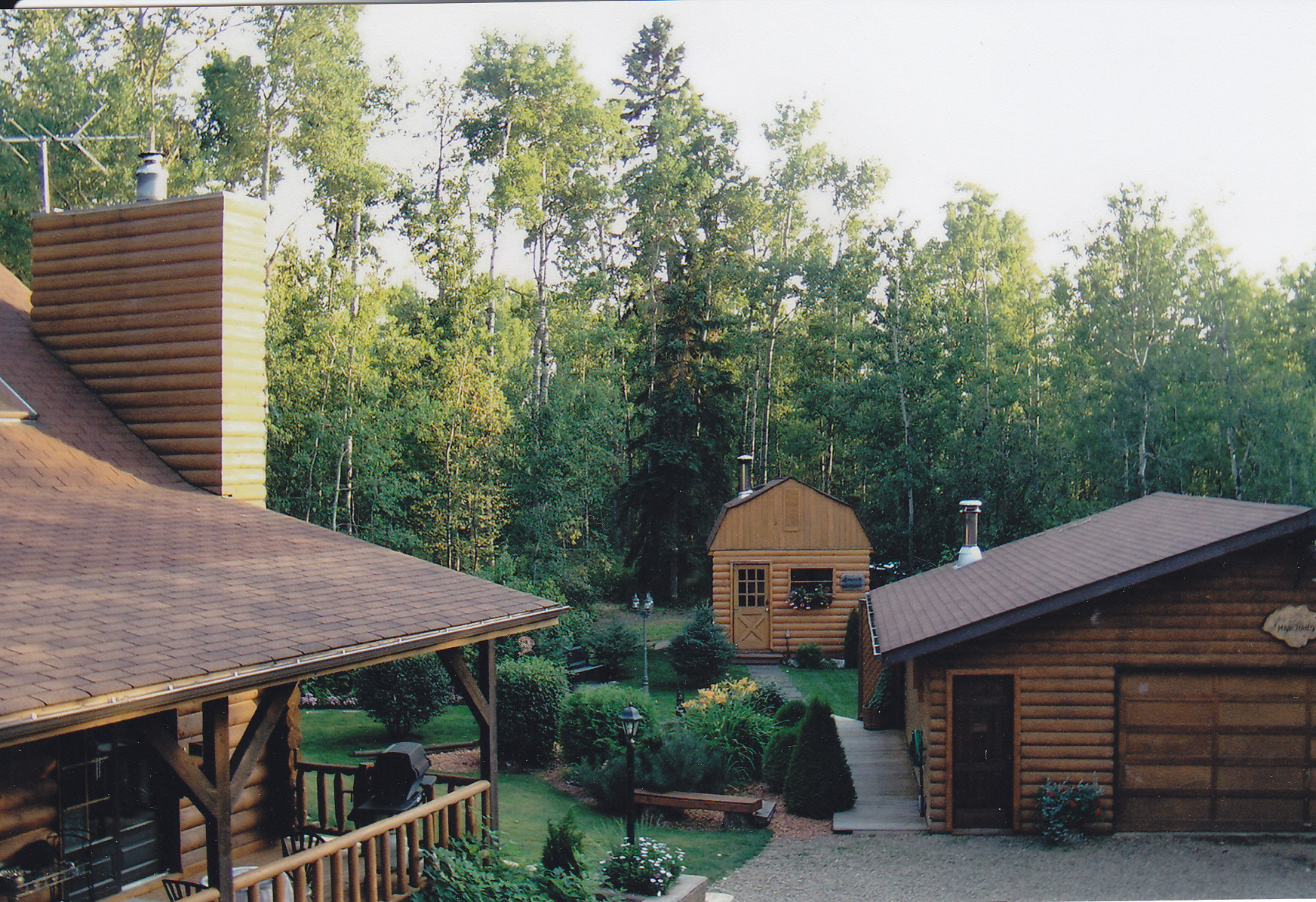

Thanks for the kind words Kevin.It has been a tough go but my wife and I think we are where we want to be. Just retired so time to enjoy.
