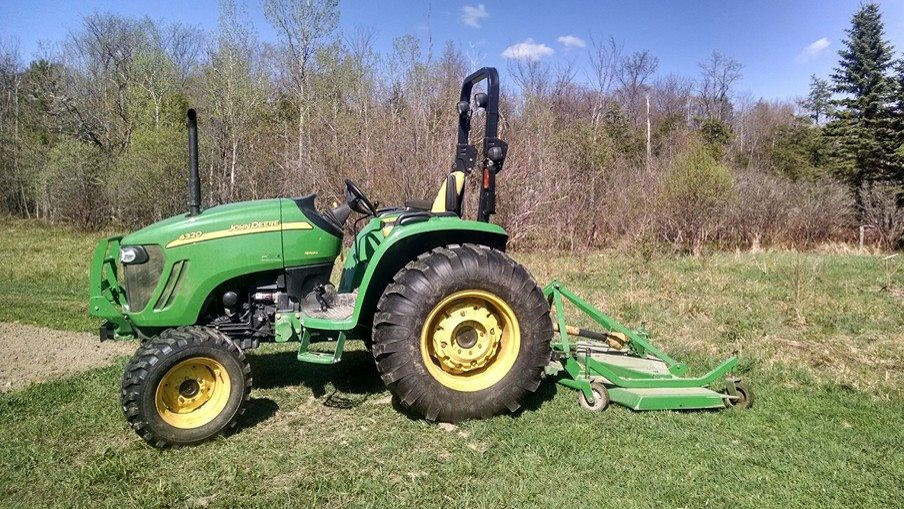

I have used both, and in my experience the MMM is an easier mow.
The things I don't like about the 3-point mower are, if you are mowing along a building, you can't just turn away from the structure. You have to make sure you clear the building. Not always possible if you have something in the way.
With the 3-point, you are mowing grass that has been run over with both front, and rear tires. The bigger the tractor the more compacted the grass will be. This will lead to uncut grass. I was using a JD 4320 and it was too much for my lawn, but it was all I had at the time. I never liked the job it did.
The 3-point was ok for keeping my field mowed, but that is where its usefulness ended. I also had a bunch more push mowing to do because it could not get into tighter spaces.
My remedy was to sell the mower, which freed up the JD for other tasks. Bought a Kubota BX2680 with 60" MMM. It will be different for everyone, but I favor the MMM for my situation.
