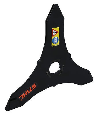

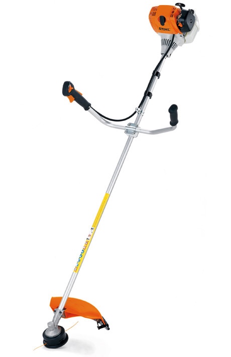

For cutting the brush, I'd suggest looking at a Clearing Saw / Brush Saw. It's like a weed whacker on steroids with bicycle-style handles. One of the optional cutters looks something like a circular saw blade. It's great for cutting woody brush and saplings. Other styles, such as the blade that looks like a giant 3-pointed ninja throwing star work well on grasses and non-woody brush.
/ Removing Brush #3
I use a Kubota B series with a 4’ medium duty LP cutter and it works on 1-2” saplings where I can take it, but for stuff where it won’t go I’ve used a Stihl FS110 cutter like John describes for many years. I tried the circular saw type blade but not for long. The 3-toothed brush blade cuts far faster for me and I’ve taken out a few miles of stuff with it. It’s actually unbelievable what it will go through quickly, and I’ve taken down pretty sizable stuff like 4” popple & firs with it with a bit of patience. You do want a harness.

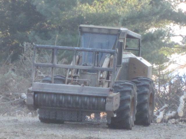

The Scotch pine in my old tree farm were dying out and I was being invaded by Buckthorn and Pokeweed. I had a tree service remove and chip about 1800 trees that had about 8-10 inch trunks on them, then, they ran this Hydro-ax over the ground that ground off all the stumps and buckthorn. I can now turn the area into a native grass area...with time.

I tried an FS560 but I can't handle it for long.
