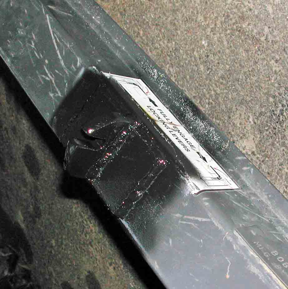

Has anyone welded hooks to their bucket? I need to decide if I'm going re-enforce the top edge or not. The rolled tube on the top edge seams very beefy. Any thoughts?
/ Removing bucket from CT230 #5
Well, I have the Bobtach and 68" bucket. Here is the hook I welded onto
the Bobtach frame. I do my other tractors in a similar way with a
reinforcement plate and a mount to the back center area. This gives
maximum lift and minimum chance of distorting the bucket, versus welding
a hook on the lip, or the sides of the bucket.
I also use 1/2" plate with a slot in it to hold the chain. This is secure
enough for grabber-style chain, yet allows you to drop the chain from
the driver's seat by curling the bucket.

Can you snap a pic of your install. I just happen to want a hook and also just happen to have some of those hooks in the basement.
