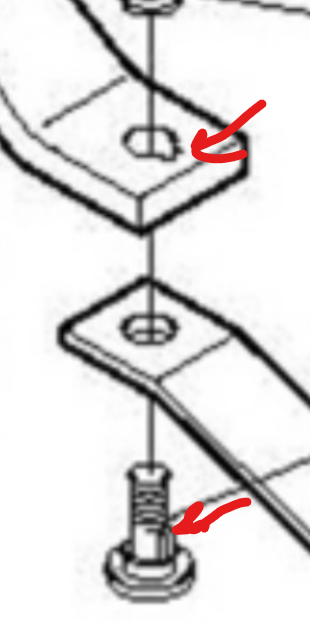

The bolt has a key formed into it that is supposed to fit in a keyway cut in the arm. It's the same as the one I used to have, and you see it on the drawing if you look just right:
If it turns, either it's dropped down so the key is out of the slot or it's sheared off.
These smaller Bush Hogs do not have the key. I have the replacement bolts and there is no key. The dealer assures me there is no key, and they cut them off with a torch when they don't spin off with an impact driver.
