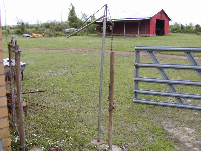

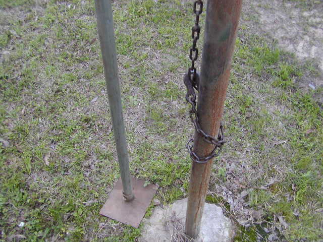

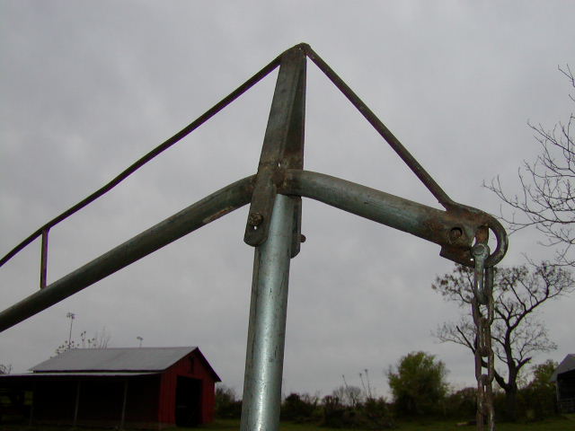

Takes up storage space about like a garden rake.
