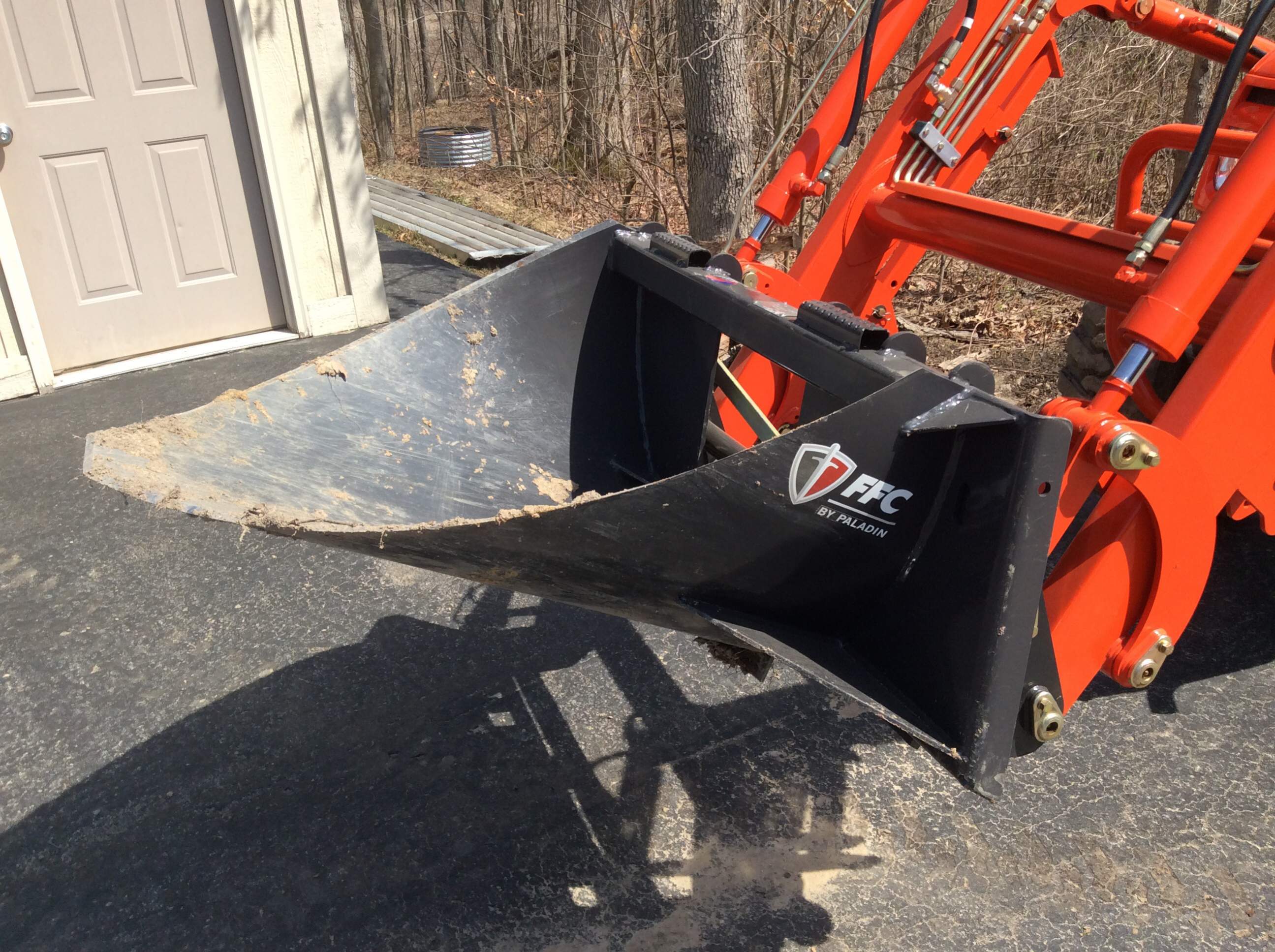

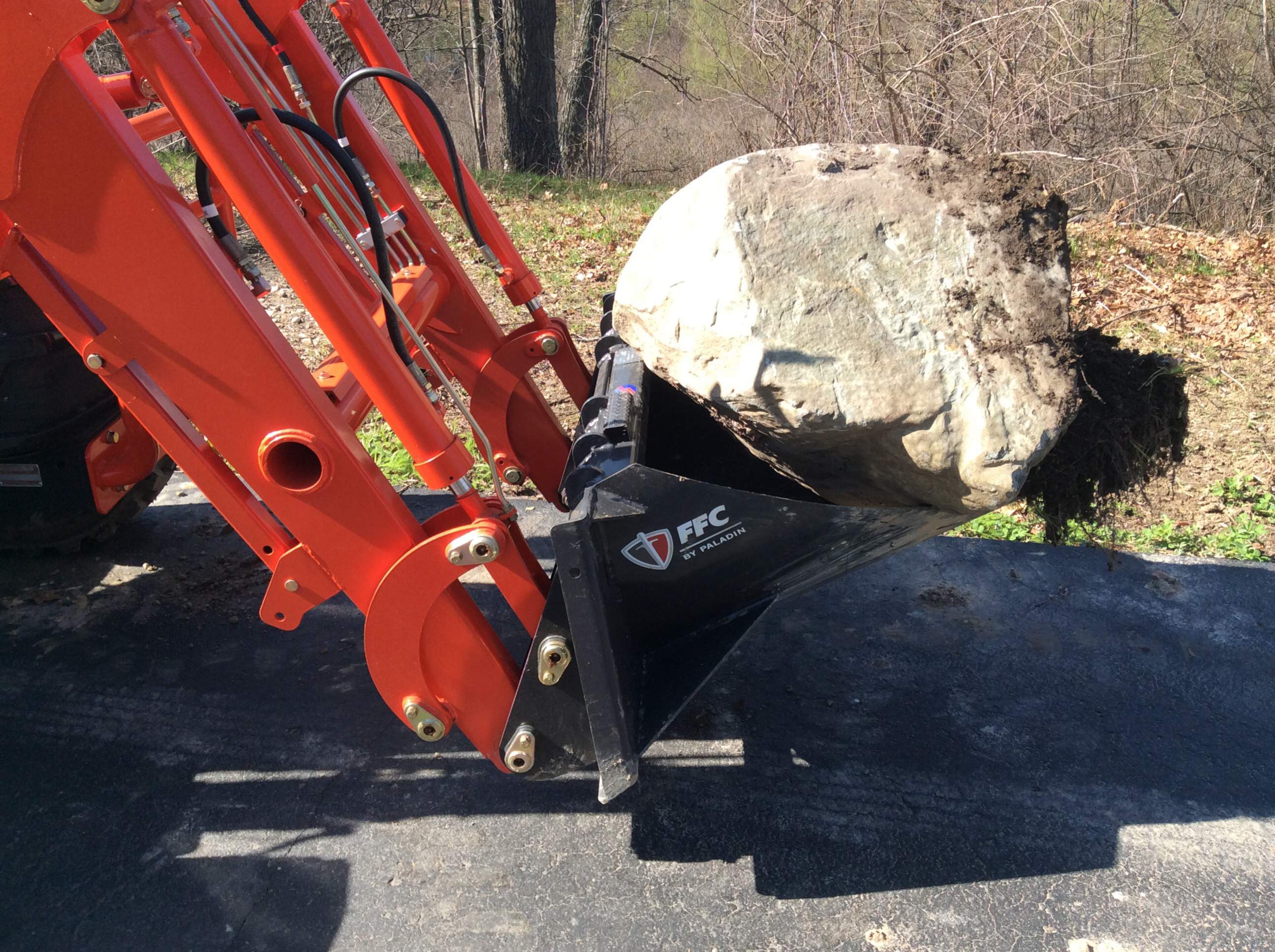

This is what I use and it works great.
Also good for landscaping and digging holes.

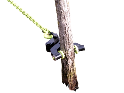

I bought one of these last year, as I lucked into a really good deal on it.
Amazon.com : Brush Grubber BG-20 Brush Grubber Xtreme Plus, Black : Lawn And Garden Towable Tools : Patio, Lawn & Garden
I've used it to pull cedars in the 2 to 4 inch size. The one problem I had using it was that the stump would break off about 18 inches up, so started pulling them near the bottom. Worked like a champ for me.
I bought one of these 3 years ago and it work like a champ. I don't remember where I got it from but know I paid less than $100 for it.
