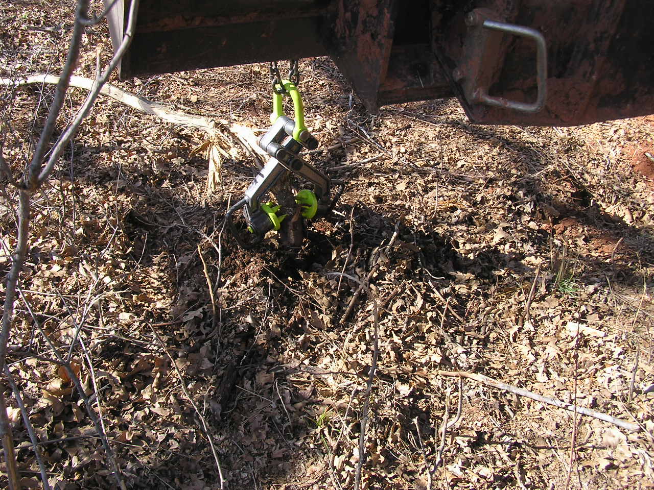

it is by no means quick. but have simply wrapped a chain about 4 times around the smaller stuff, and then hook chain back onto itself. primary goal as i lift up with FEL or pull it with tractor, the chain tightens up and has enough grip to keep a hold of things. chain does slip every now and then, and a pain to wrap chain around, and more so un-wrap chain off a tree that you have pulled out and gets caught up in things.
a old metal spare tire rim, or A frame has also been used. goal of either one, is to wrap chain or brush grubber or like right at ground level. and then lay chain over top of the spare tire rim (right up near tree), and then on back of tractor swinging draw bar or truck hitch. what it essentially does, is allow the chain to cause a pulling up force. vs a pulling over force.

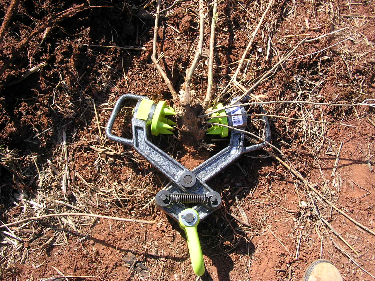

Found this at TSCstores.com - $74.99 View attachment 397568
one of these or a chain style brush grubber can be easier to use than just a plain chain. but again you want "pulling up force" not sideways force. hence a spare tire rim or an A frame.
A frame = 4x4's with a extra heavy duty latch (for like a gate or like) at the top, and then a piece of lumber between the 4x4's to hold it all together and keep the legs from spreading apart.
if you have some metal that might be better for the legs, so the ends that touch the ground, will want to sink into the ground some vs sliding across the ground, if you did not setup the A frame correctly.

These work well also
Amazon.com : Brush Grubber BG-19 Heavy Duty Clump Grubber : Lawn And Garden Towable Tools : Patio, Lawn & Garden

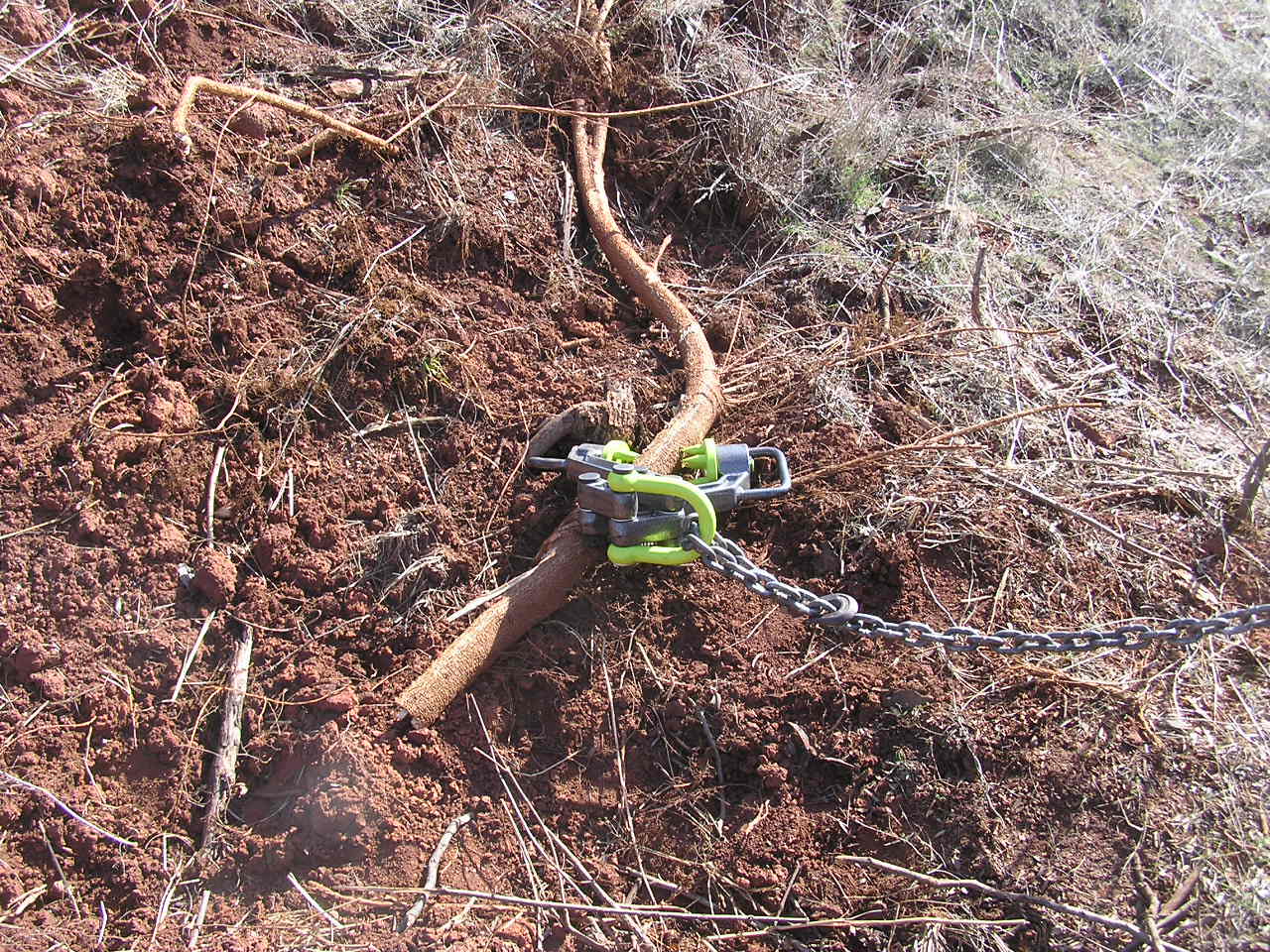

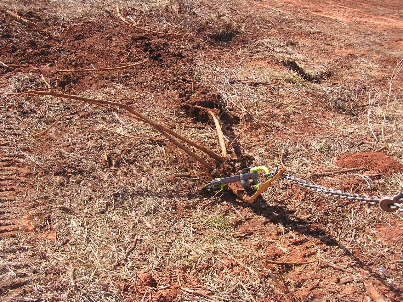

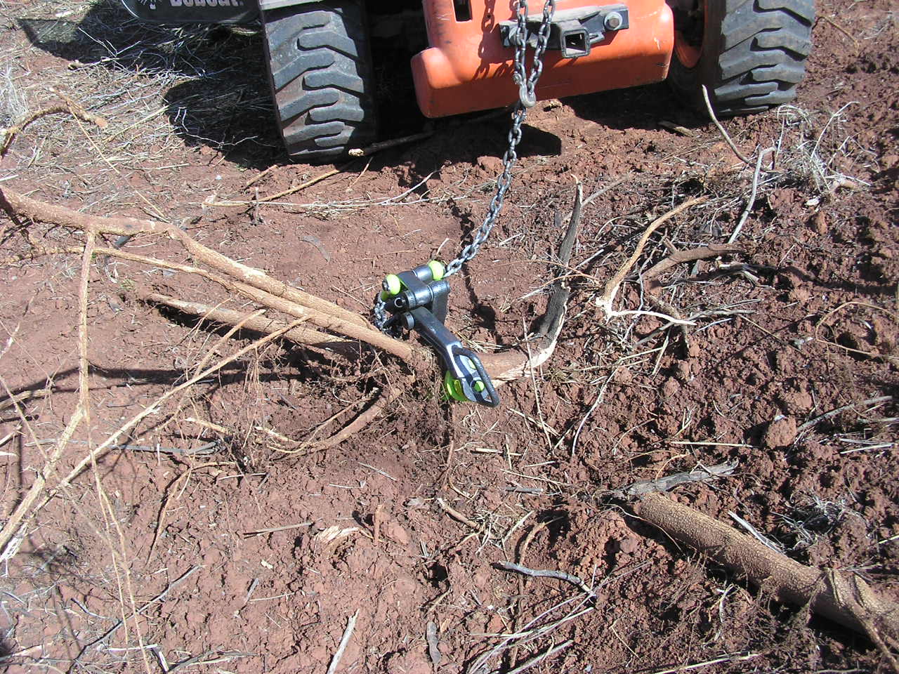

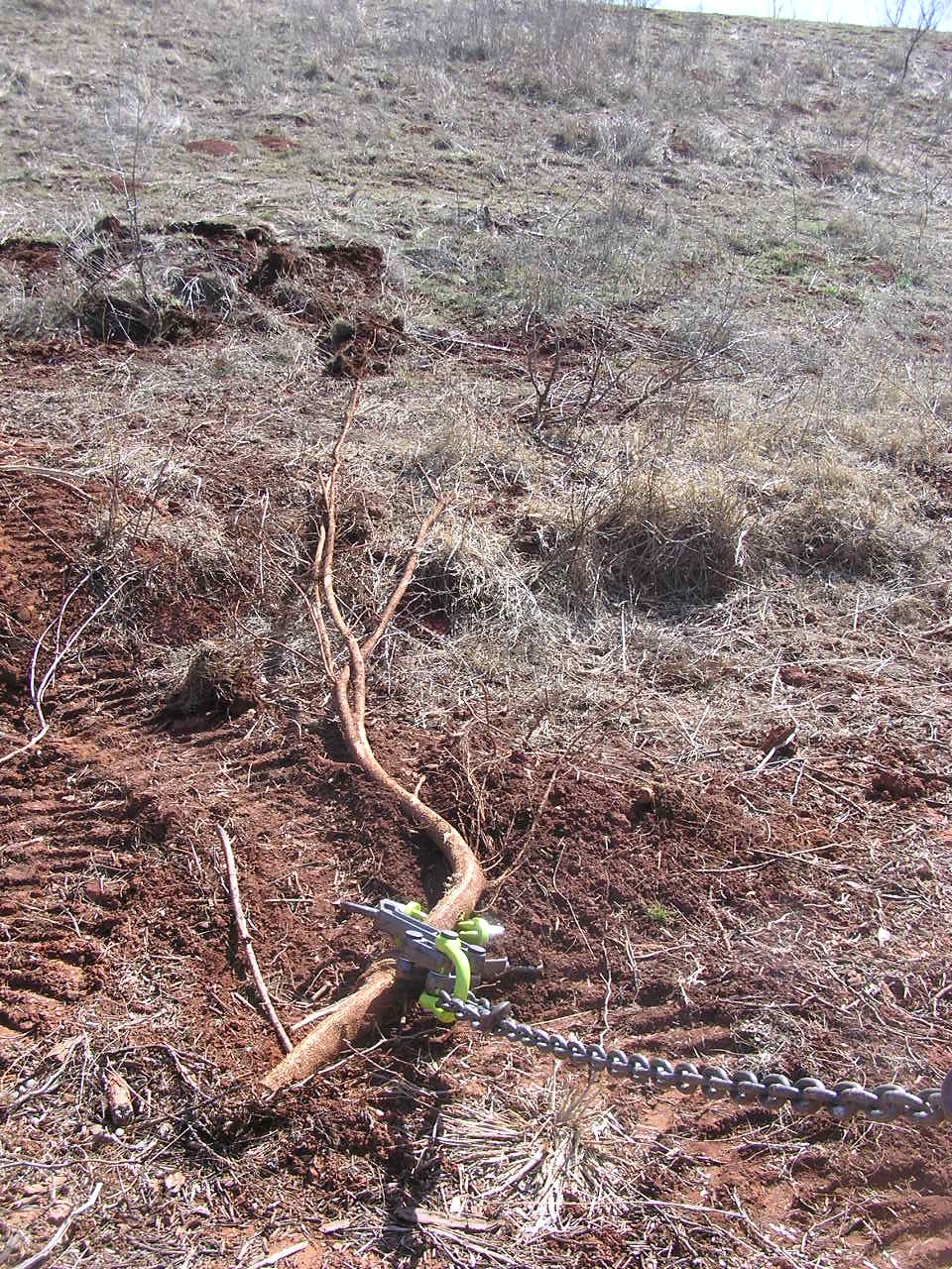

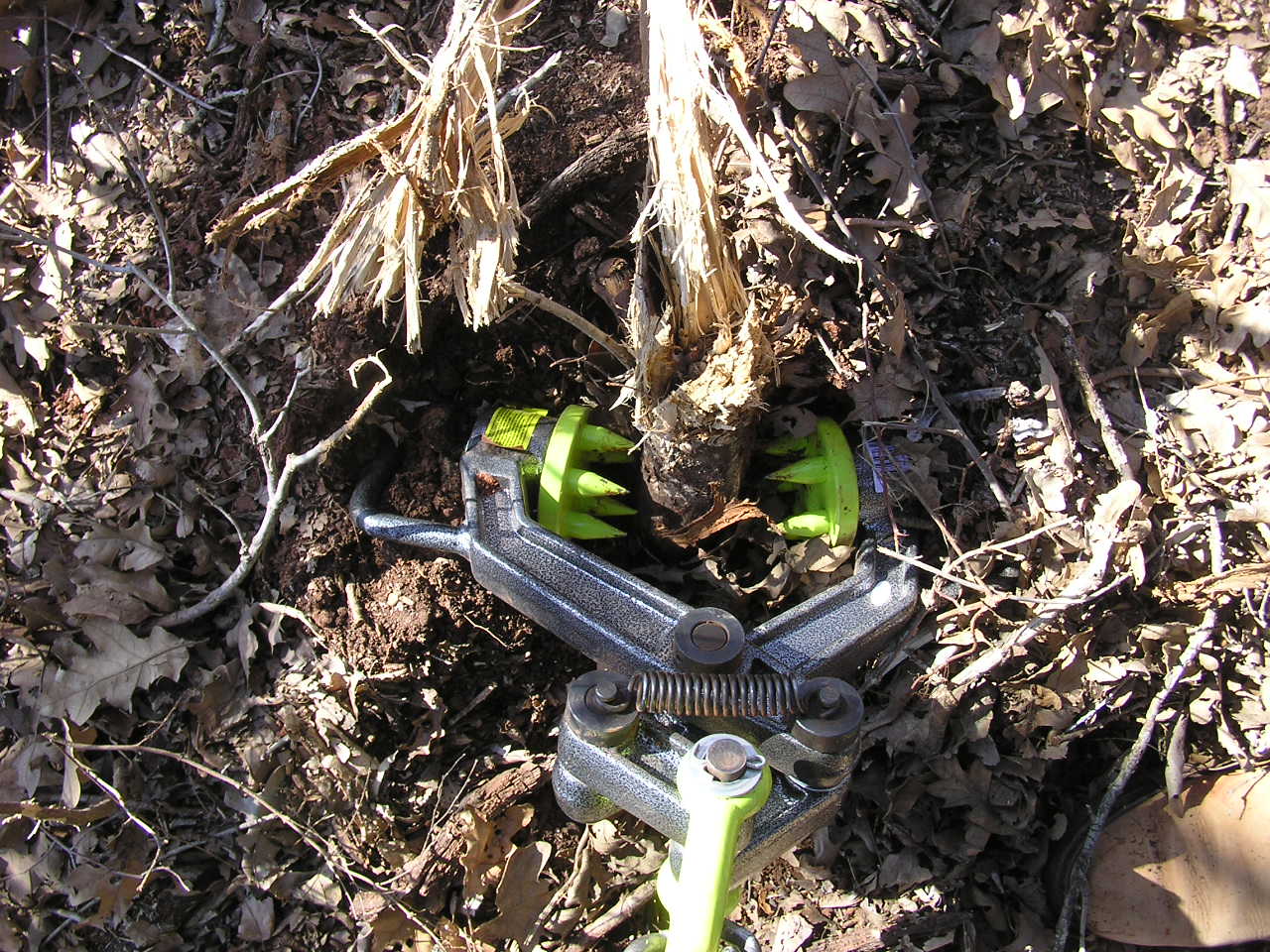

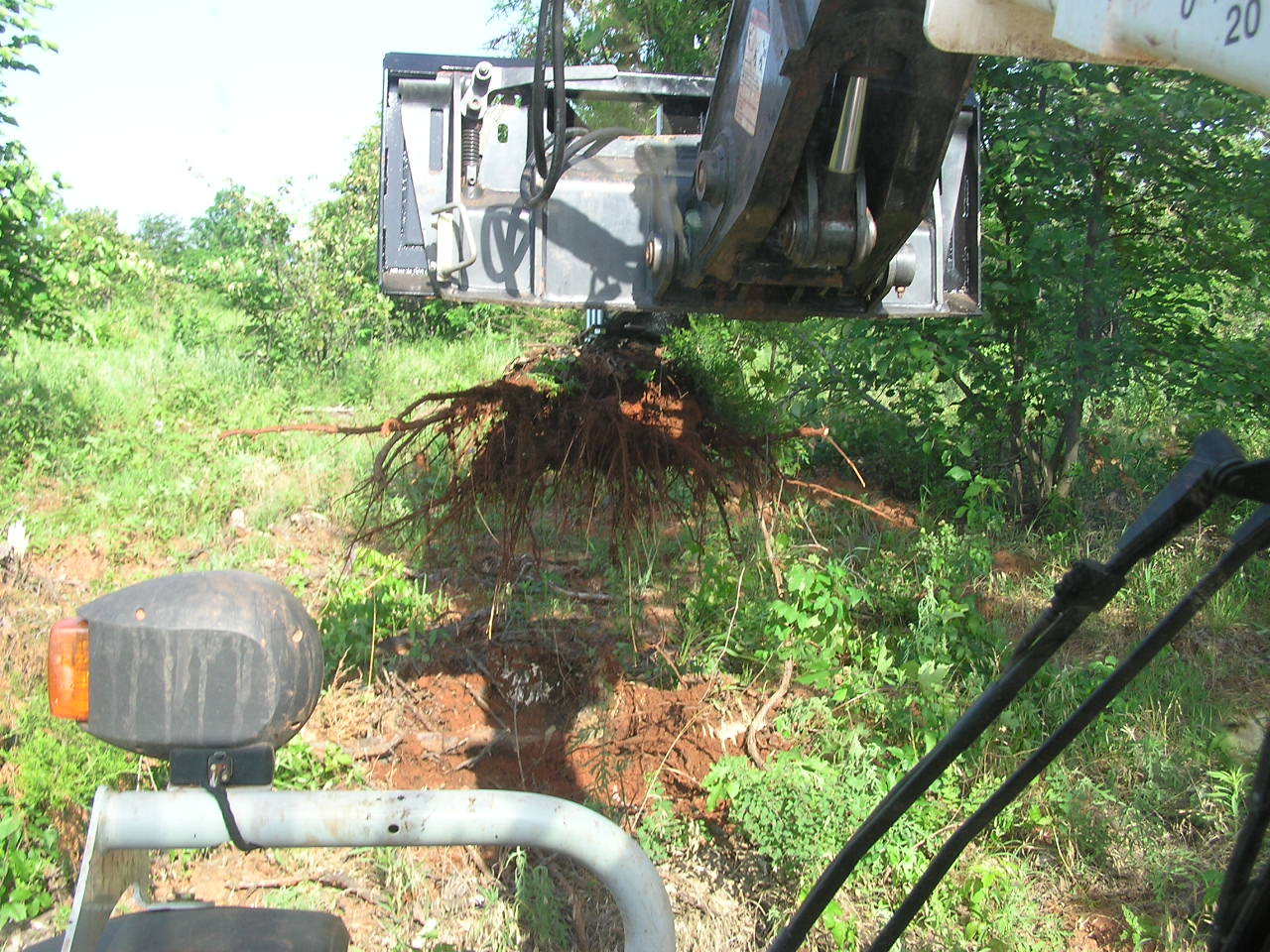

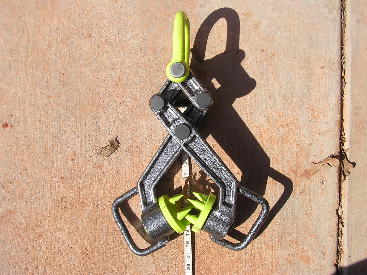

I have the BG20, it weighs 35 pounds. Works good on roots and short stumps that would be hard to wrap a chain around.

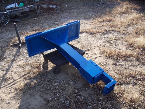

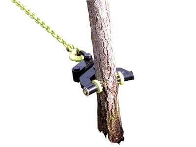

Something like this should work for just about anything you have.

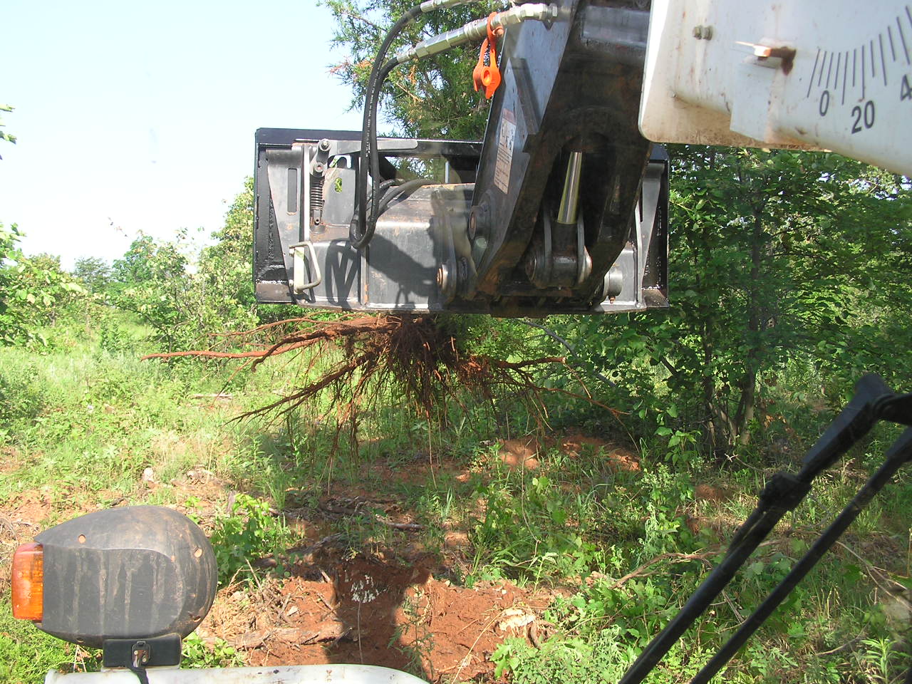

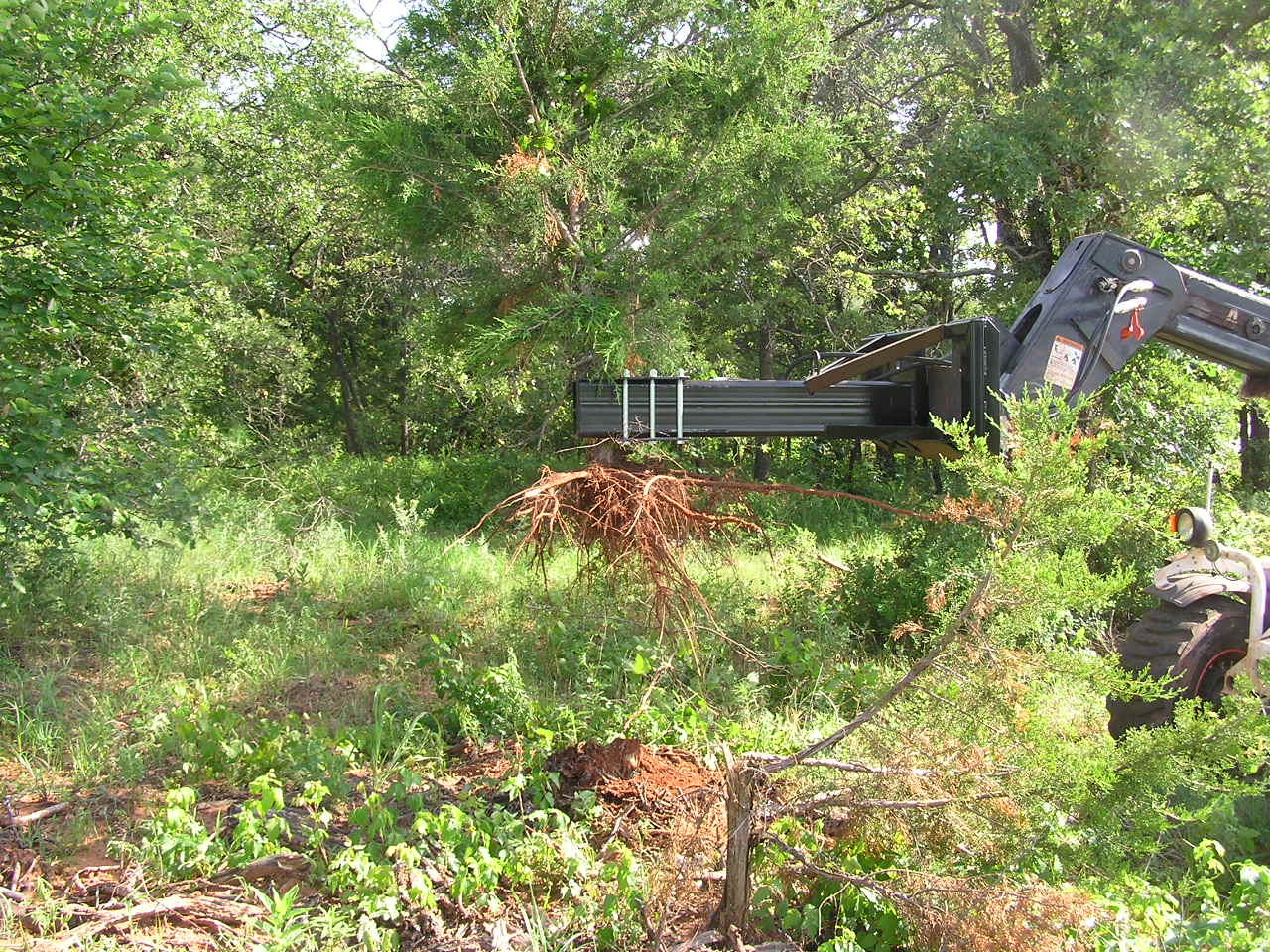

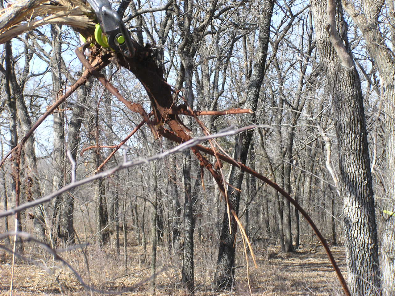

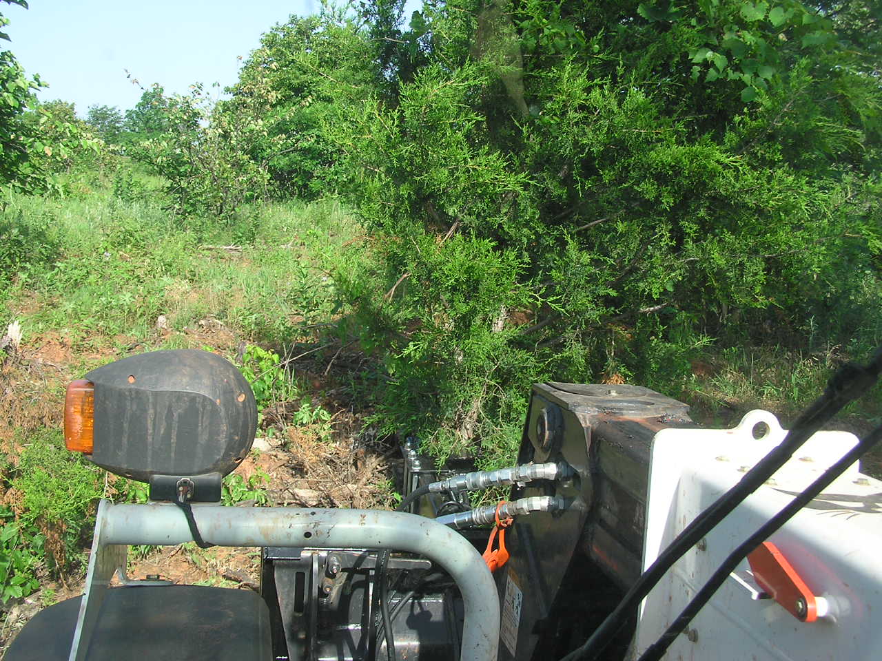

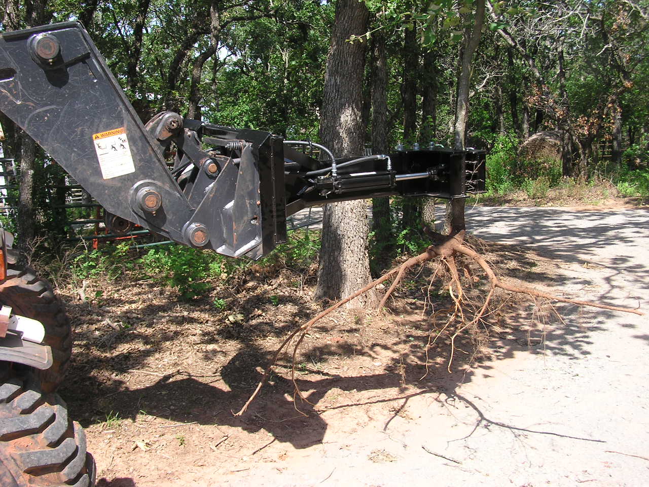

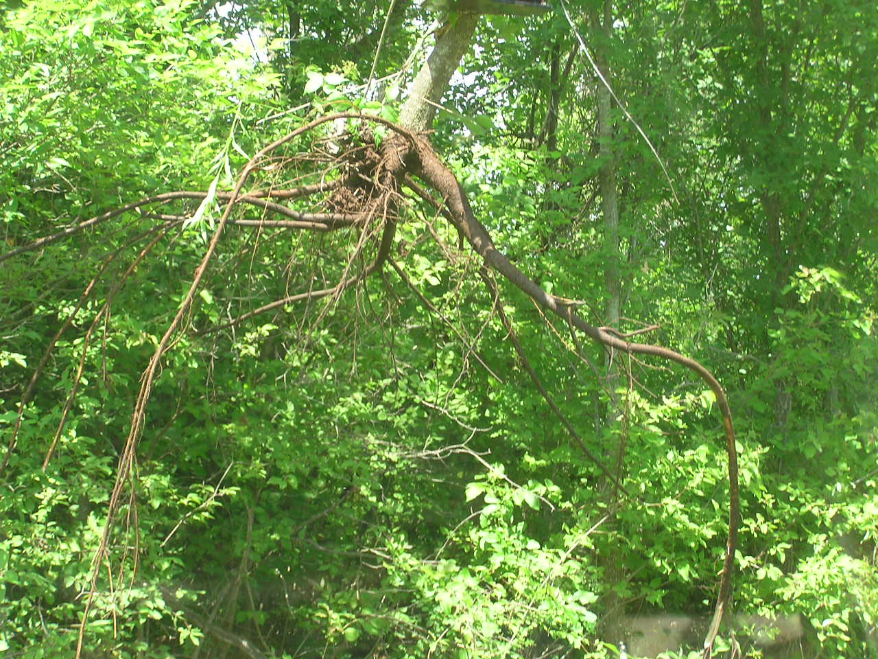

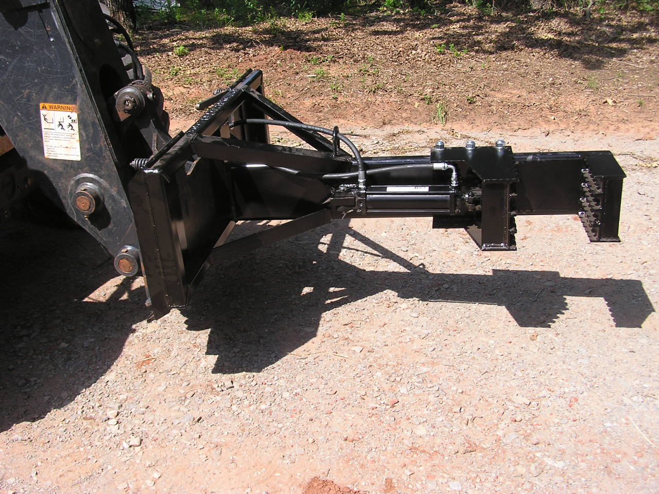

Yep, the Brush Grubber is too heavy for me to use for very long, so I got the Long Arm Tree Puller.
Pulled a cedar tree took picture, then shook the dirt from the roots.
Sure is nice to pull trees without having to get off the seat! :thumbsup:

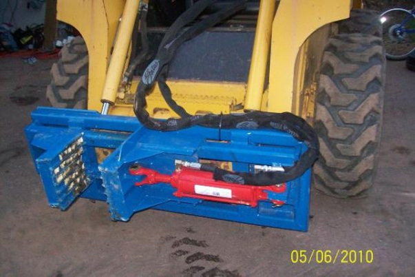

Buckthorn Puller - Custom built Skid Steer attachments to fit almost any need you may have.
Quote from their Website: All pullers can be built to fit any machine, or even a 3 point hitch.

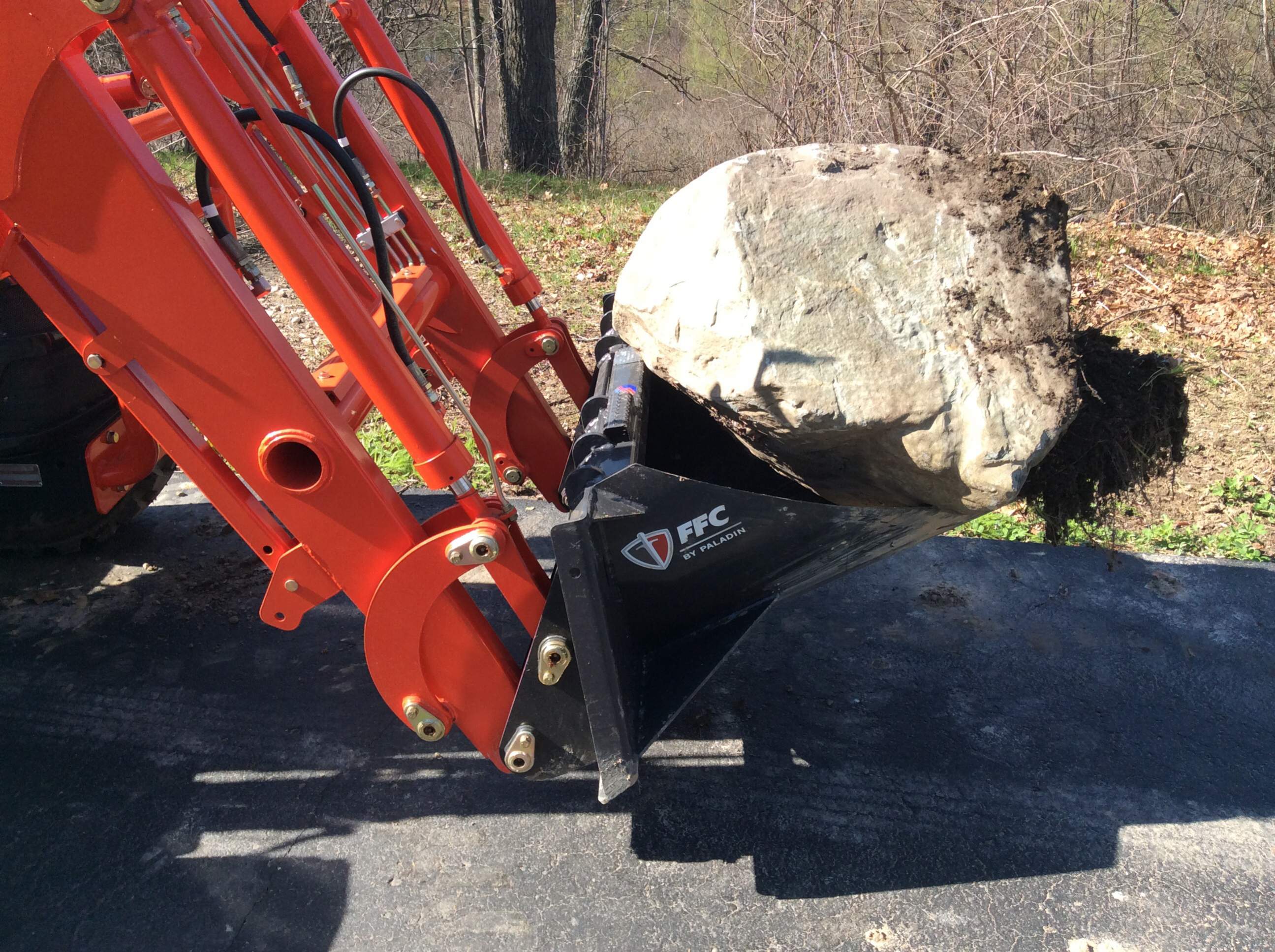

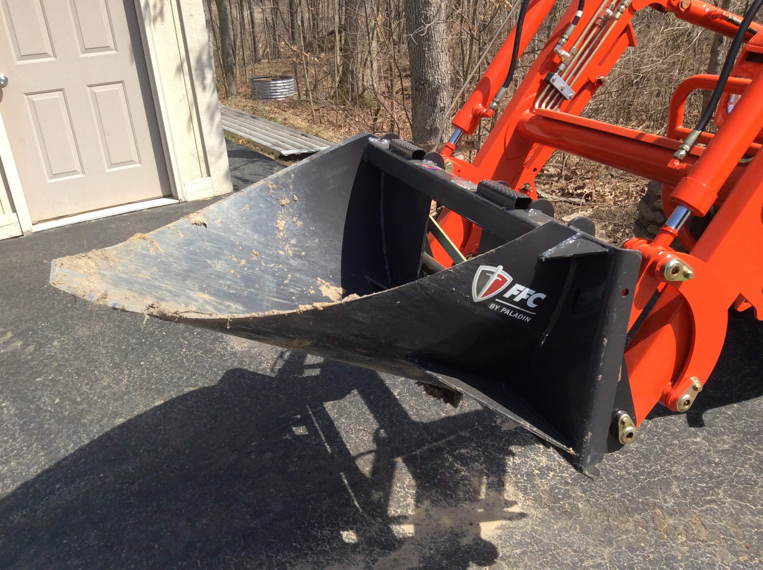

I need to remove a number of small seedling trees, mainly pine and sweetgum to clear trails. etc. I recently got a stumpbucket although I really haven't broken the code on using it yet. I've also seen videos and advertisements for something called a tree/post puller that looks impressive but is expen$ive. So, what is the collective experience/recommendations of the TBN group on removing small trees? Thanks.
