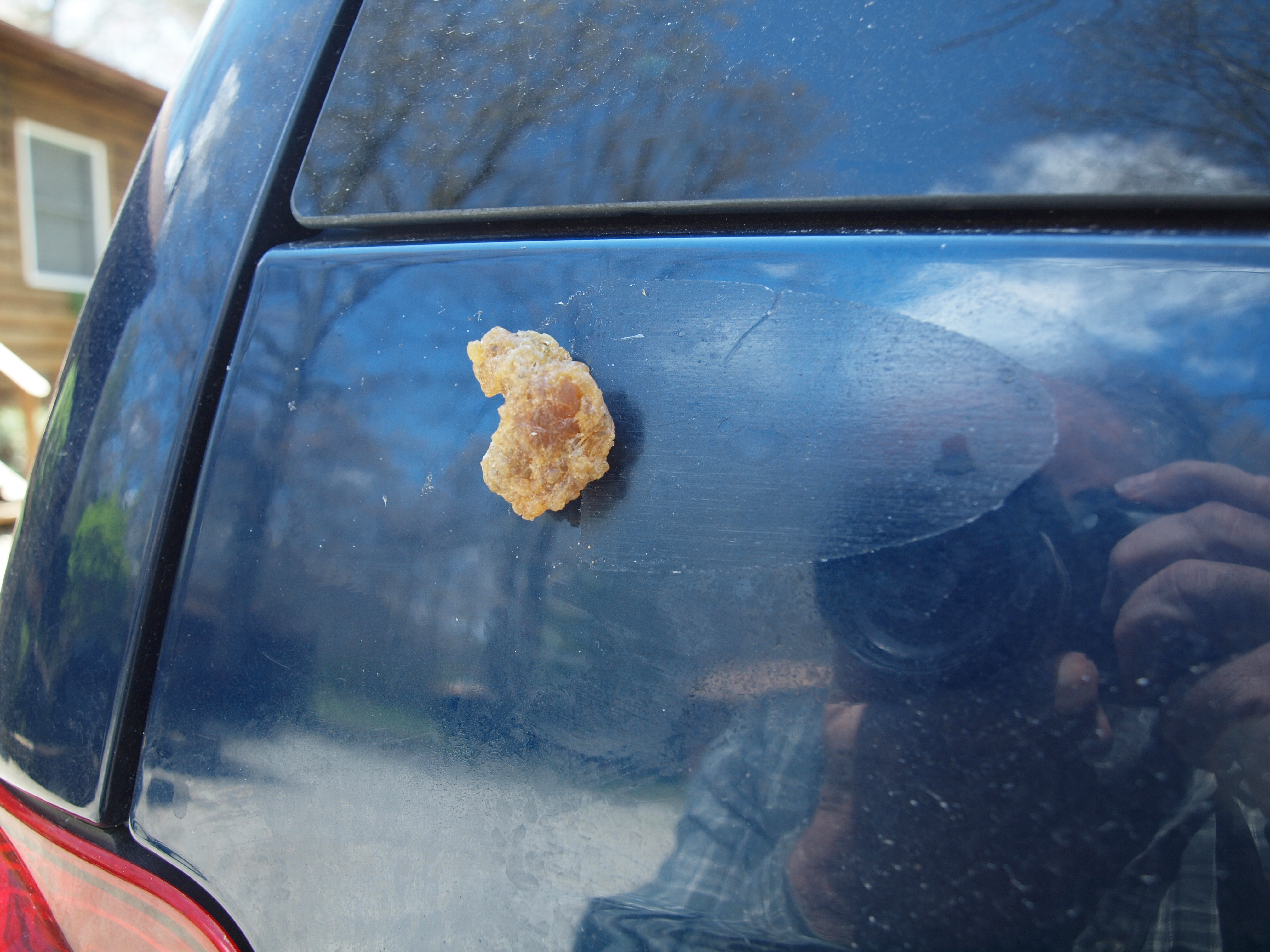

Pilgrim you can make your own "rubber" eraser by simply pouring out a glob of rubber cement on wax paper and let it dry and peel it off. They sell these at art stores as well but they are getting harder to find. Their primary use for this type of eraser was for drafting but the advent of the computer has made hand drafting kind of obsolete. What I like about this method is that no harsh chemical, powered eraser or plastic scraper touches the paint which avoids any accidental scratches. Here is a pic as I remove the sticky residue from a dealer sticker off of my Durango. Took 5 minutes. You can see the rubber cement blob sticking to the sticker residue. Soaked it lightly with WD40 first and went at it. Not a scratch.

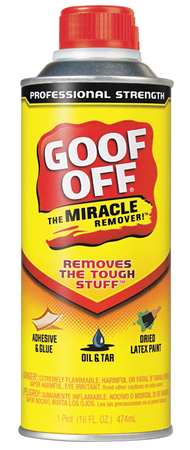

My input is similar to the above notes - Peel what you can with a plastic scraper, but don't try very hard, then place a dabs of some Goof Off on the remaining sticker residue, let it melt the remaining paper/adhesive for a few seconds and then wipe off with paper towel and you're done. Probably similar to the Goo-Gone noted above, but Goof Off is all I use for this sort of thing. Useful for car registration window stickers as well and also tar, paint, and anything the kids get on stuff they shouldn't. Home Depot has it as well... I am going to need to try the goo gone to see which works better.
Amazon.com: Goof Off FG653 Professional Strength Remover, Pourable 16-Ounce: Home Improvement
